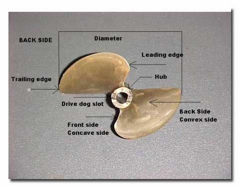

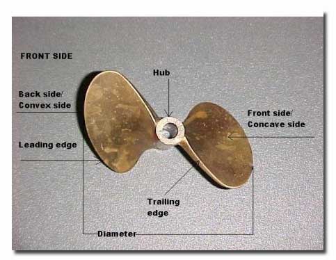

Note 2: during all the balancing and sharpening process we will be talking about the prop front side and back side, leading edge, trailing edge, etc.
To prevent any doubts about what are we talking, mainly because front side and back side is not a universal concept and adopted by everyone, the pics bellow try to fix those concepts, as adopted by us.
As we use here, front side is the side where the fixing nut screws on the shaft, back side is the drive dog side. This is an important understanding, as another papers may use just the opposite to name the sides – and both will be correct. But can’t be misunderstanding about the way and the side where to take material to balance the prop, be it named front or back.
