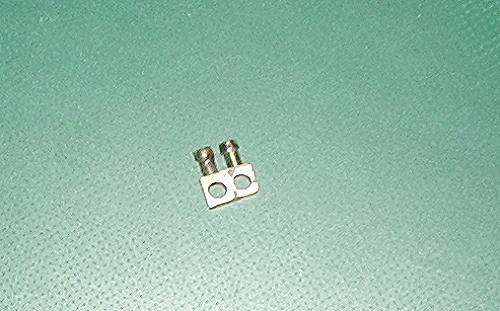

A quick step-by-step article on how to make your own clamp for securing the High and Low speed needles on your carburetor.
I had been pondering about a carb needle fixture for some time now, to stop the needles from re-adjusting themselves. Well, had an idea that I would like to share with everyone.
Step 1
Get a couple of bigger type cable connectors (match size to carb needle)
Step 2
Cut them open and remove the parts
Step 3
Clean them and grind them to size (if needed)
Step 4
Solder them together and clean them up
Step 5
Mount the item
