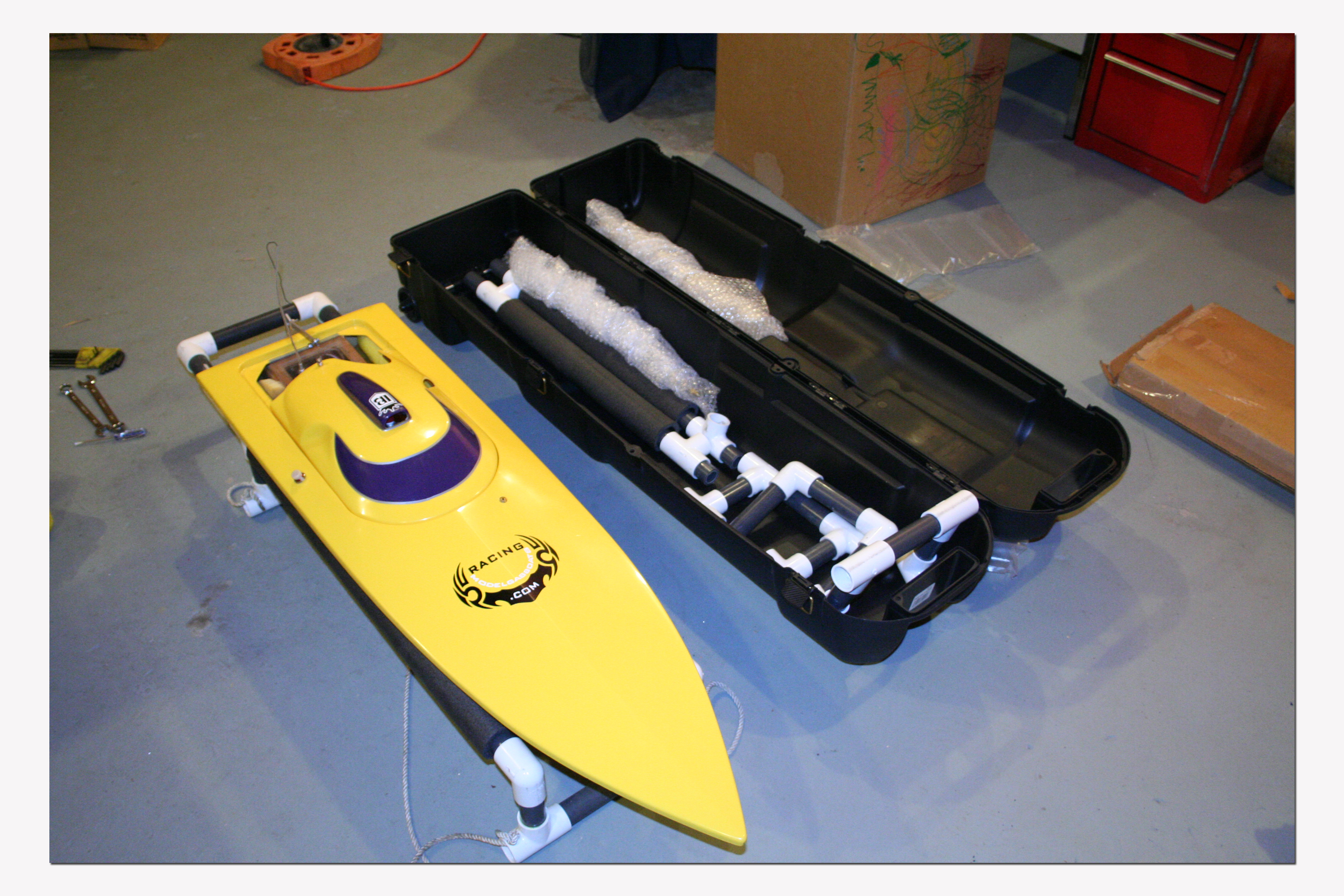

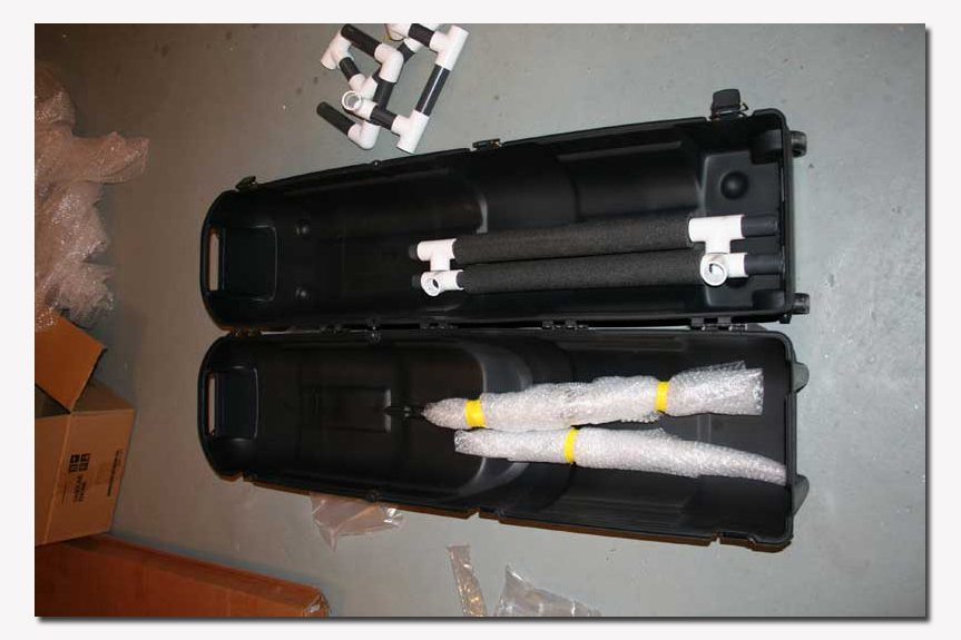

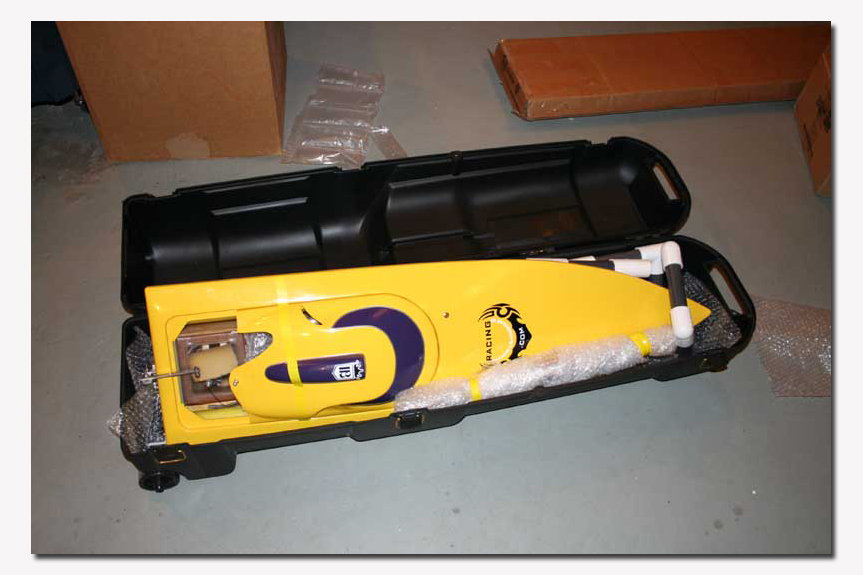

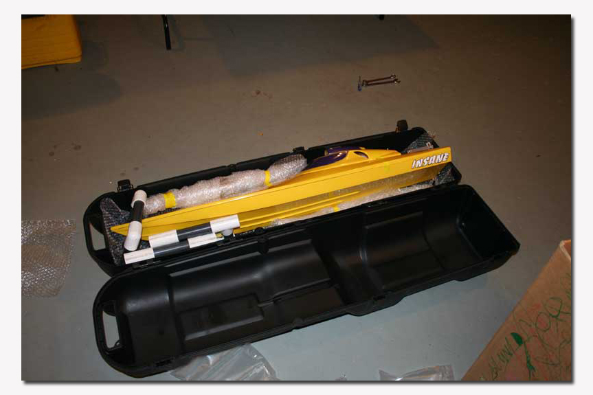

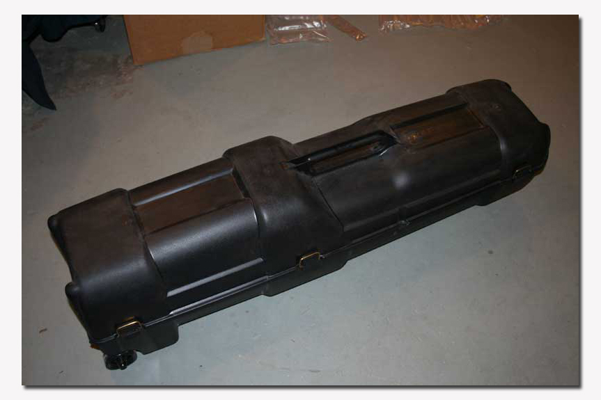

Below are a few examples of cases that can be used to take your boats on airplanes as check-in luggage. The first one is a hard shell golf club case. Most of these cases will accommodate a typical racing mono. The one pictured here is the case I use to carry along my mono and its PVC stand. In order for everything to fit in there I have to remove the transom hardware and the tuned pipe. I also have to disassemble the stand of course.

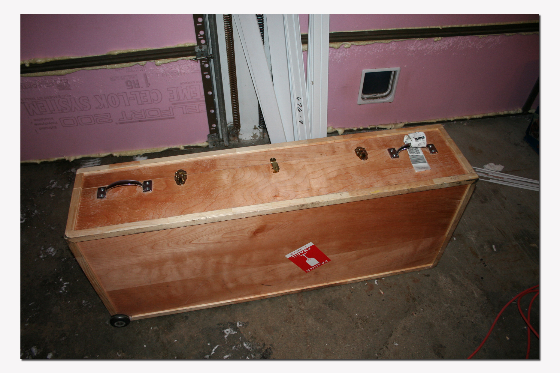

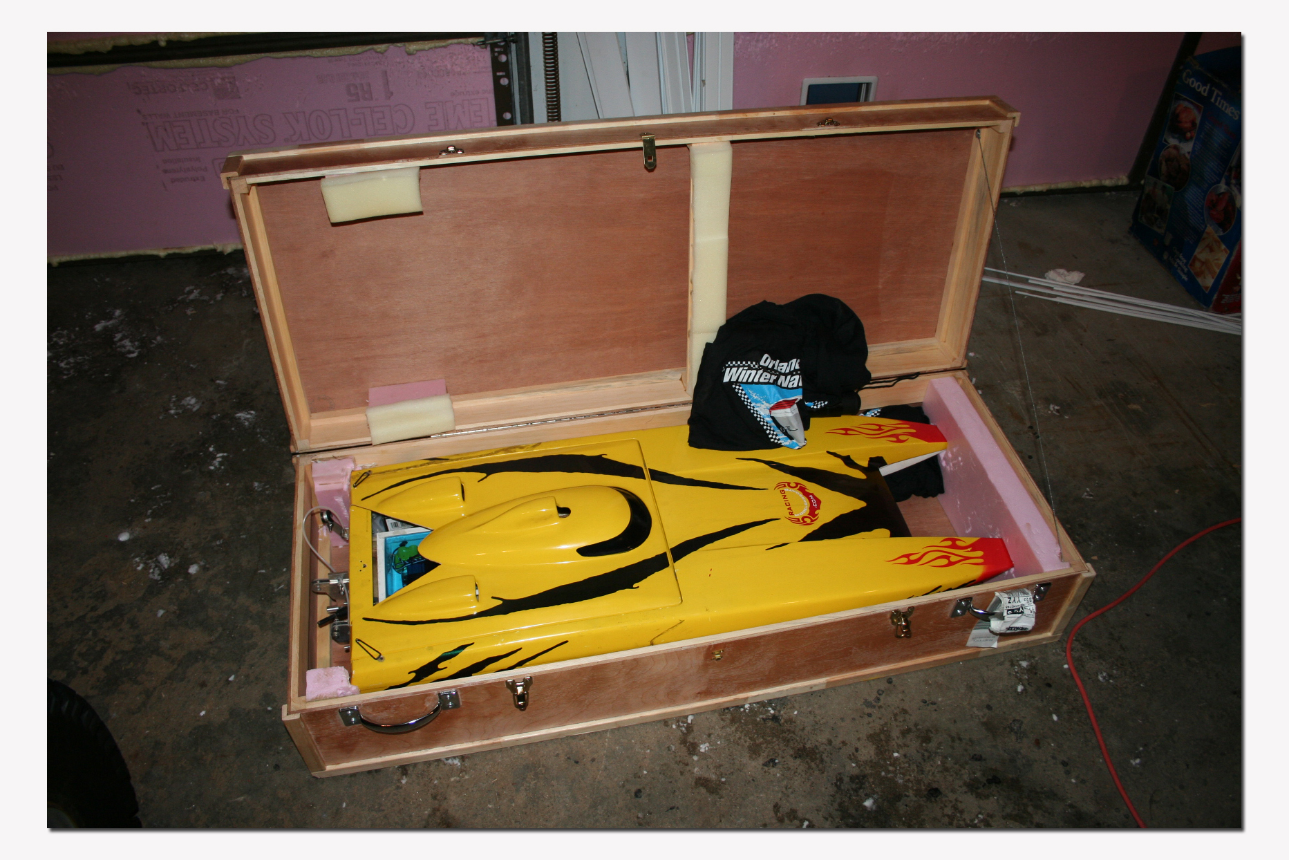

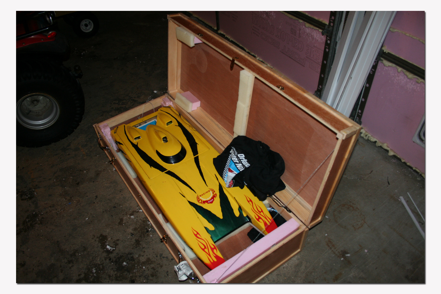

This second case is a custom made case my friend made to carry his cat and some accessories. When taking along a cat or hydro it’s harder to find off-the-shelf cases that will suffice. Some golf cases as the one above are made to accommodate two golf bags. These can in sometimes have enough room for a cat hull to fit in there. This homemade case was built of light ply and reinforced with pine corners. The inside was lined with foam that was cut for the hull to fit snuggly in the case. It was also fitted with roller blade wheels and carry handles.
