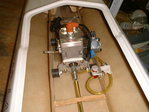

ImageMy first impressions of the new A.C. Model Boats Lazer 45 Mono Hull were laced with mixed emotions. I built this boat in record time, at least for me. I had around 12 hours in it total from start to finish. I got the hull on a Friday night and had it wet 2 days later on a Sunday afternoon. Working fast meant taking shortcuts. I usually build all my boats with a sealed Dubro Quick Charge with on/off switch mounted in the top of my radio box lid. I couldn't find the one I had when I completed the boat, so I put in a fully charged 1800 mAh, 5 cell Sanyo battery pack, plugged it into the receiver, added a Volt Watch battery meter, and taped the lid closed. I equipped the boat with a Quickdraw 25 that was prepared and assembled by M&D Designs with a 175 sleeve, and a Quickdraw pipe with ½ inch cut off the header. I notched the transom to fit the pipe lower in the hull. For hardware, I chose an M&D Drive, Speedmaster rudder, and trim tabs.
A Hitec MG645 servo for the rudder, Futaba 3003 for throttle, both controlled by a JR XR3 transmitter rounded out the radio gear. I used a 1000 mL I.V. bag as a fuel tank. The M&D drive and I.V. bag really helped reduce the assembly time!Image

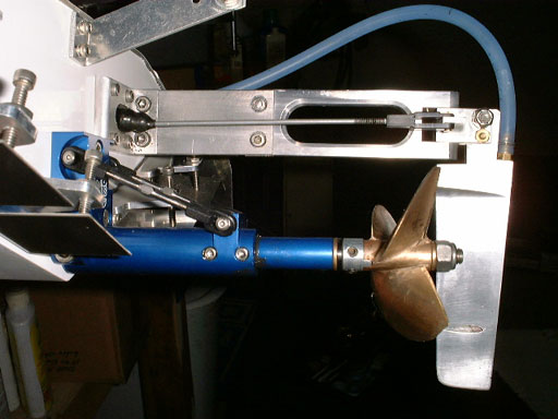

ImageI extended the rudder back 1-1/2 inches with a custom made extension (now sits 6 inches from leading edge of rudder to transom), lowered the M&D drive from 1/2 to 7/16 of an inch from the hull bottom, and I was off to my first race of the season at the North Coast Pond Hoppers. I am by no means a good driver and I will be the first to admit it. I was running a 470 3-blade prop that I had prepared, and knew it was a 56-57 mph prop that seemed to be a great heat race prop when I had tested it. I wasn't looking to be the fastest boat in Open class that day, as I just wanted to be competitive and finish heats. I did manage to nail a few starts, but the best thing I felt was how very comfortable it is driving this boat, as it seemed to go wherever I pointed it. If I screwed up, I could simply aim it in the right direction and it went there with ease and the boat didn't care one bit. I was actually running the buoys that day without even trying, and it was all due to the way the boat was handling and the way it boosted my confidence level driving it. I had my first "Perfect Day" ever in Open Class; all firsts in all heats! A major feat for me anyway!
