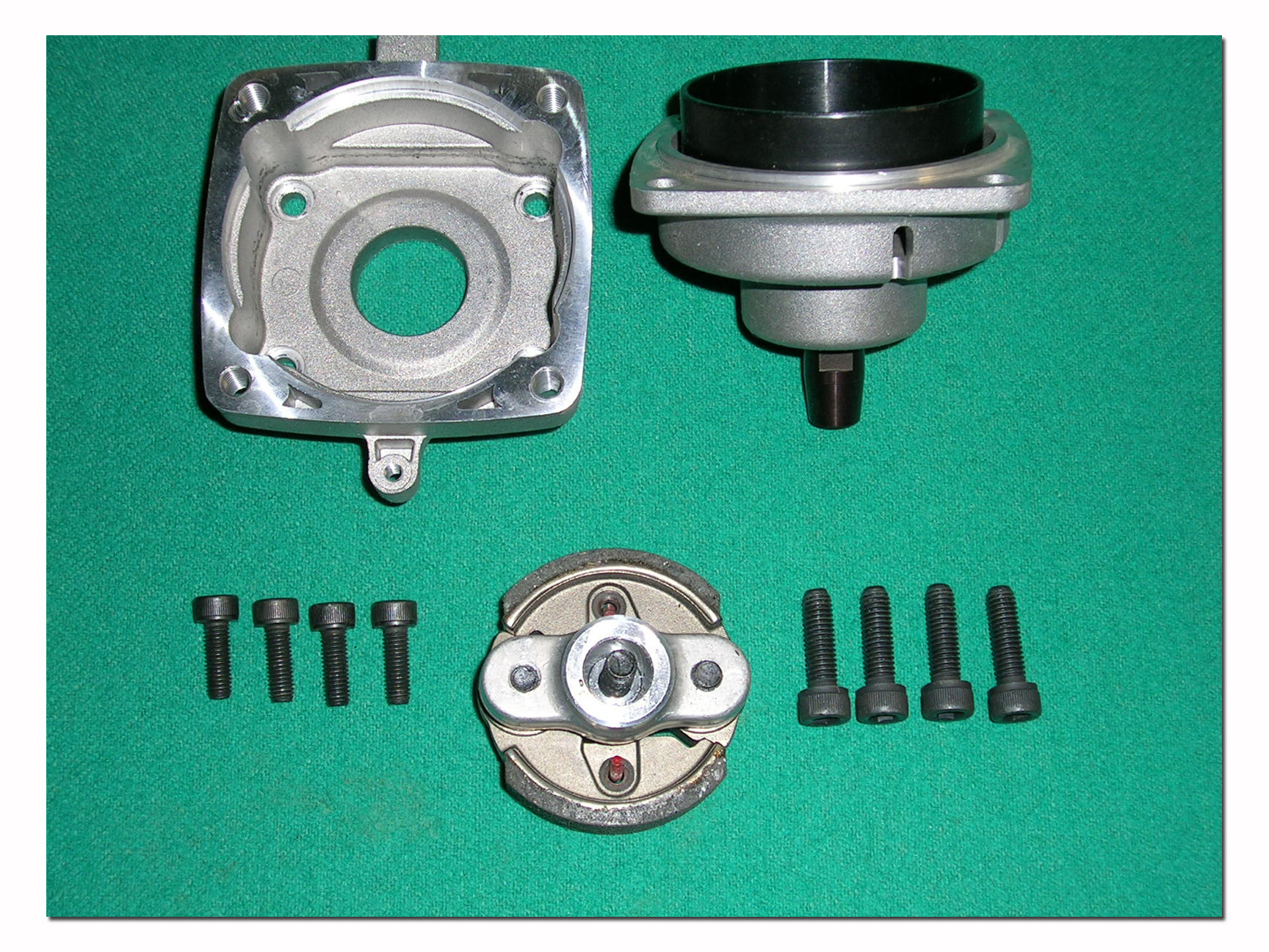

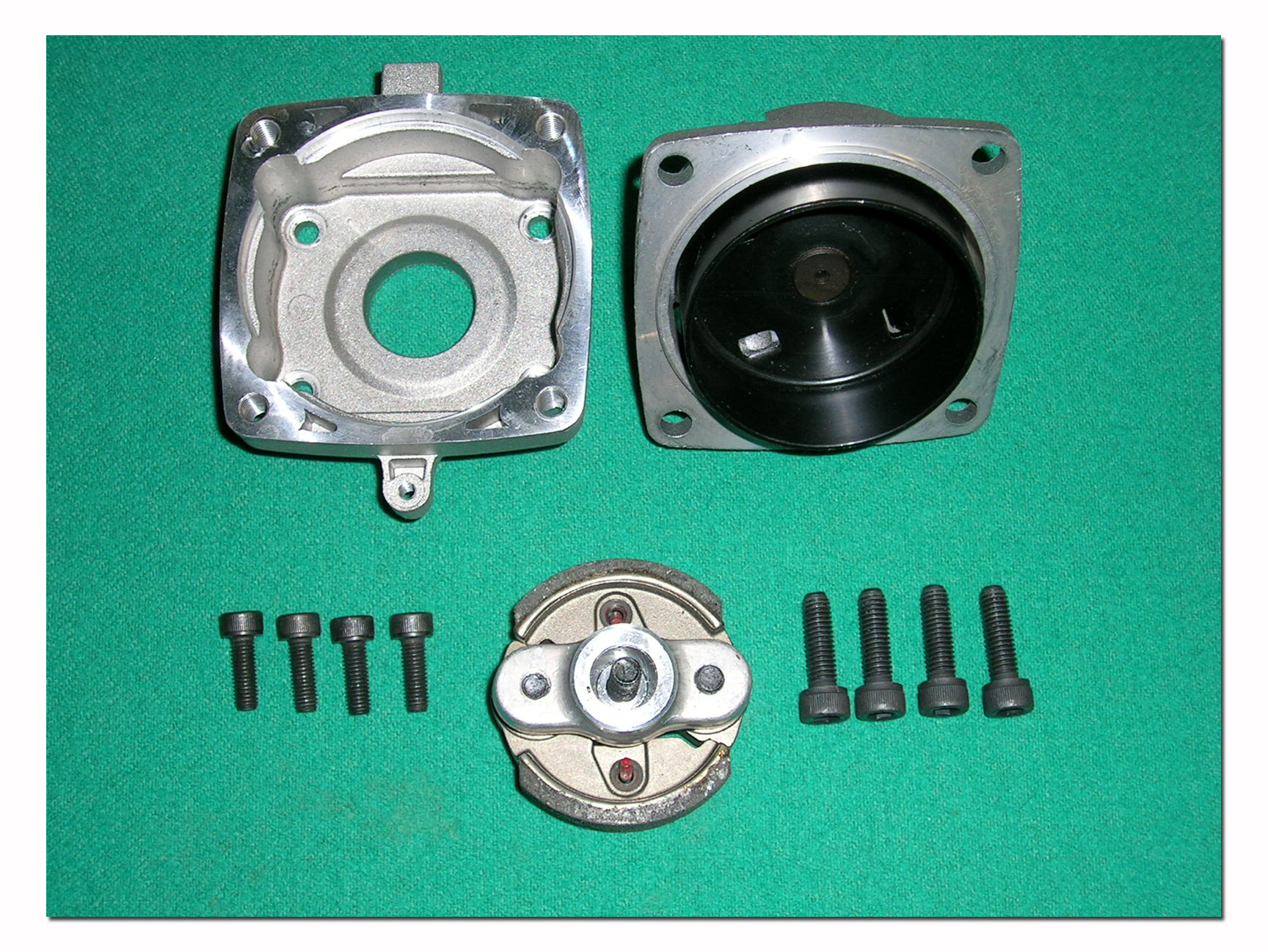

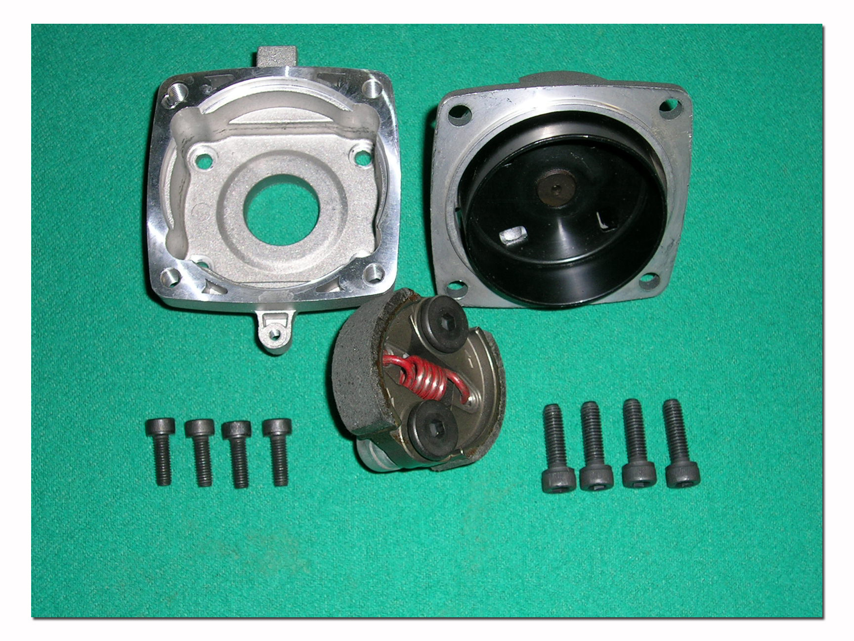

Here are some pictures of the clutch.

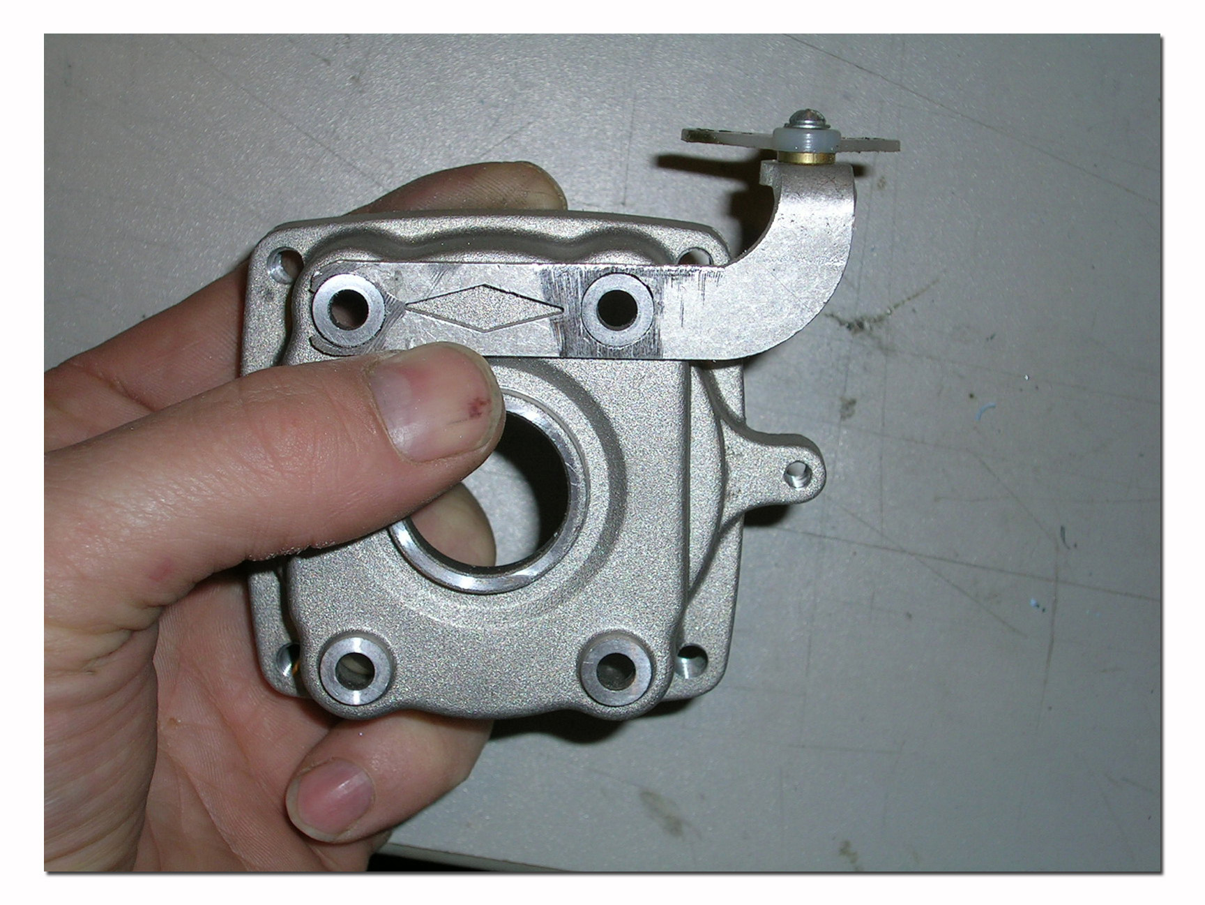

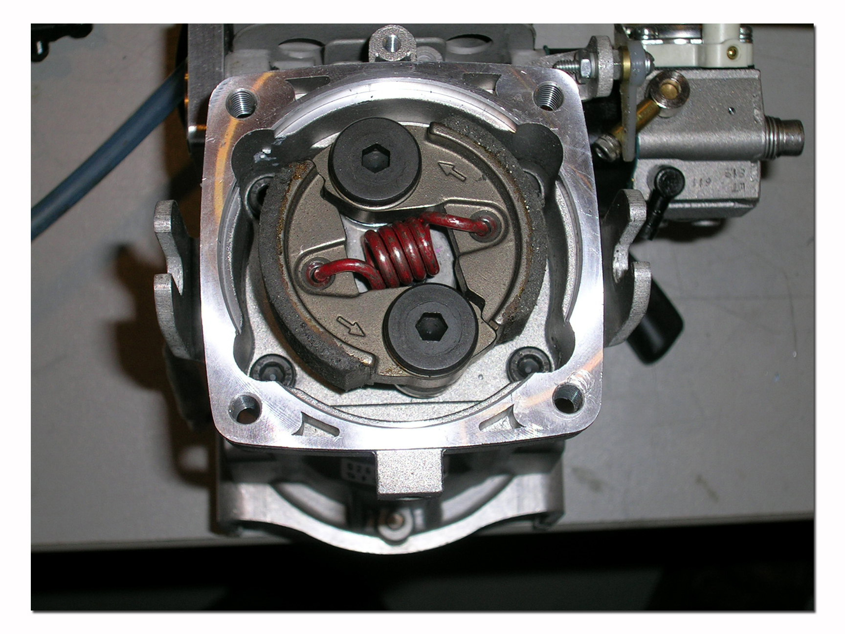

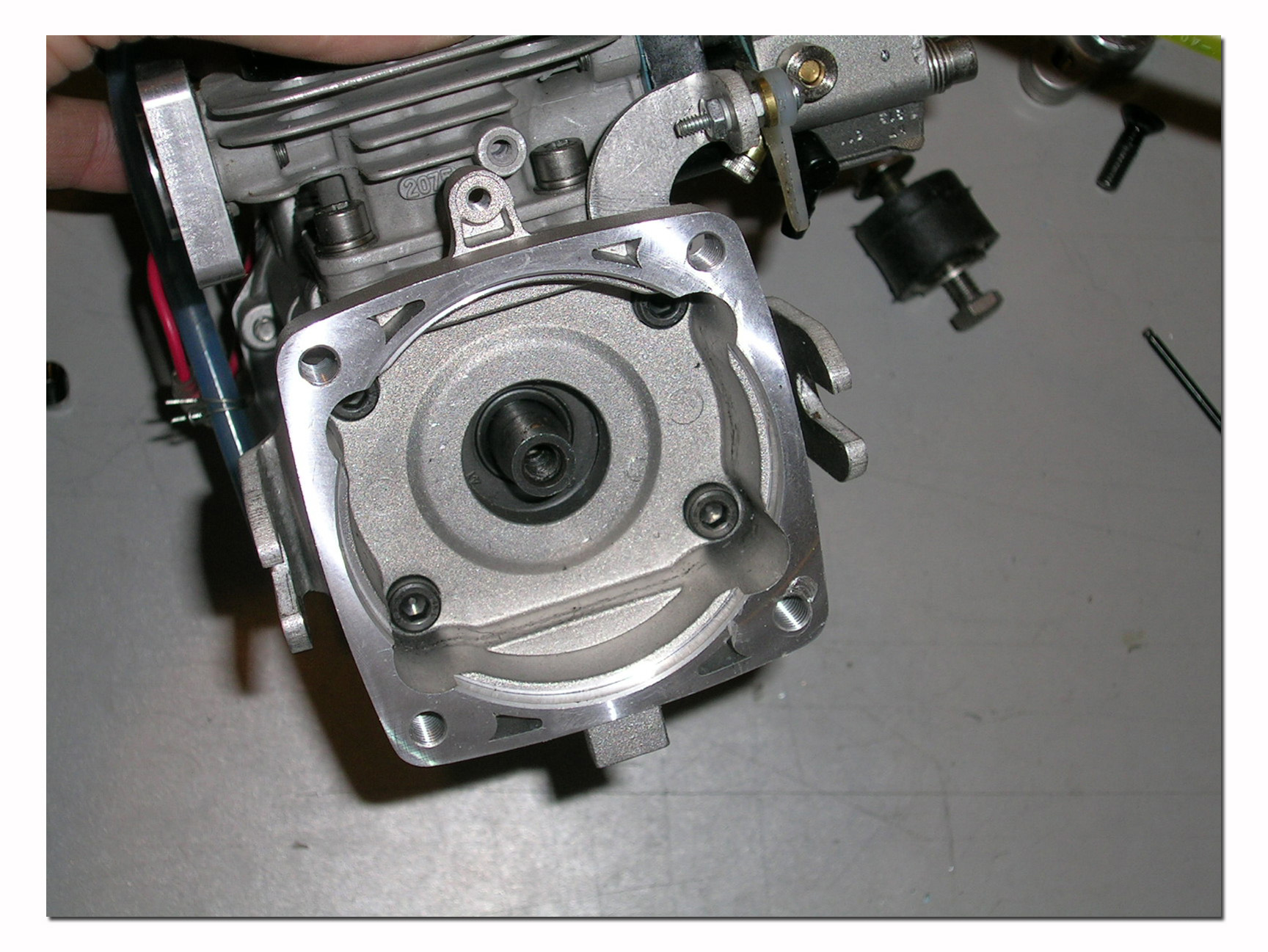

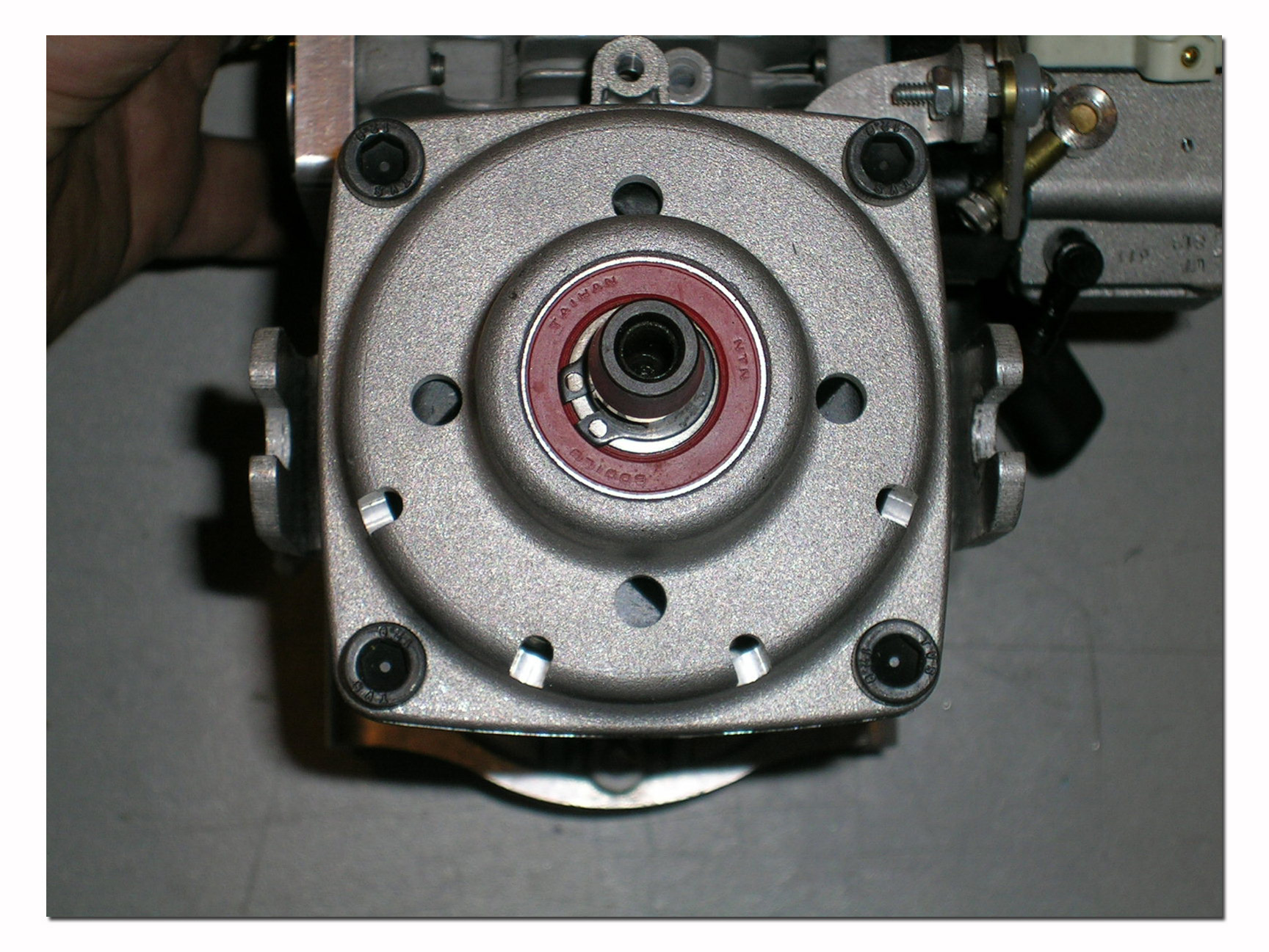

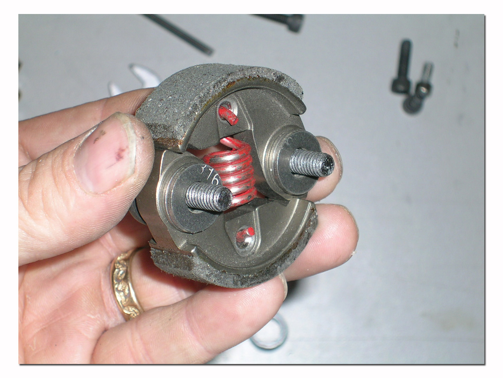

To get the clutch to work with the mounts I had to enlarge the throttle linkage bracket’s mounting holes so that the mounting stubs in the clutch casting would fit through the bracket. There wasn't much material left after enlarging the holes, but with the bracket sandwiched between the clutch and engine it holds just fine. To make up for the thickness of the mount itself (between the clutch and the engine) I doubled up the spacer washers behind the clutch shoe support. (see pictures). The clutch casing mounts directly to the engine and the shoe support mounts to the tapered output shaft of the engine using the supplied 5mm screw. This installation is quite easy. {sidebar id=13}

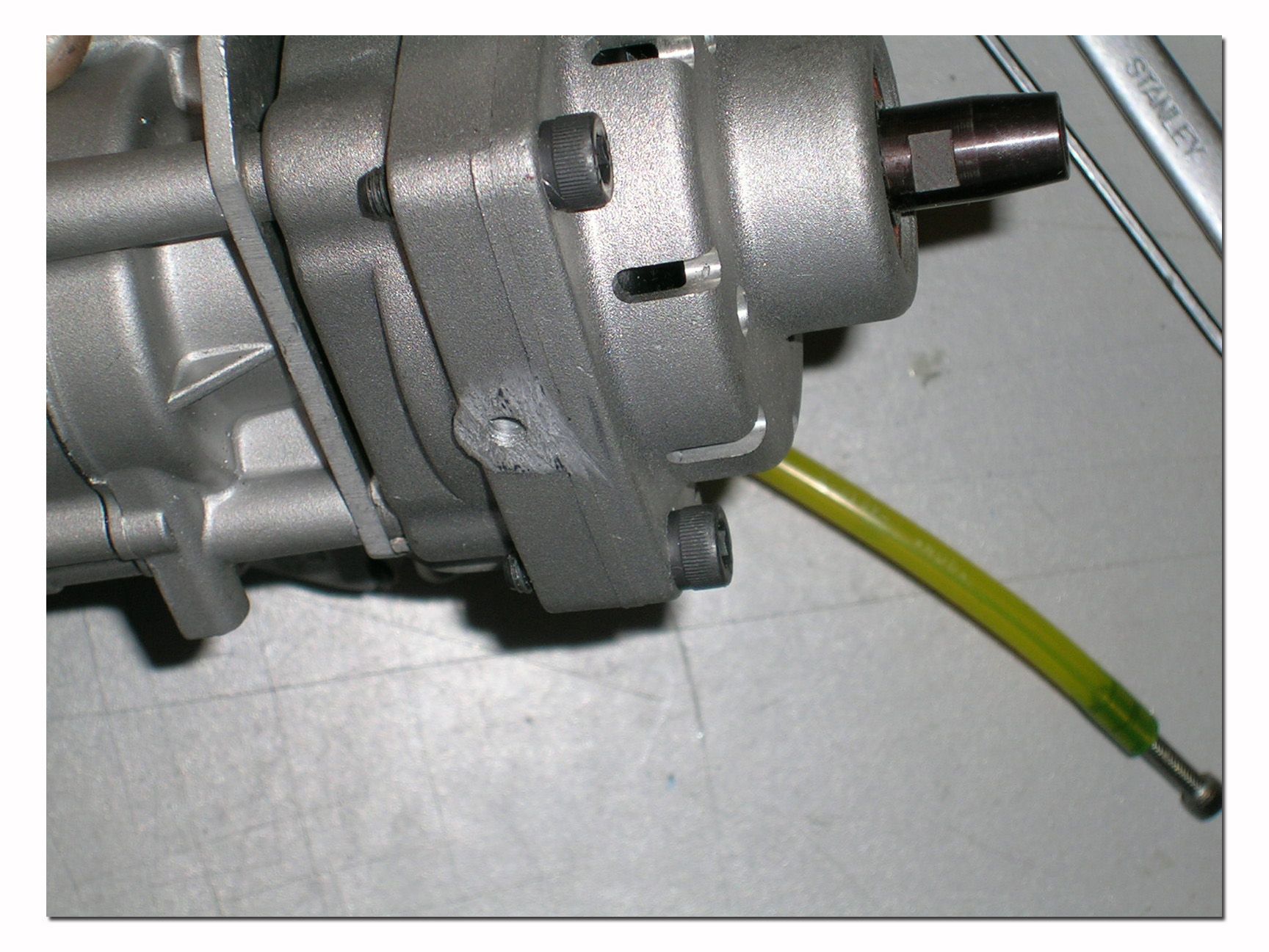

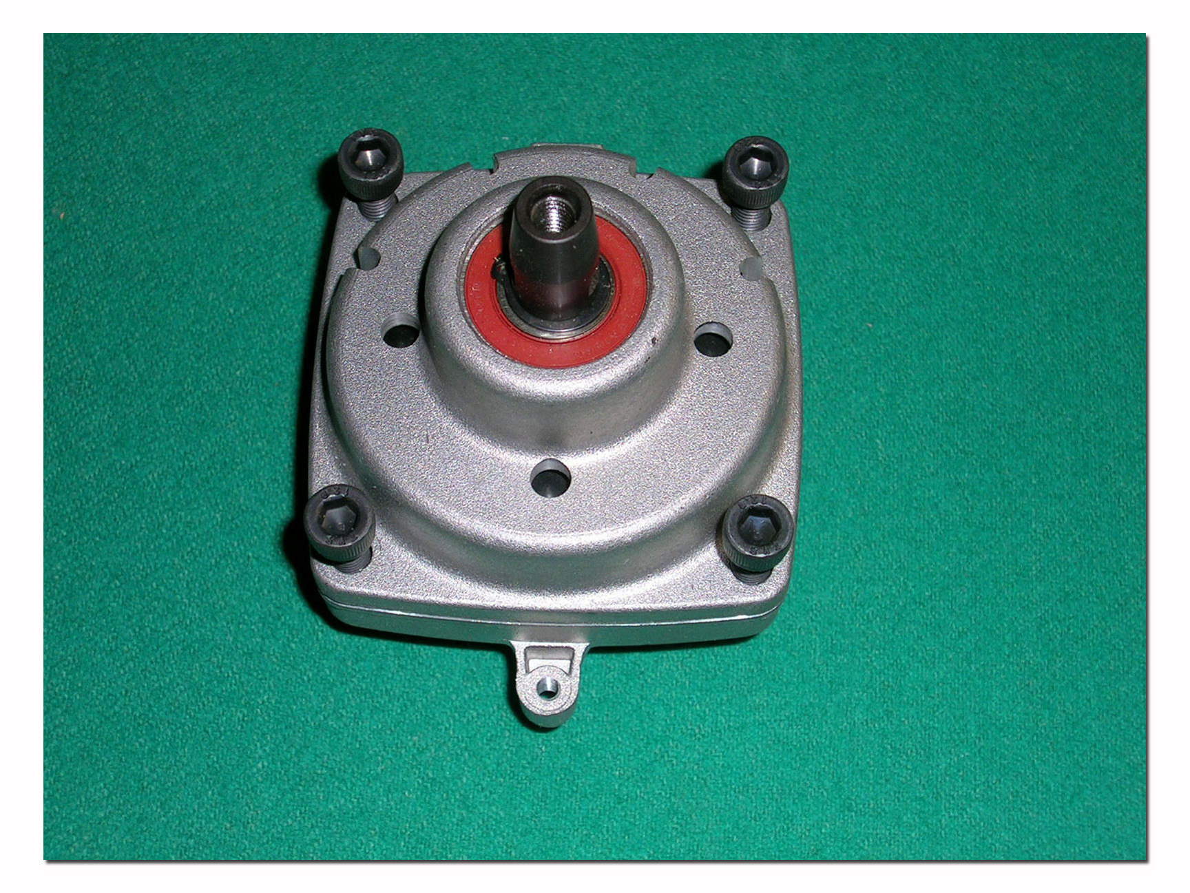

Finally, in order to get the clutch and engine as low as possible in the hull I cut off the stub on the bottom of the clutch housing. This is most likely used as a mount in other applications, but was preventing the clutch from laying low in the hull.

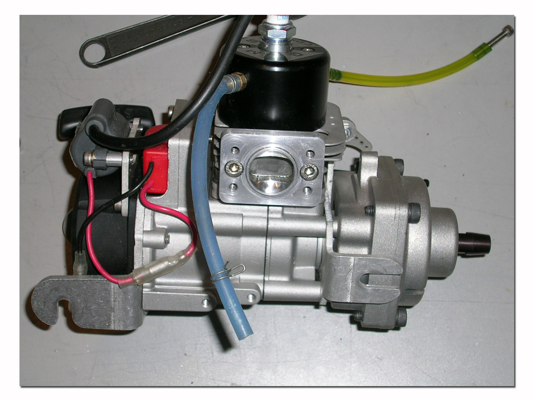

As you can see, it was pretty simple to get this clutch to fit with the Insane/CC Racing (Hypertorque style) mounts! The output shaft of the clutch is identical to the tapered output shaft of the engine so you can simply bolt on your favorite square or collet drive! {sidebar id=12}
NOTE: there isn't much space between the mounts and the clutch to get a wrench in for tightening the bolts but it is possible with a thin wrench.
