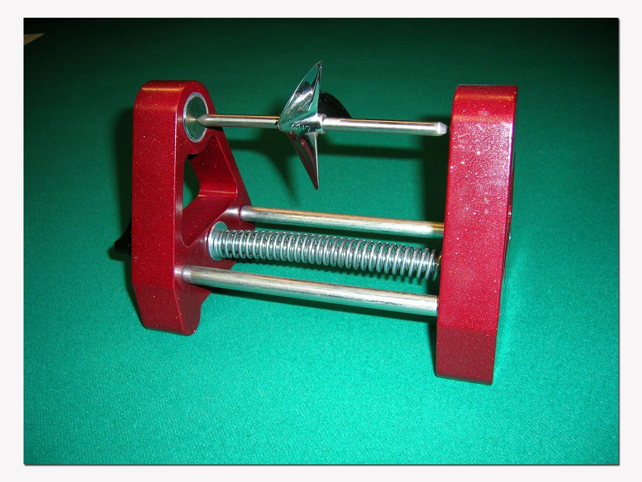

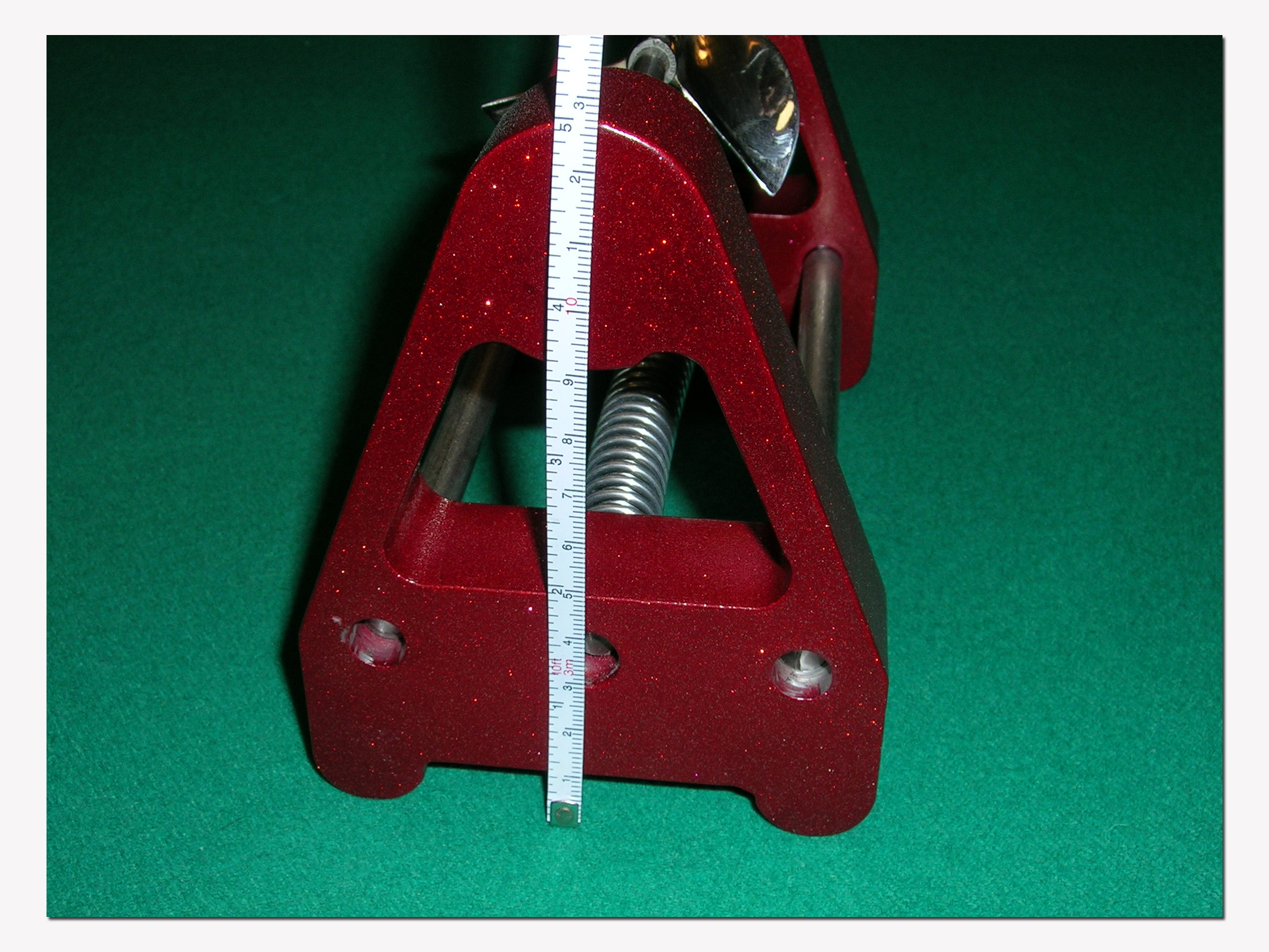

The unit is made of aluminum and has a powder coat finish. It is approximately 7 1/4” long, 4” deep and 5” high overall. It is a fairly large balancer that will accommodate just about any R/C boat propeller. From my measurements it would accept propellers up to about 4.5” in diameter and the magnets would be strong enough to hold them too!

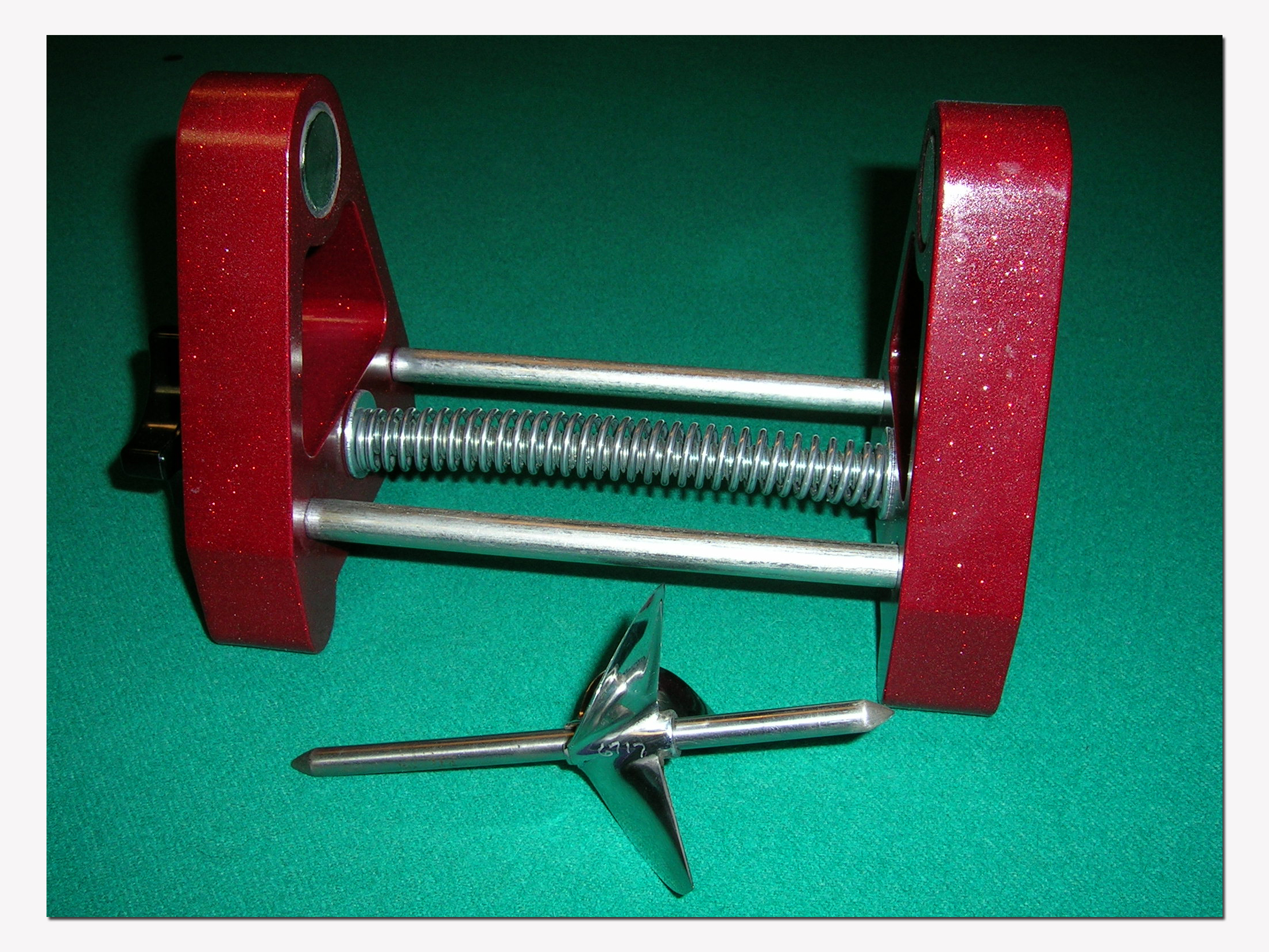

This balancer relies on 7/8” diameter rare earth magnets to support the prop shaft. These are very strong magnets! The prop shaft is made of steel. It is ¼” diameter so that most gas boat propellers will simply slide on. The shaft is then mounted between the magnets which will hold it suspended. On one side there is a black knob that is used to adjust the spacing between the magnets. To reduce friction on the prop shaft and have more precise balancing of the prop, you increase the magnet spacing just about as far as you can while maintaining the prop and shaft suspended. At this point only one end of the prop shaft will be touching a magnet and the other end suspended in mid air!
* If you want to balance 3/16” bore propellers all you need is a 3/16” shaft. You can inquire with GASRC for this or have one made at a local machine shop. Most gas boats use ¼” bore props however.
