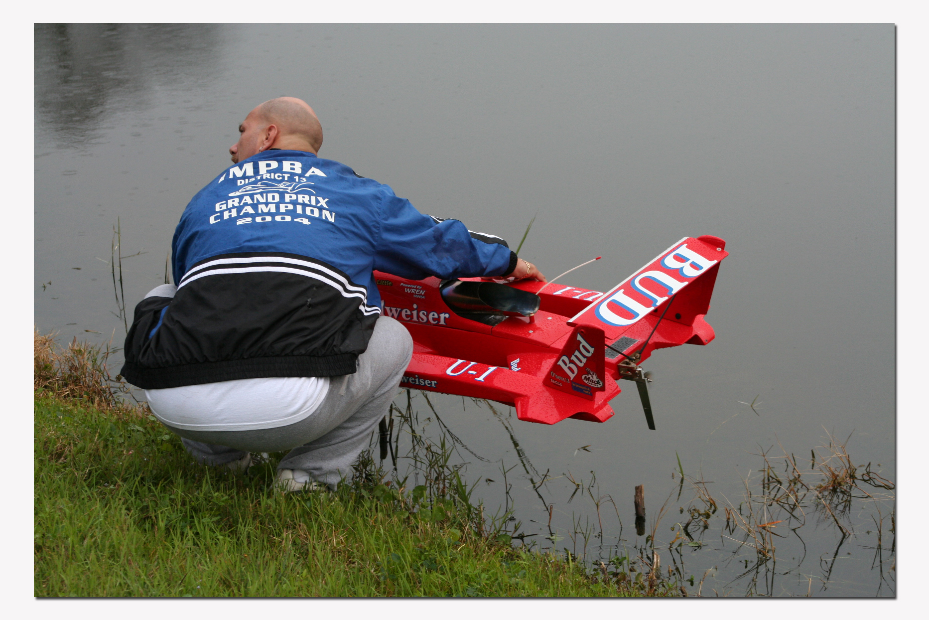

On the day prior to the races a few of us set out to another local pond to actually see Peter’s Miss Budweiser run. It truly was a sight to be seen and heard! Peter explained the security features of the turbine engine as he got it started. The boat was launched and we all stood in awe! Here are some pictures.
