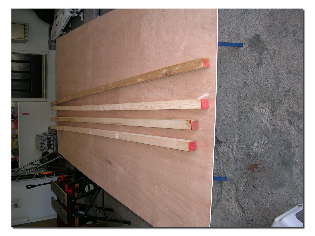

This is the sheet of plywood and pieces of 2"x2" spruce used.

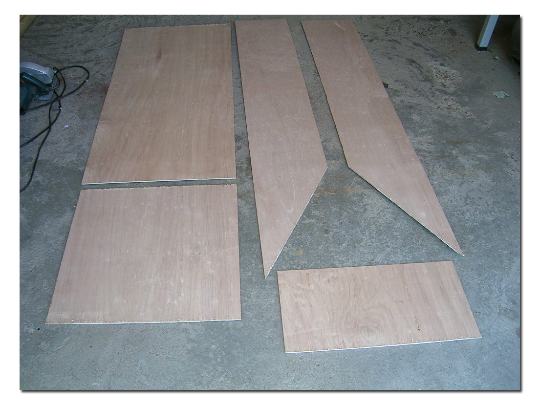

Here are all the pieces cut from the plywood sheet.

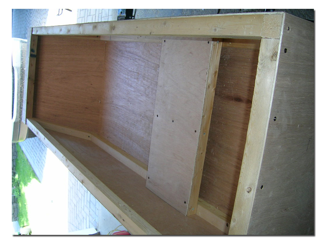

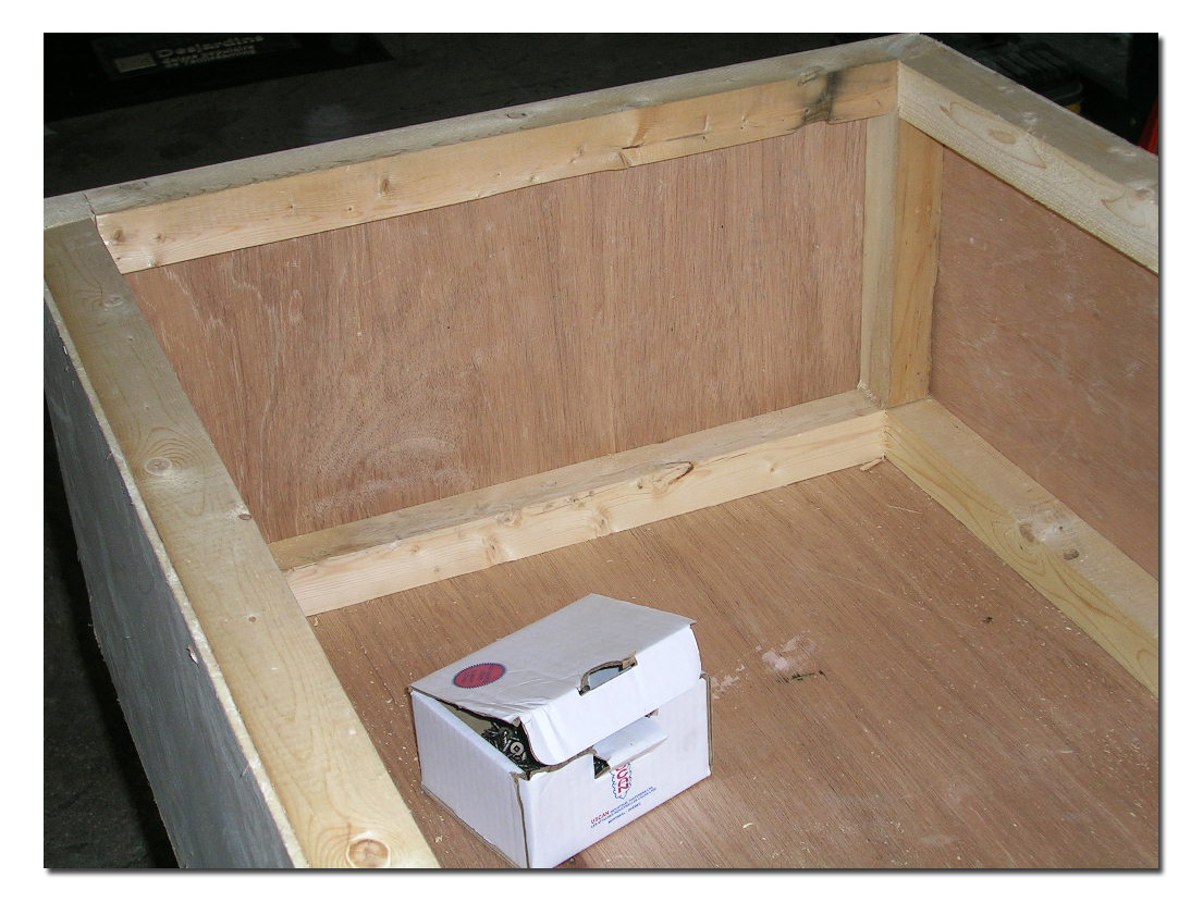

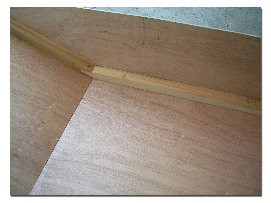

The assembly is quite easy. Simply cut the 2"x2" to match the lengths of the pieces cut from the plywood and assemble using 1" wood screws. Where the 2"x2" meet in corners I used 3" screws to hold them together, screwing through the plywood.
I made a sliding seat in the bottom. It freely slides on the bottom frame of the boat so you can adjust it to be comfortable. It also prevents you from sitting in water as some always makes its way into the boat when retrieving a dead boat.

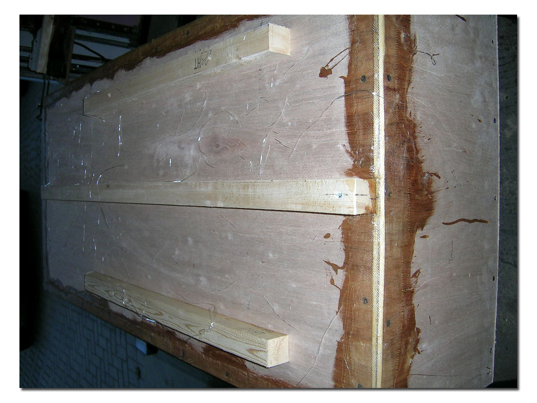

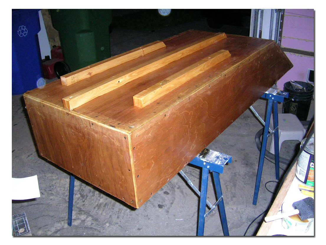

In order to get the boat to track better I installed 3 strakes made of 2"x2". Our first retriever did not have this in the beginning and it was very hard to go straight with it. This one is still a little tricky because of its short length but the strakes do help.
I then proceeded to glass all the seas of the boat from the outside using 3" wide strips of mat and polyester resin. Once this was all dry I sealed the remainder of the boat with spar varnish.

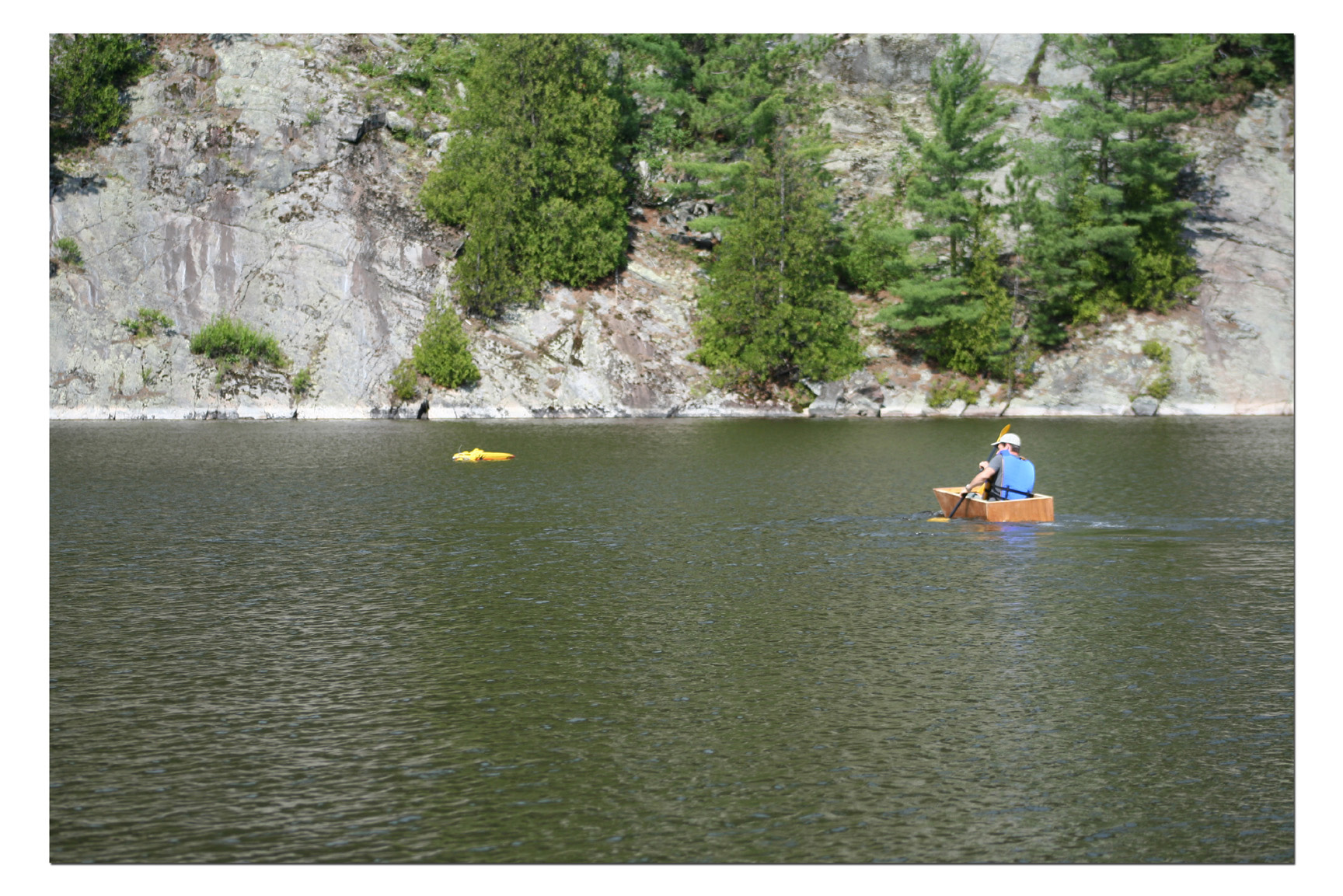

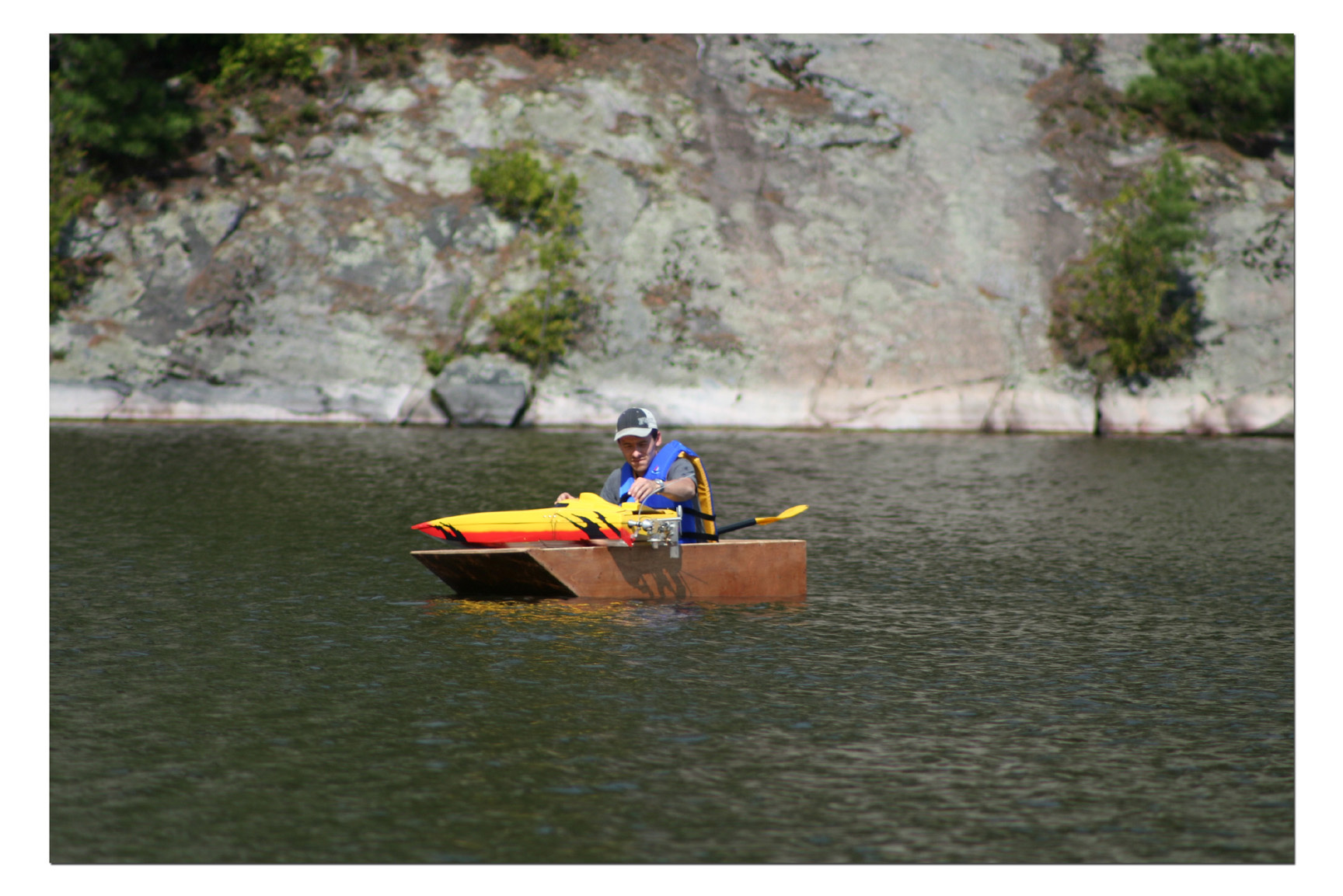

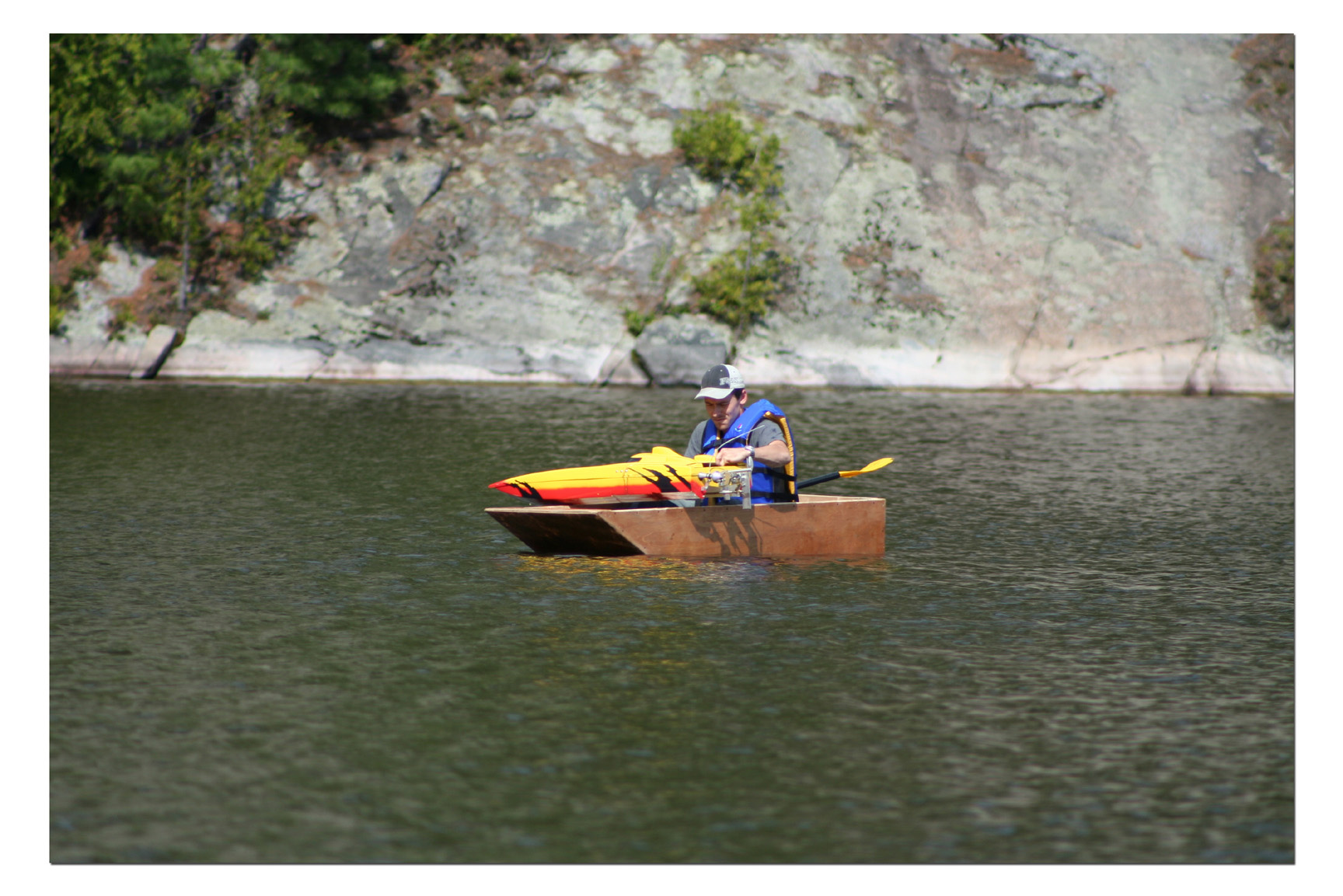

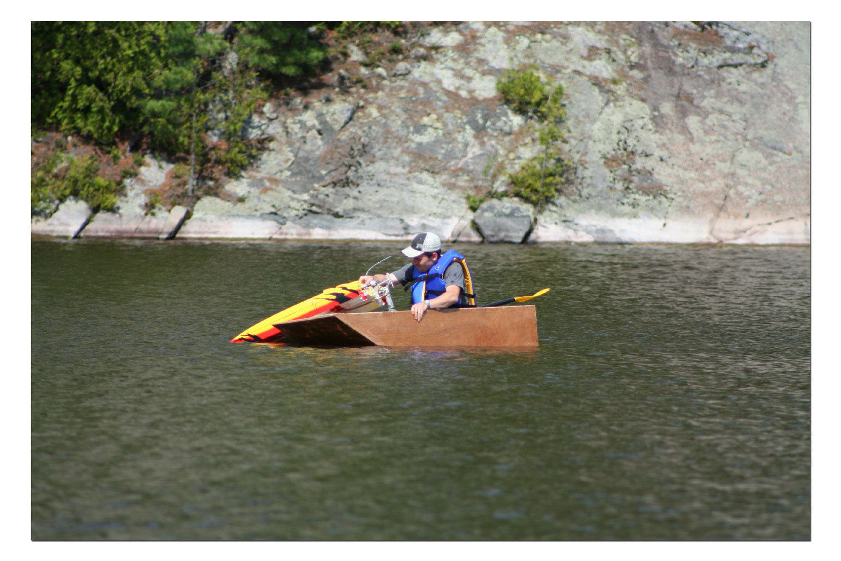

Here are a few pictures of my friend retrieving his boat at the lake using our newly built retriever. He thought it was a little too tippy for comfort so we are considering making an easy to install and remove side stabilizer to the boat. If we decide to do this I will do a follow-up article. Personally I think it works just fine as is, but more stability can't be bad!
