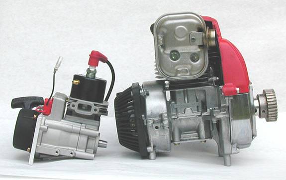

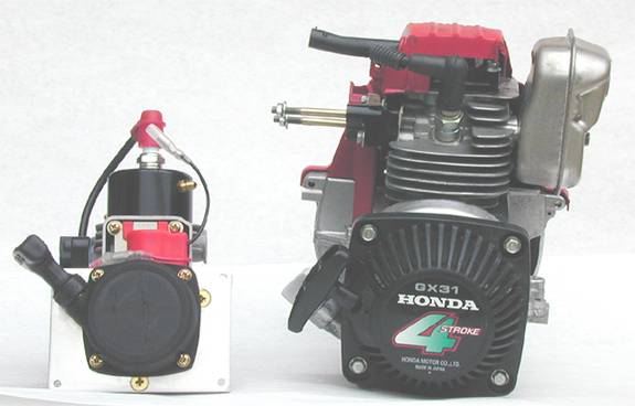

Here is a comparison to a Zenoah PUM motor. It appears to be quite large, but most of the bulk is shrouding and stylistic parts. It is not much larger than a full dress Homelite 30cc. It has a wider footprint than anything else that's been put in a boat due to the oil tank.
