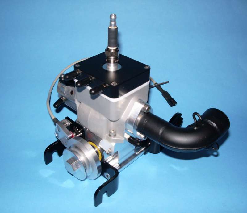

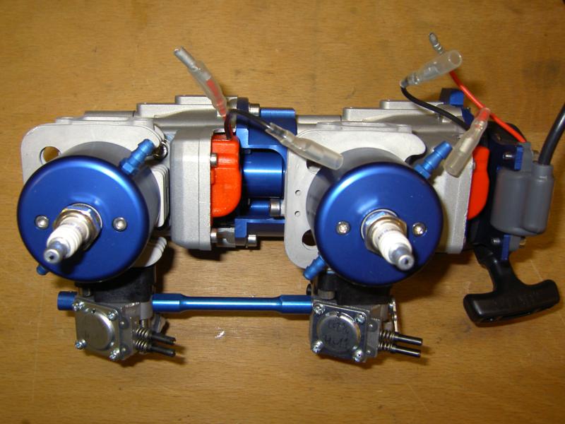

Most conventional 2-cylinder-engines based on the ZENOAH, CHUNG-YANG, RCMK occupy a considerable amount of space because of their width or height. This is mainly due to the two red primary ignition coils or other ignition coils. The final width or height depends on how the coils are arranged. On all “real” 2-cylinder engines the coils are typically installed on the sides, either diagonally or horizontally. 2-cylinder engines “MOUSE HOUSE” with original ZENOAH-CDI magnet ignition
For example: a 2-cylinder engine MOUSE HOUSE with a standard ZENOAH CDI magnetic ignition. One exception is the “Heilbronner-Bub” (this engine I do not consider as a 2-cylinder since it is a coupled engine… without putting its usefulness into question), this engine is built both narrower and longer.
The “Heilbronner Bub” is built both narrower and longer than “MOUSE HOUSE”The width of the 2-cylinder engines (and also our 3- and 4 cylinder engines) often makes the installation of cats impossible, as there is often not enough space in the skids. And even in monos there is less space left when two engines are arranged side-by-side. A superior solution is needed and this better solution is the “electronic ignition”.

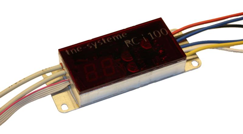

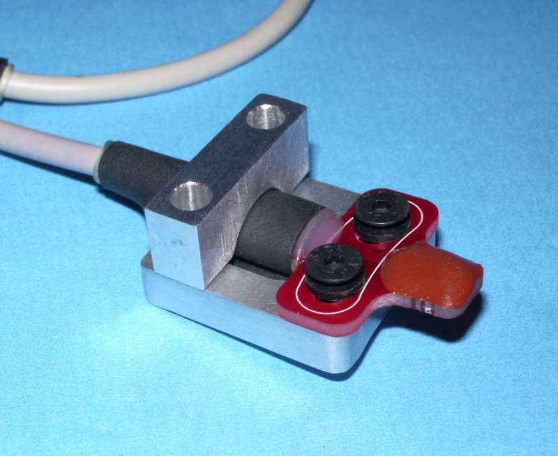

Igniton system …sensor  (concept phase)
In the case of this project I was able to convince experienced electrical engineers from the automotive industry, who were willing to develop an ignition system to a typical automotive standard. This expert group is organized under the name “tne-systeme UG limited” and has the capability to produce the advanced ignition system in volume.

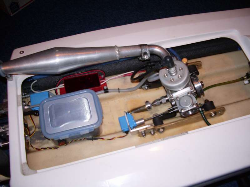

Installation of concept phase in NoMercy with 260 ZENOAH engineFirstly, there is the book of requirements that contains the specifications and functionality of the ignition system. The following features are within the task list:

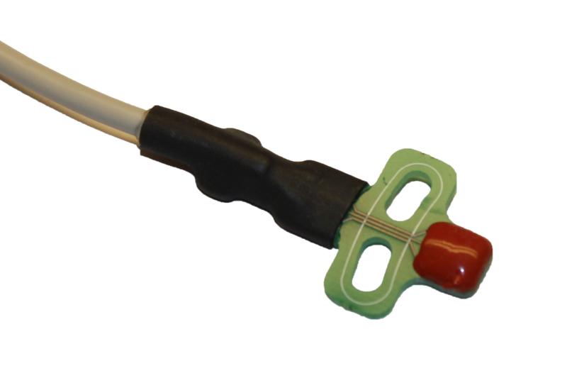

  • small sensor with magnet control (see installation width)

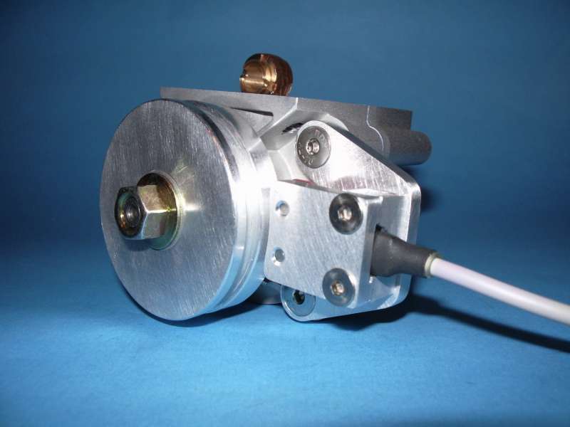

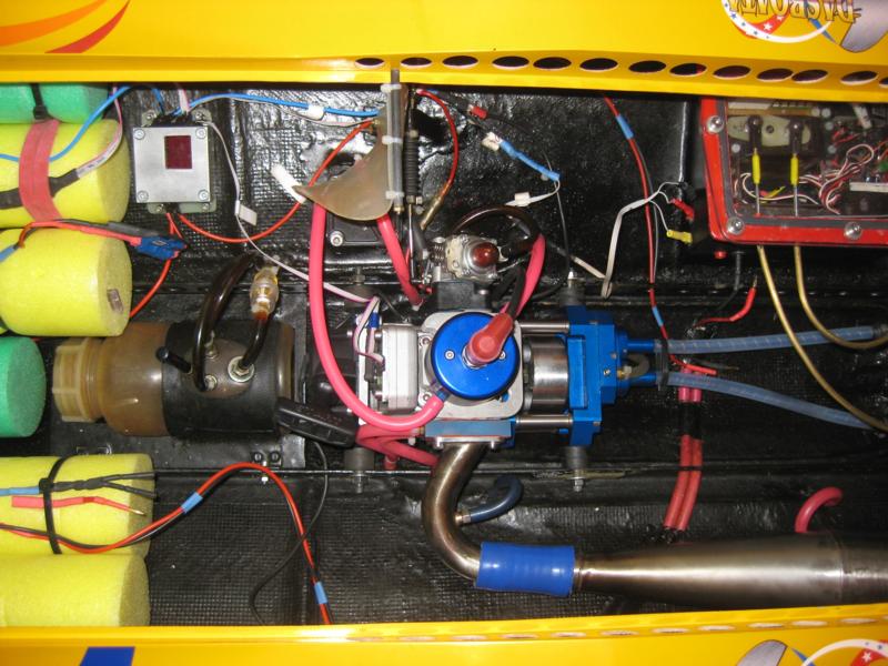

Daniel "Seewolf" inflates the boatThe ignition system and speed sensor are installed in my NoMercy with a 260 ZENOAH engine (slightly tuned up from RS). The housing is sourced from an electronic distributor, the circuit board is produced in the laboratory, the sensor is already one construction stage ahead (AP).
Here we tested the basic functions, usually in dry conditions with a running engine. The first endurance tests were performed on an engine test rig. The tests were performed on water, supported by our saving boater Daniel “Seewolf”.

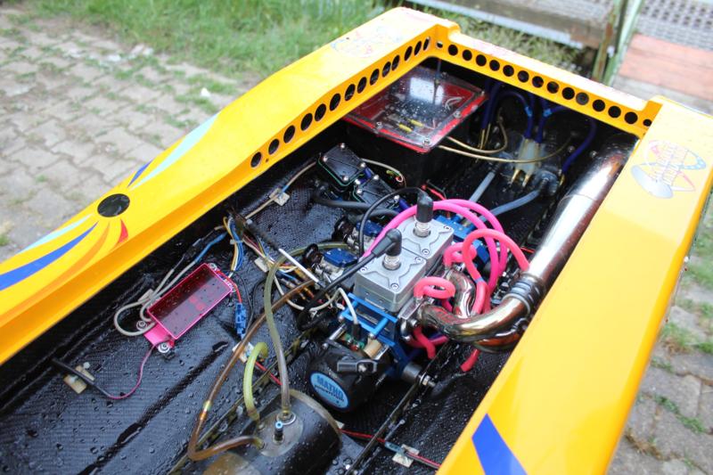

NoMercy with BEE HOUSE engine and POWER SPARK ignition system
However, we always had dropouts after 50 m. Until we finally established the cause i.e. from an old FUTABA 1024PCM. This proved that the ignition stops the engine reliably, as soon as no reliable receiver signal is detected or disrupted. After the conversion of the system to 2.4 GHz with CORONA- components everything worked properly and reliably. Later we realized that the 40 MHz-module is suffering from old age, according to a web-blog, I was not the only person with a similar problem.

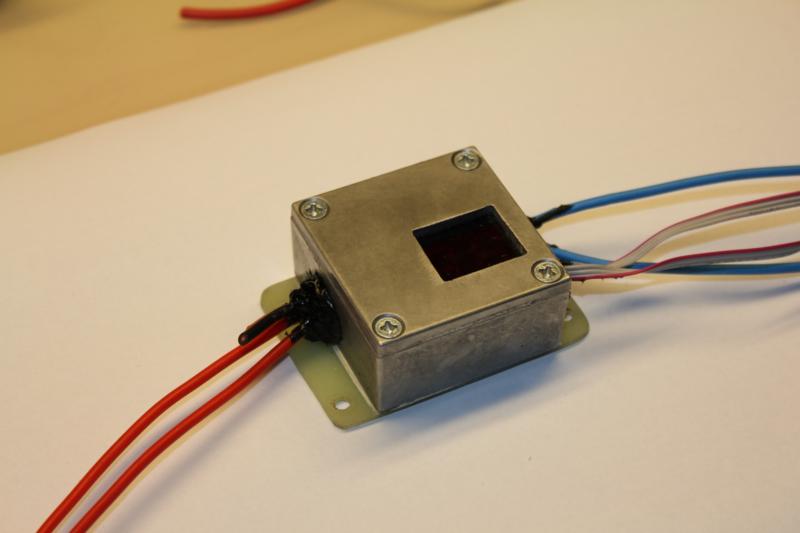

The housing was assembled from aluminum profiles. However, the circuit board is already produced in series quality. In this phase we fixed the 10 prior programmed ignition maps and wrote the 54-page manual that describes all functions in detail. The various safety shutdown functions were tested under practical conditions and thus validated.
Furthermore, the software was developed in the application phase. For example: How should the RC-supervision be implemented in detail (parameter)? How does the engine-stuttering work in the water? What are high-quality values for the ignition maps (pre-ignition angle depending on engine speed)?

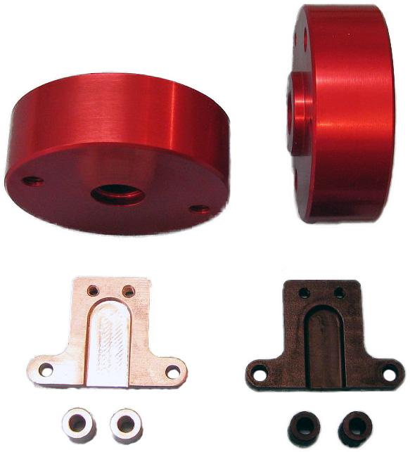

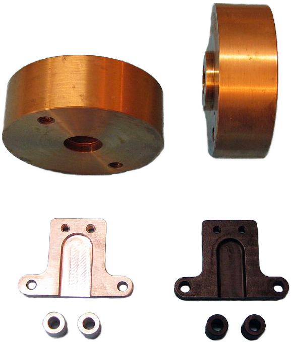

zue-kit_1_583x643 zue-kit_2_579x684 zue-kit_3_577x605
assembly kit 1
with aluminum flywheel
assembly kit 2
with brass flywheel
assembly kit 3
with aluminum flywheel &
groove for starter belt

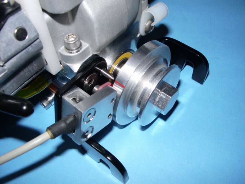

The ignition systems are adapted to all 260 ZENOAH and the similar derivates (for example RCMK and Chung Yang) with an assembly kit that I offer on my homepage www.matho-powertrain.de

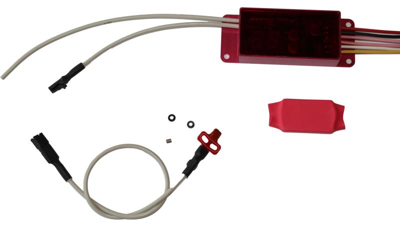

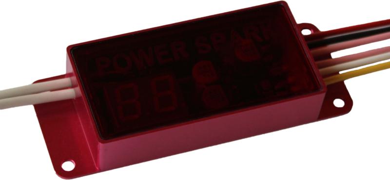

The POWER SPARK ignition system consists of the following components:
•    ignition box with all necessary cables and connector for sensor module
•    sensor module with cable and connector
•    programming magnet in red shrink hose
•    fuse with fuse folder
•    operating manual
The POWER SPARK is available in the following versions:
•    1-cylinder with or without RC-monitoring features
•    2-cylinder with or without RC-monitoring features
•    4-cylinders (double-twin) / (double-boxer) with or without RC-monitoring features
•    the 4-cylinder-versions can also be used for my 3-cylinder engine, since it’s a “one and a-half-twin” concept.

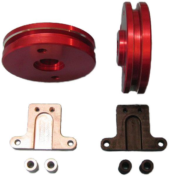

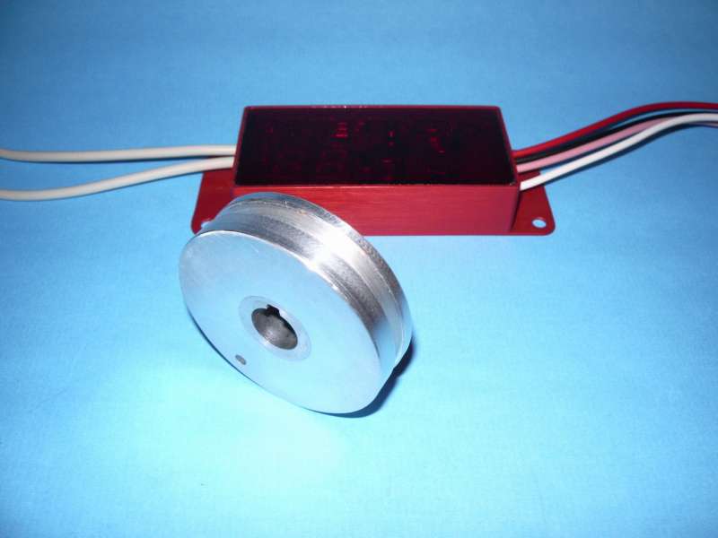

The assembly kit for ZENOAH or RCMK consists of:
•    flywheel aluminum (kit 1 & kit3) or brass (kit 2) with assembled magnet for speed sensor
•    sensor bracket (silver or black)
•    spaces for sensor bracket (silver or black)
•    Special versions for rear exhaust engines for racing (FSR-x use).

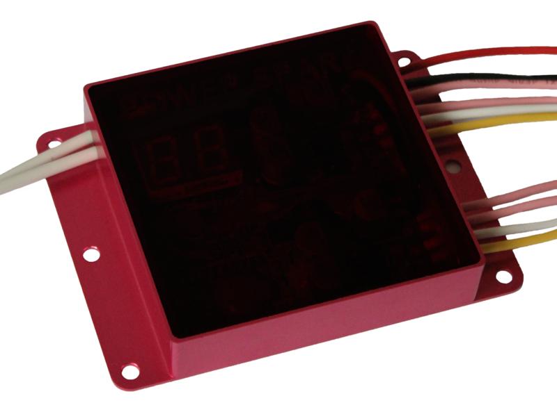

1 und 2 Zylinder Version_800x371 3 und 4 Zylinder Version_800x593
POWER SPARK ignition: 1- and 2-cylinder versions
POWER SPARK ignition: 3-and 4-cylinder versions

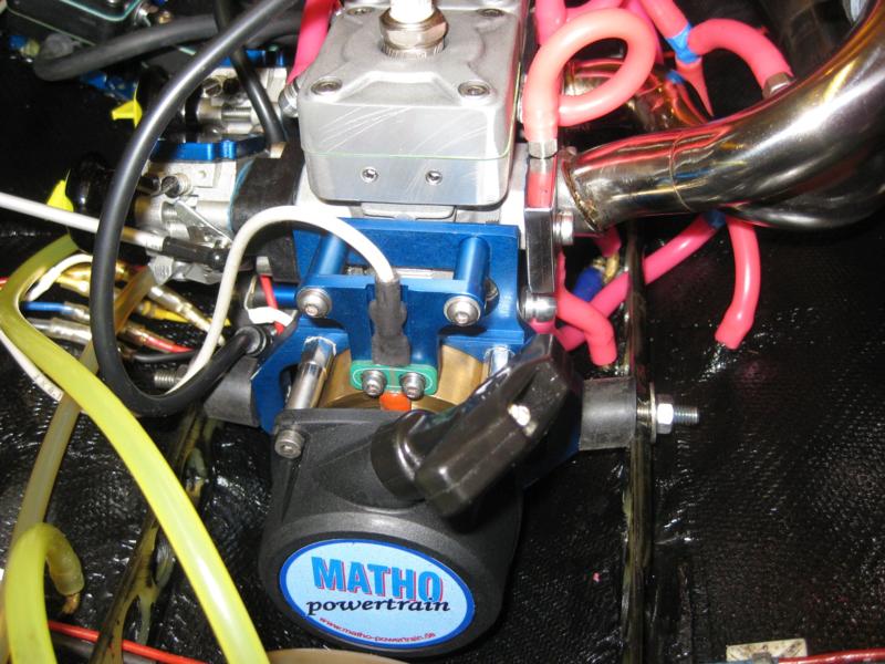

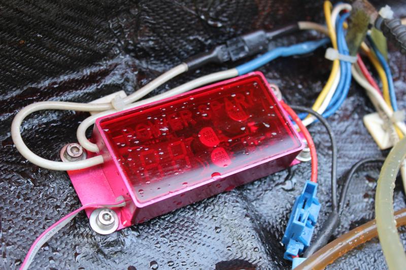

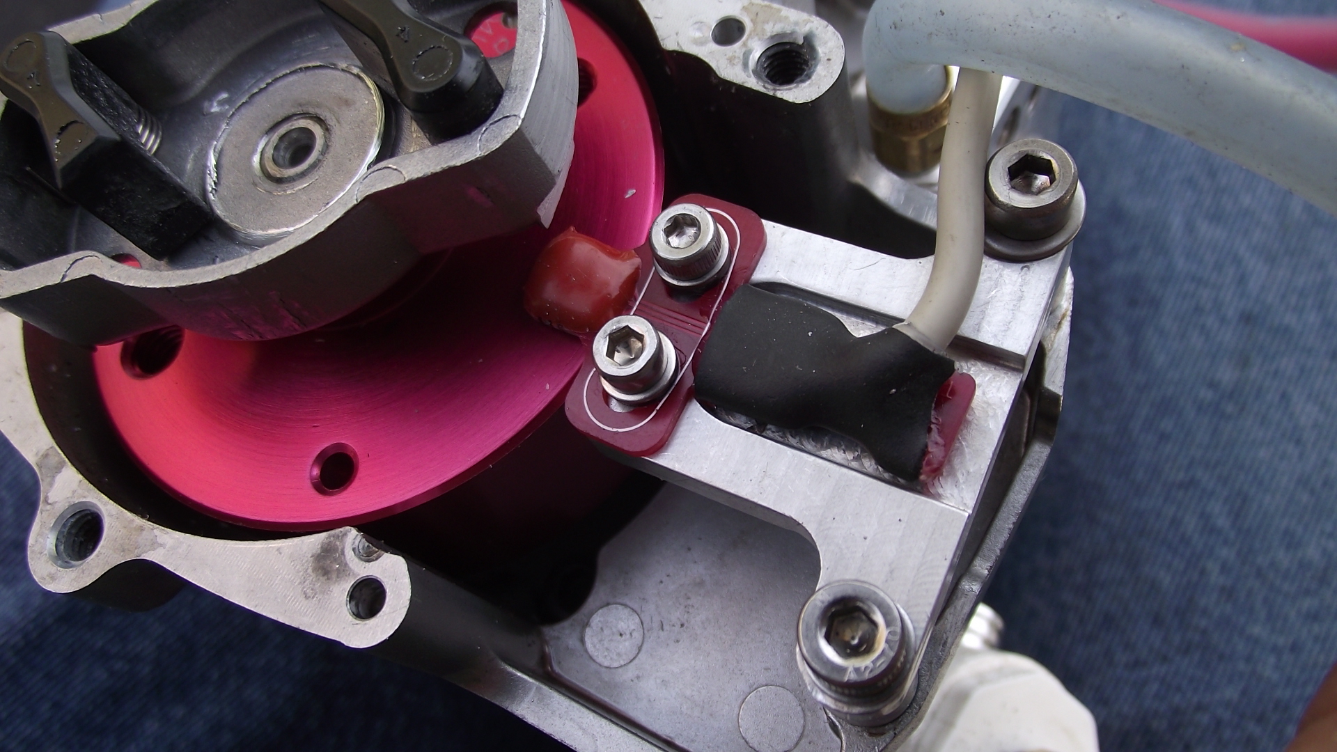

MOUSE HOUSE mit Sensor_small_800x600 IMG_5364small_800x533
MOUSE HOUSE with brass flywheel and sensor (cp)
Waterproof POWER SPARK system
left corner: programming cable (special development version)

If no RC-monitoring is desired, then simply power the ignition and start the engine. If everything is connected correctly, the engine starts - due to the more powerful spark- no later than 3 times.

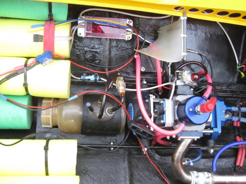

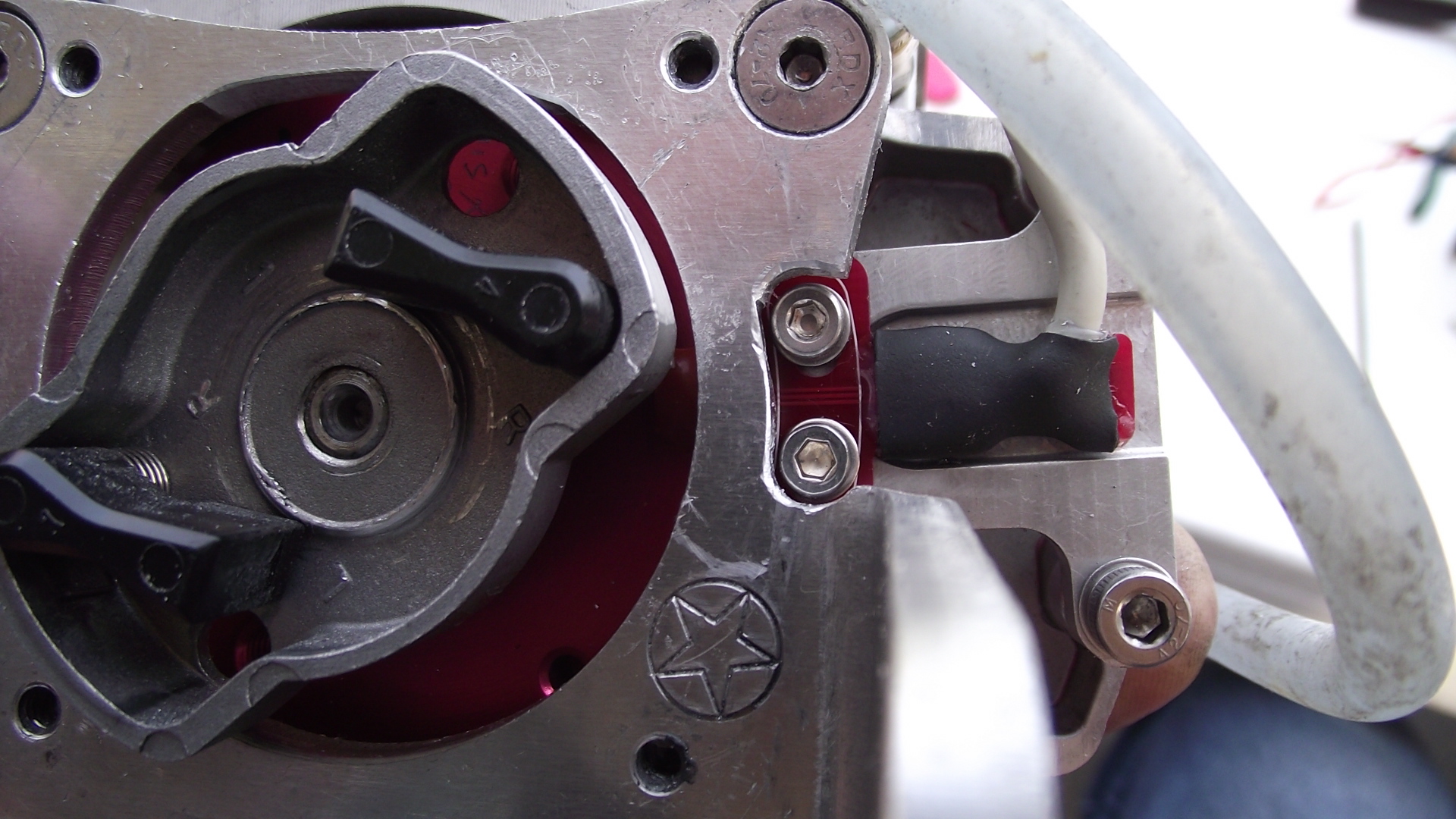

The original ZENOAH engine (tuned slightly) in my NoMercy turned about 500 rpm higher than the standard magneto ignition (load condition). Reason: the ignition spark is more powerful. Hence, the combustion at high speeds is enhanced. For the 3- and 4-cylinder engines it looks even better:  with the magneto ignition the energy of the red primary ignition coil had to be distributed to the two grey secondary coils, resulting in a weaker spark. Now, the motors can finally show their full potential.
NoMercy with MOUSE HOUSE and POWER SPARK ignition systemThe ZENOAH had to be further revised because of operation time, as an interim solution we installed a RCMK-based engine with Michi-Manz-tuning and a brass flywheel. As a consequence, the engine functions much better and works with 2 Graupner 76 propellers, which was previously unthinkable. Nevertheless the weight of the NoMercy is too much for a single 26 ccm plus splitter gearbox, so the logical consequence is: installation of our 2-cylinder engine.

What works very well is the splutter function that is activated when the battery voltage is low. Even in the fray, if several boats whisk the water the same time, one can see very well that the rooster tail interrupts shortly and then resumes. Below the selected stutter speed (in my case 11000 rpm) the engine operates as normal, so one can ride to shore normally.

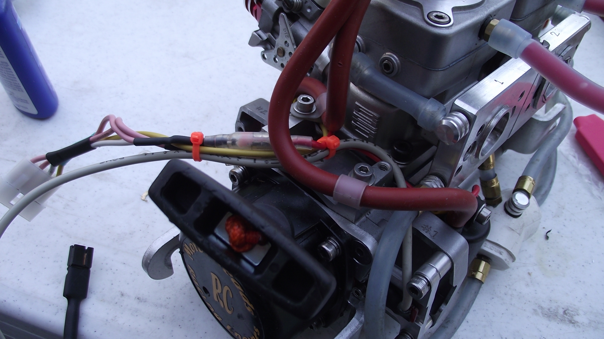

Other priorities just got in the way, so just getting back to doing this now ... did however finally spend the day fooling around with the retrofit.
The Gizmo mount did need some cut away so "pickup" coil had clearance.
Overall a pretty simple change over tho some more serious wire harness issues needed to be addressed and built so a single battery can power radio gear and ignition both.
Ignition coils needed to be modified so they ARE NOT grounded to cases.
Actually EACH coil getes set up so it's Power lead and Ground { Now on a wire) go into the provided 'engine to PS" wire harness.
*Connectors used on wiring harness a mix of 2, 3 & 4 pin Molex types. ( Computer store access )
Master Wiring harness I have made takes the 6 cell battery power sitting in forward radio box and T's into radio box supplying power to a Voltage Regulator onto radio gear.
Then going out of the box forward into engine area powering "PowerSpark" unit.
Another 3 conductor wire runs the full length going from PS unit to Receiver so the ADVANCED programing options can be utilized like low voltage alerts, radio prompt failsafe & radio prompted kill switch etc ...
