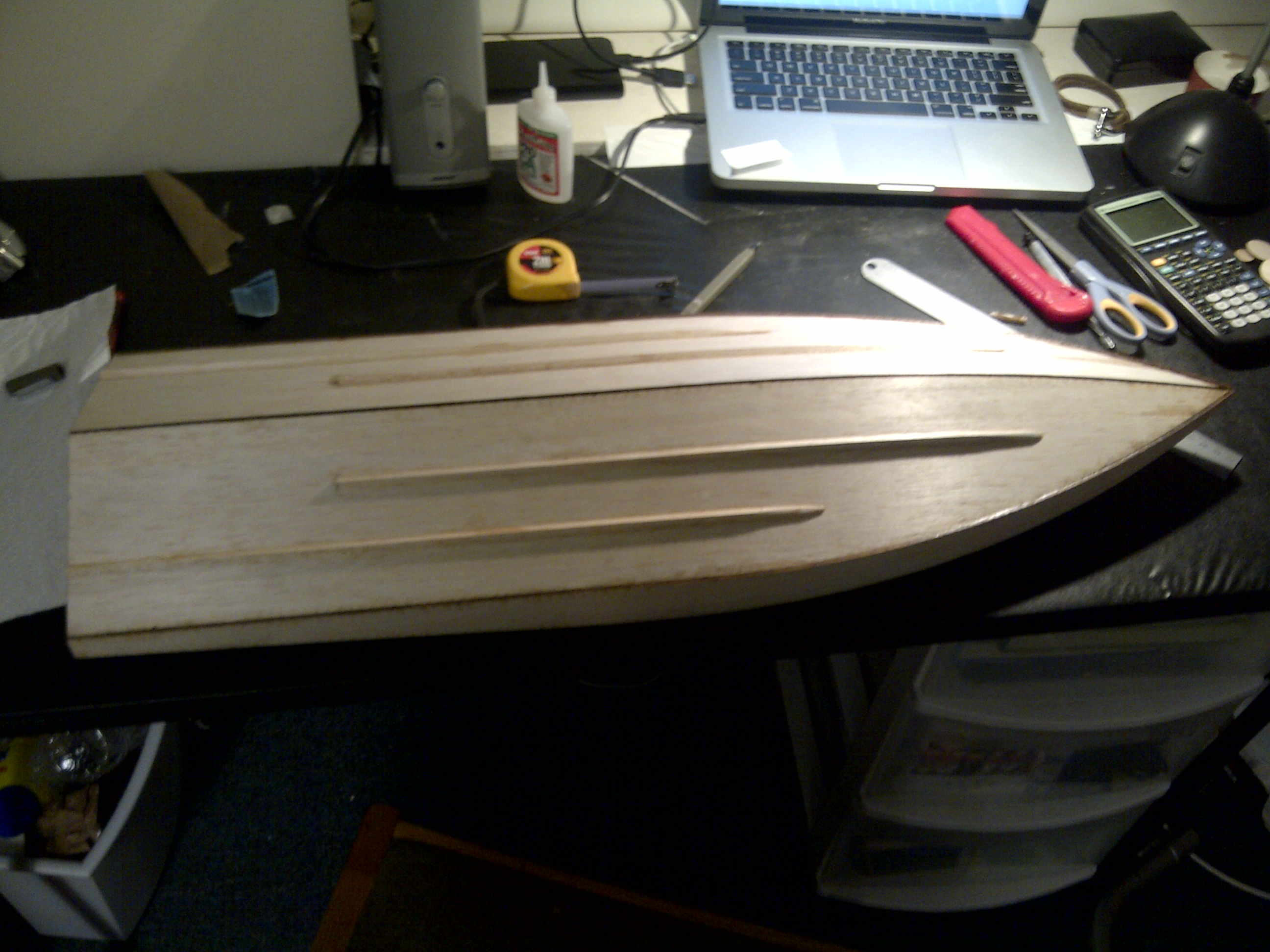

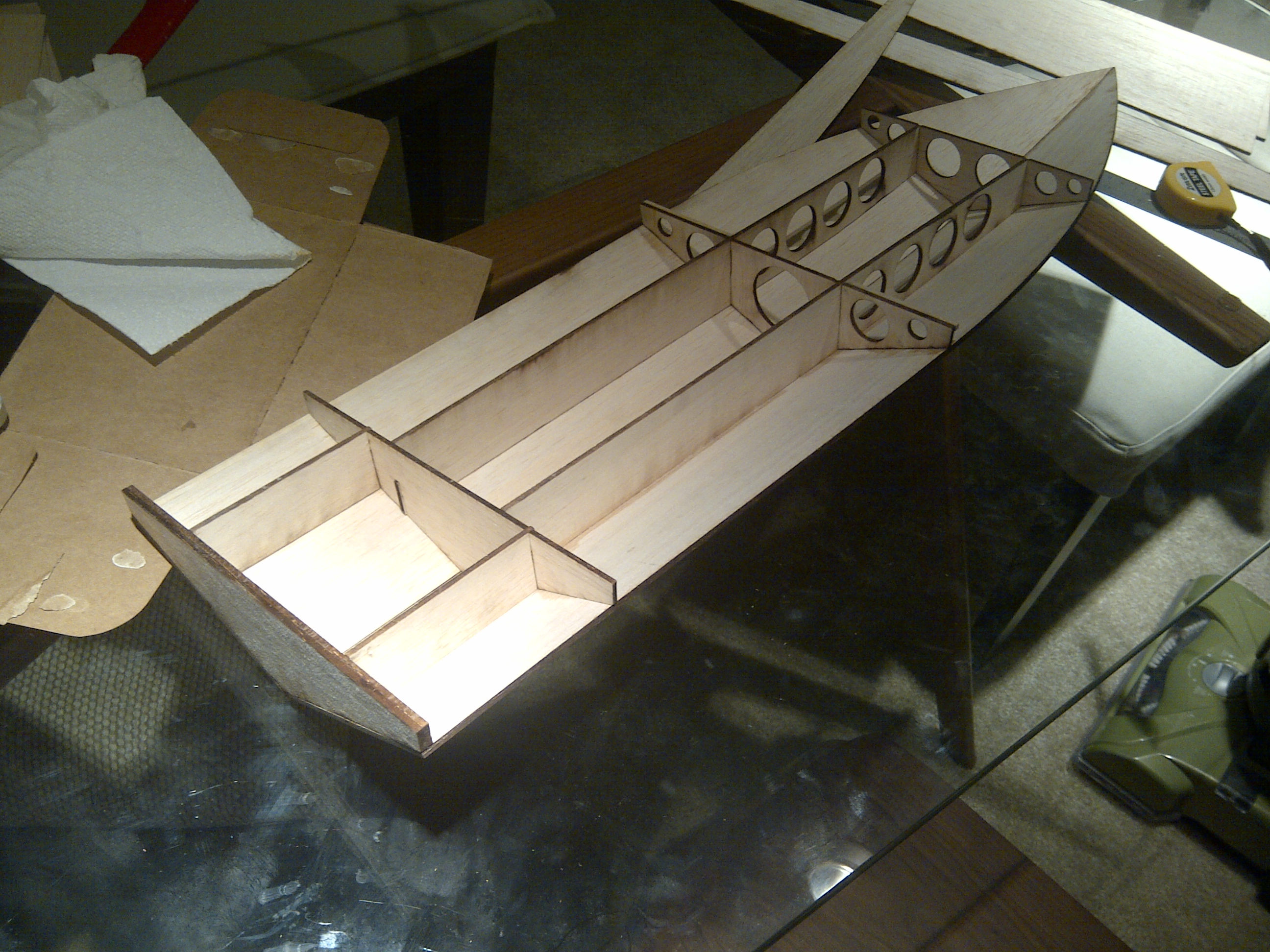

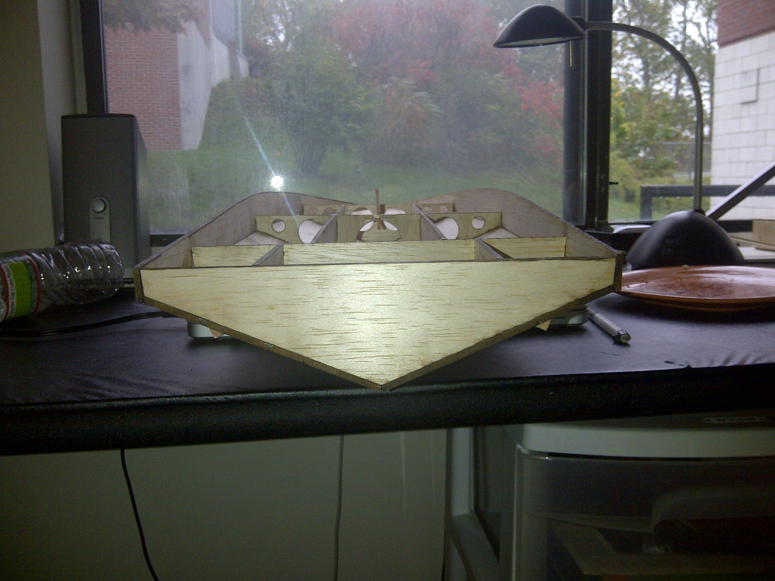

tekne10 replied the topic: Re: 48" Deep Vee
Hey guys here are some pics, its made from balsa and is laser cur.
it looks pretty good for now, i'll try to keep posting new pics.
Can any one tell me were the center of gravity should be?
Thank you,
Dan

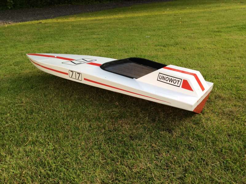

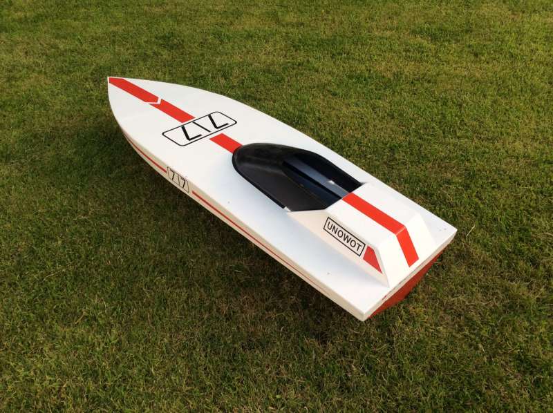

I can not believe it is over 2 years since I posted as ob one, time flies... I have completed my 48" vee and had lots of fun on the way. I have not found the funds for a IC engine so it remains a shelf model, but no the worse for it.
I have 'dressed' it as a 1970's offshore racer, as I was lucky enough as a child to attend numerous offshore events on the UK South Coast , especially round the Solent. These are the boats of my youth the Miss Embassy's, Unos's and Dry Martini.
Next up I am hoping to model some out drives, but a motor looks a long way off.
The build was challenging, with the hardest part being the forward end. This was partly caused by my plans. I printed them on to A4 and stuck them together. I believe this is where some errors crept in, because the Chines at the front end would not join up. I managed to bodge it and it looks ok. Could I suggest that plans have some reference marks say at 250mm (10") intervals, to enable A4 prints to be correctly lined up?
That said have really enjoyed the build and learnt along the way, so many thanks for putting the plans out there.
