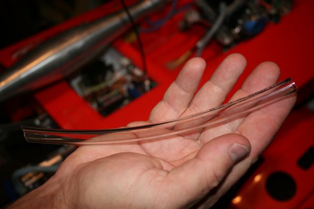

On the first picture of my Seaducer Cat inside of the radio box you will see
where I took a piece of clear hose 3/8s and slit it down the center and
folded my servo wires ,voltwatch ,battery wire and placed them inside and
took some tie wraps and closed it up .
holds or suspends the wires up in the air about half way up inside the box
about even with the center of the servo.
On the last picture you will see the hose that I used
I cut it about 1 3/4'' long keeps them all in one neat and clean spot.
