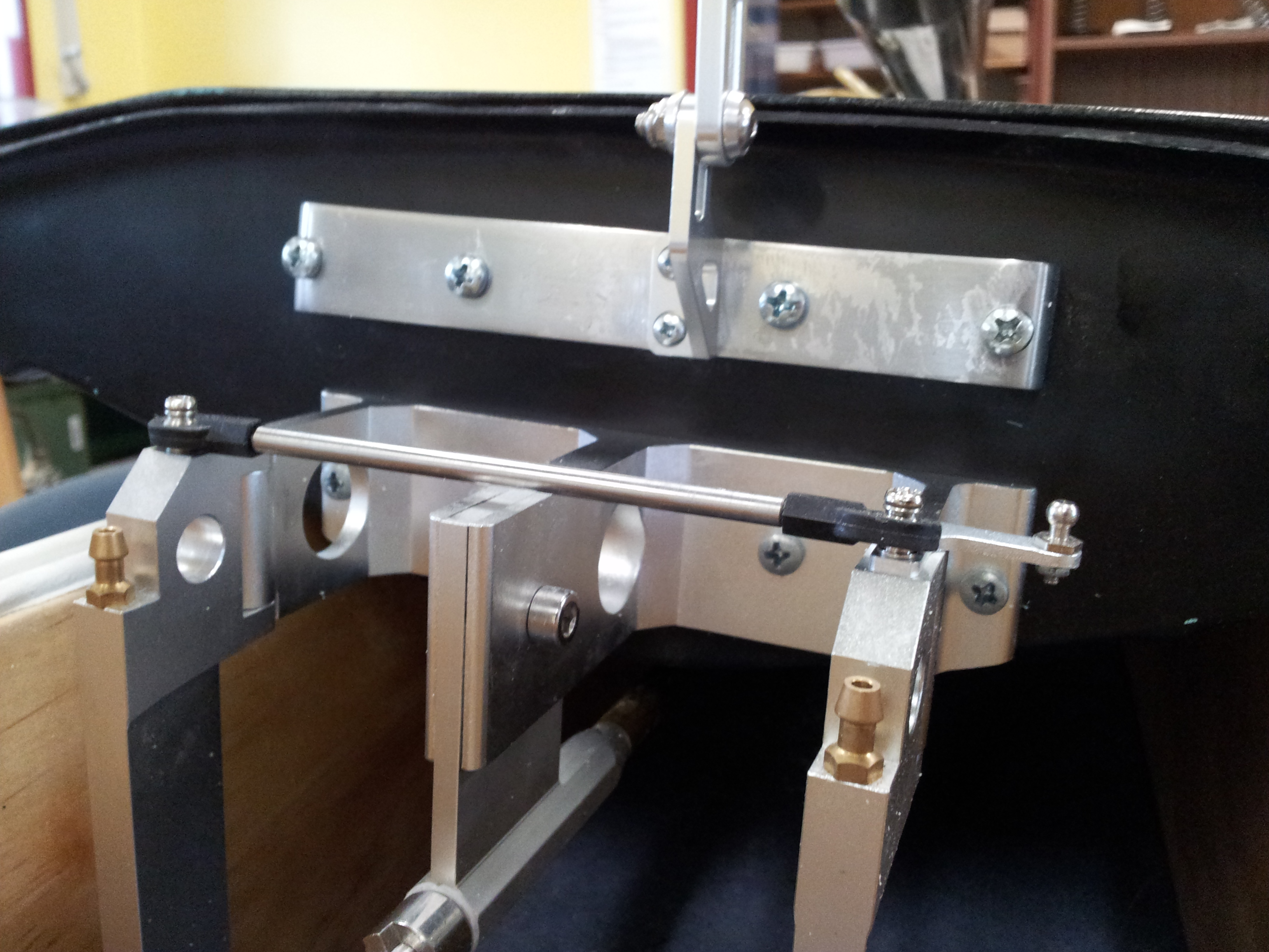

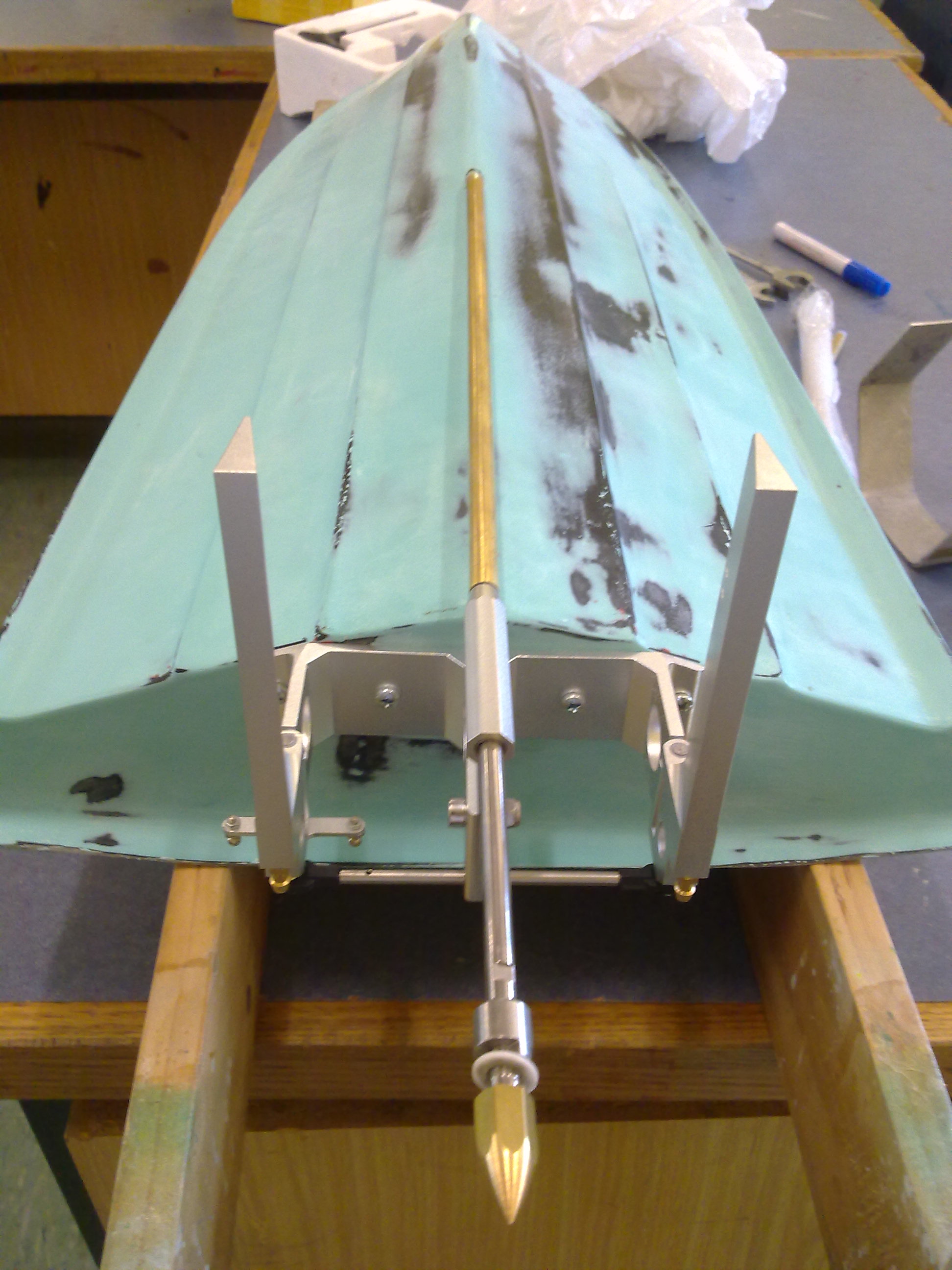

As requested:
Engine: CRRCpro GW26I Gas engine (No mods)
Boat: Custom Built (875mm x 340mm)
[attachment:1]Exhaust mounted 1.jpg[/attachment]
[attachment:2]Hull Rudder Attached 3.jpg[/attachment]
[attachment:3]Rudder (2).JPG[/attachment]
[attachment:4]Rudder (3).JPG[/attachment]

Steve Seebold replied the topic: Re: Prop Help
That's a nice looking set up, but I see a couple of potential problems:
1. Your rudders appear to be extremely thick on the trailing edge.
2. The leading edge of the rudder is a considerable distance behind the pin putting an excessive load on your steering servo.

michaels750 replied the topic: Re: Prop Help
Ahh, well I just bought a good looking one off ebay. I was looking for one that had a prop mount etc.
My servo is a 13kg torque ball bearing servo, so I assume that should be enough.
Unfortunately I can't replace any of these parts because of time constrains. So if there is any props out there that would work the best with this set up that would be awesome.
