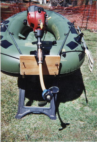

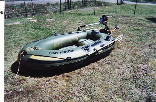

Brian,I made a motor for a Sevylor 8' inflatable I had from a Homelite and used a Minn Kota vanishing trolling motor prop on it. It wasn't fast but was better than rowing.I used a transom mounting bracket I got cheap from Ebay and got everything in place and it worked great.I wIish I would have had a brush cutter lower shaft like you have.

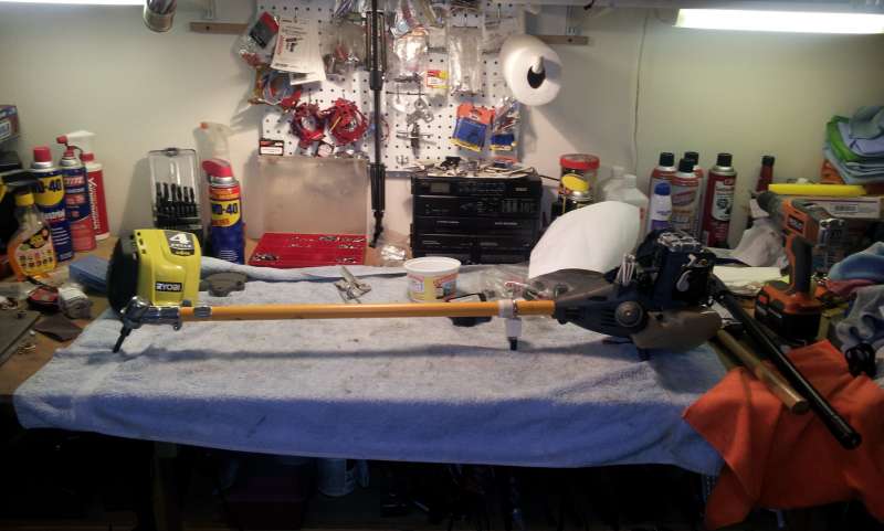

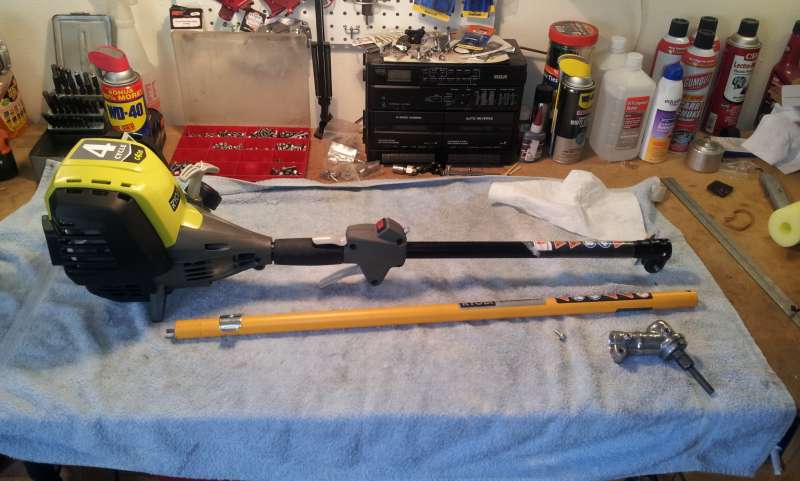

How cool is this! Got to post pics of the new project, and didn't have to start a new post! HAHAHA! My weedeater was a curved shaft unit like yours. I picked up the straight bottom shaft at Home Depot for $60.00. I got the whole conversion kit off Ebay for $100.00. The transom mount, prop, and a bunch of little doo dads along with killer instructions. Yours turned out very nice ridgerunner! Low budget and dependable! The motors the club out here has are junk! They never start and have been cobbled beyond belief! This little 13lb wonder should drop a couple jaws! HAHA! Brian

That long throttle handle on mine adjusts up and down and has a mini bike twist throttle on it.I sold the boat and motor as I was supposed to get a small bass boat with a motor on it ,but the deal fell through.I may get another boat and make another motor in the future.I think my next will have a modified water cooled motor with the exhaust exiting in the water.

ridgerunner replied the topic: JRCBD
Notice the blue thing in behind the prop.I don't know if you're using a trolling motor prop or not but I cut the bottom off of a dry gas container and clamped the bottle neck to the shaft to deflect the water as the boat is moving forward,to help reduce any drag caused by the back of the prop.
Also you're lucky that you bought a straight shaft for it as that 4 cycle trimmer has to be at a normal trimming angle for the engine to get oil for lubercation.I was thinking of that and called and talked to a Ryobi tech and he verified that. The curved shaft puts the engine at almost a vertical position,which didn't matter on the Homelite one I built.

I will be using a "Young" 2 blade prop that came with the kit.(5 9/16" dia.) It's aluminum and the hub on it is the same diameter as the hub on the drive unit. The drive unit has a 3/8" dia. shaft with a 5/8" hex at the bottom. The prop has a 3/8" hole and a 5/8" hex cast into the back of it to slide over the hex on the shaft. Nice drive dog I think! Just have to be careful not to bang into any rocks! Ain't no 1/8" roll pin to shear on this one. It could get ugly! YIKES!! I'm working on the tiller/throttle arm tonight. Brian
