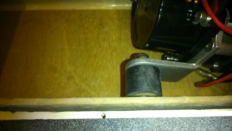

This mount is only for mock up and will not be used due to the welded mounting ears. This mount doubles as my power spark sensor mount. Not installed in this pic, but it also has a TDC pointer on the top left. When you put your mind to it a custom mount is nothing to fab. Once a long time ago guys fabricated the mounts we all use today. Nothing to it. My actual mount is off for powder coating, thats why this one is shown.

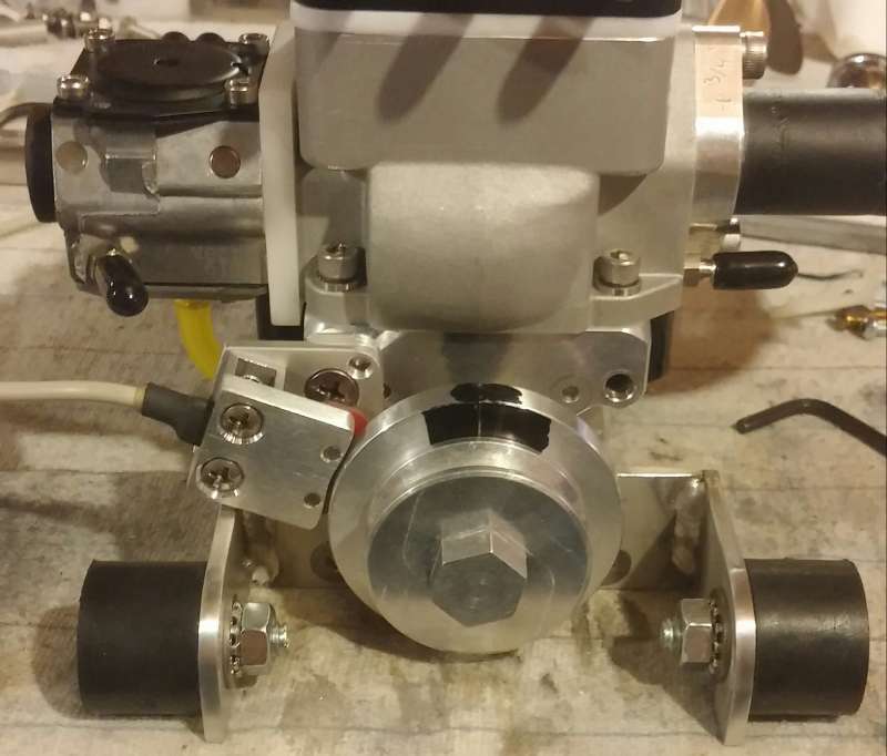

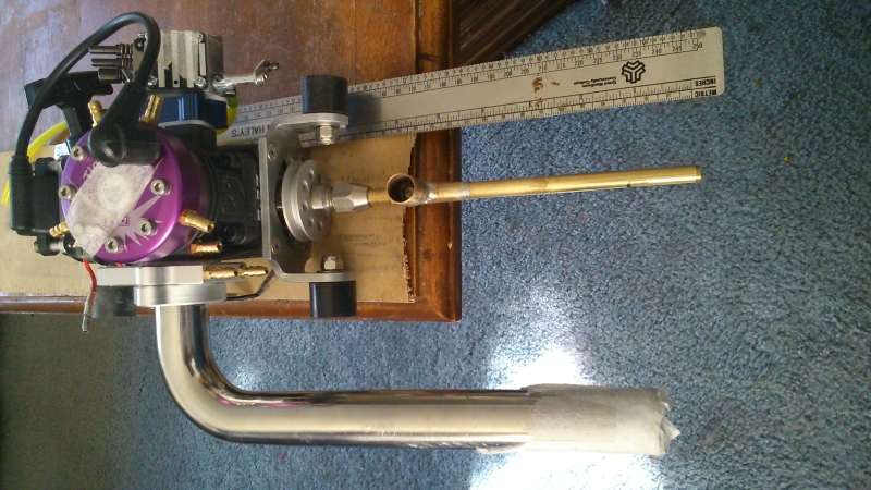

engine sitting out ready for install (normal mounts) jig in place in collet

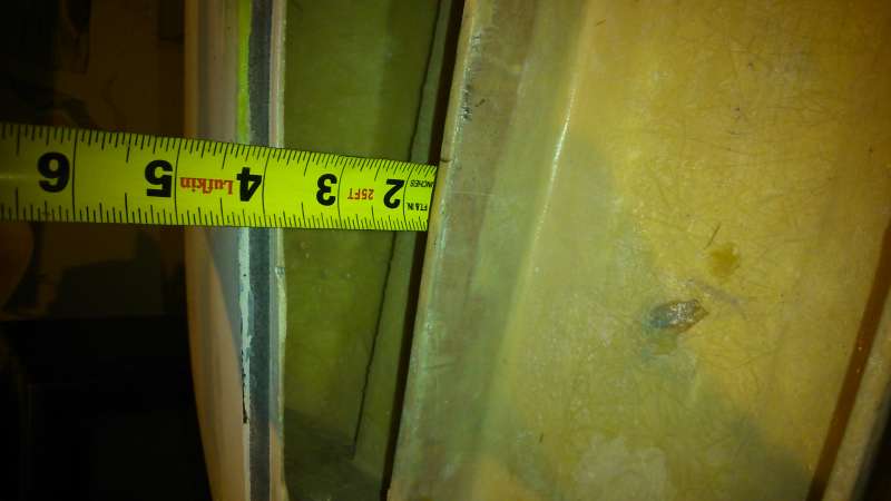

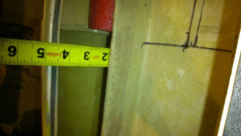

measurement of engine rail rear mount location
measurement of front mount location

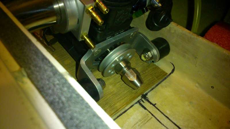

Engine sitting on 1/8 luan at 14.6* image of front mount
rear engine mount same engine angle
