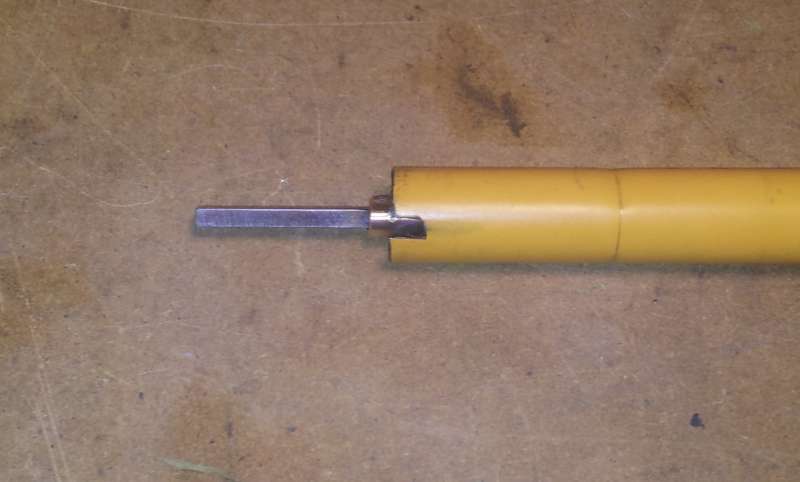

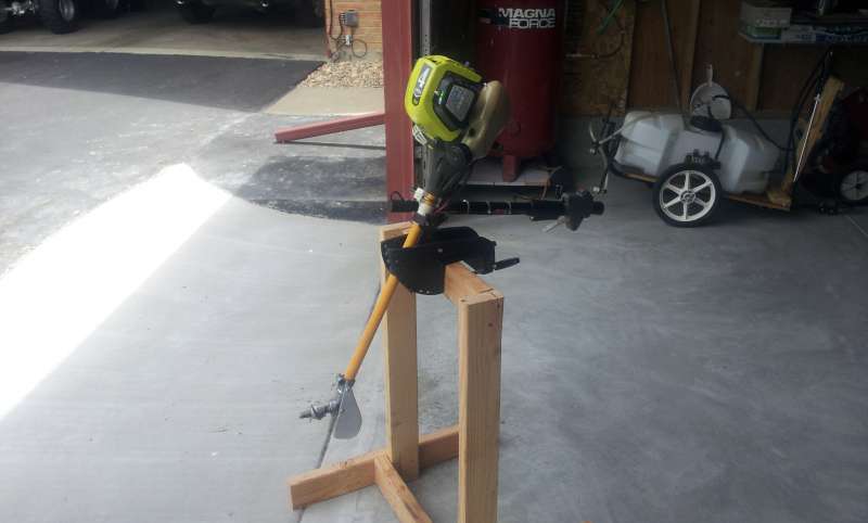

Ok, Got the motor back together this afternoon. I went into work this morning and whipped up a 1/4" round, to 5mm square shaft to go from a 1/4" fuerrel into the clutch after I hacked the flex down bout 7". I don't think eggbeater thing at all. The prop used to be about 12" below the surface. Now it looks like it will be only about 4". The sides of the boat are 10" high. We'll test next weekend. I still have to finish up the swing open clamp to lock the prop height off more securely than the cheesey plastic thing on there now. Here are a few pics. Brian
