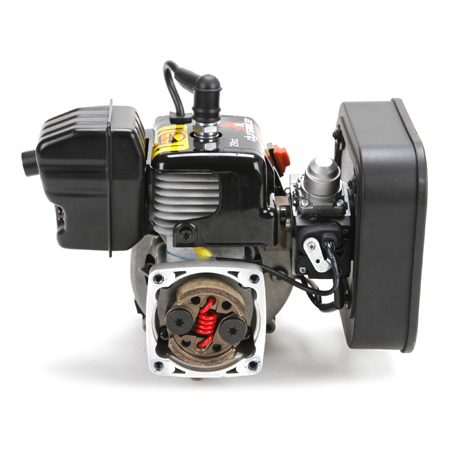

You guys are cool I'll tell you the unit I have in mind.
After getting harangued and told I was stupid it won't work etc I wasn't going to share, but I will with you guys.
Its on the market, it works.Its used on 1/5 scale buggy and an aircraft engine.
I was talking about the Surefire™ EFI System.
There are actually four sensors mounted directly to the throttle body.
1.Intake air temp
2.Crankcase temp
3.Throttle position
4.RPM
It automatically adjust to the maximum RPM at WOT to compensate for differant loads, muffler/pipe and applies any change across the entire pre-programmed fuel map.
It does this each and every time the throttle is opened.
As soon as can get an EFI unit by itself I'm going to get one.
#24618
tootalltechie replied the topic: Boost bottles?
Bob, thats looks like simple system on the Evolution 62GXI. Being a reed valve engine, do you think it would be a hard conversion to piston valve? Or would it be easier to convert the engine to marine use?
#24620
Bob DeCortin replied the topic: Boost bottles?
Its on a piston port 26cc buggy engine also.Should be plug and play.
Not sure how much the unit would cost by itself but the entire engine isn't that much.

Canadian Hot Rod RC Boats replied the topic: Boost bottles?
That's even cooler
www.dynamiterc.com/Products/De...ProdID=DYNE1100
Wow for 300 bucks that has some serious possibilities
I can toss a carb on that and sell at hobby shop for 200 bucks and score a EFI -- guess I need to talk to wifey about her C Card ..lol
