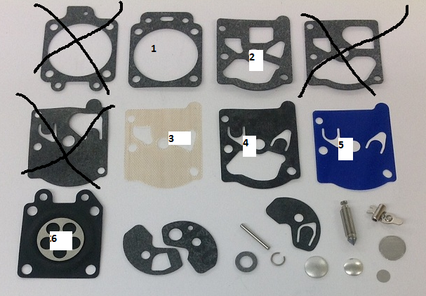

Canadian Hot Rod RC Boats replied the topic: walbro 257
no hole in gasket - most likely the carb you had just needs cleaning and some new gaskets - perhaps a new vacuum hose
should look like below (from Daniel Place)
The X'ed out ones are not used in our WT's.
For the pump section you have two choices if you have this kit. One is just use the blue #5 on the carb with the gasket #2 over it then the cover.
But what you may not realize is you have another better choice. That is laying the black #4 flapper down on the body then put the beige #3 over it to get your fuel pump diaphram then top it with the #2 gasket and then the cover. The #4 and #3 together make up what was one beige originally in the carb.
On the other side with the four screws always put down your #1 gasket then the #6 needle metering diaphragm then the cover.
