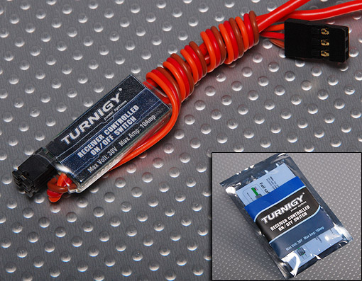

Well Folks Thanks for all the great advice and after reading and researching I think for someone like me a beginner not into racing fast I am leaning towards the Futaba 4pls. Only thing I would like to know is if I can use one channel for steering, one for throttle and the other two for switching things like turning on lights or switching some othe accessories. I am sure once I buy the radio I will learn it all but want to be sure it will do what I want.before I purchase. You all are right and lean the same way put your money in the radio so no one gets hurt from a runaway boat or crashing a very expensive boat.
#25475
Canadian Hot Rod RC Boats replied the topic: Transmitters
Yes you can do that - but you need a "Switch" to turn your switch on
yep confusing
You need to install one of these (or one like it) reading the description about it below will help explain better
hobbyking.com/hobbyking/store/...ed_Switch_.html
in 3rd or 4th channel on RX then wire your lights etc to it. Then you can turn stuff on / off with TX
#25476
johnnybegood1 replied the topic: Transmitters
OK Got it, seems easy enough I was thinking on the line of a servo operating a switch I didn't know they had those. I have a lot to learn. Every time I lean towards a radio and start reading reviews I get crazy they all have good and bad it seems like. Tthats why I was kind of leaning towards the 4pls at least it is a good name brand.
