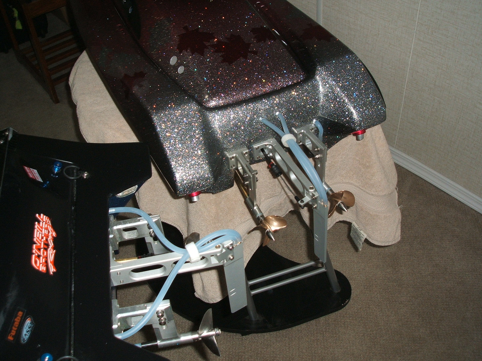

Canadian Hot Rod RC Boats replied the topic: Re:twin engine drives / rudder
HI
Hope these work will find out tomorrow (hopefully -7C right now)
I went with the single rudders on both the twin engine 50 (modified O Neill's) and the twin 60
Thanks
I can only post one pic at a time sorry
