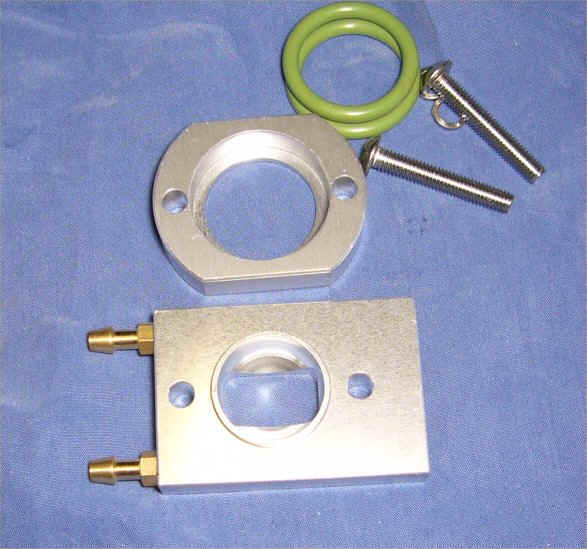

Scott, I am interested in these “no leak” style manifolds. Would you or any members be able to include a photo within this thread so that I and see what they are about?
Craig

Canadian Hot Rod RC Boats replied the topic: Re: Exhaust port/flange- gasket or no gasket?
I'm the same as Scott I use a factory gasket (some after market last 30 secs) works for me
no leak below
www.gizmomotors.com/index.php?...emart&Itemid=56

Scott replied the topic: Re: Exhaust port/flange- gasket or no gasket?
Canadian Hot Rod RC Boats wrote:
That general style ( No leak ) are named so because NO water can get into pipe/engine when an o-ring fails. Only leak is that of exhaust gas's which effects nothing but noise and maybe power a tad.
Having an o-ring failure on water circulation around ring type flanges are real power killer when they lose a ring because water is allowed into pipe and engine while running :S

Brigadair replied the topic: Re: Exhaust port/flange- gasket or no gasket?
Craig
Prestwich Model Centre sells the no leak manifold in CNC Aluminium. As you know, I use this on my Sikk engine.
Brigadair
Brigadair wrote:
CS 61 from Dave
www.prestwich.ndirect.co.uk/gaspipes.htm
