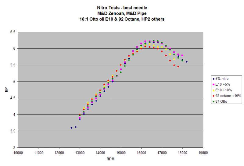

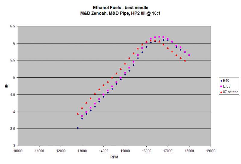

lohring replied the topic: Oxygenated race fuel
We've dyno tested a lot of fuels over the years. There was no question that VP's U-2 ran faster in Quickdraws. The SAW record set on 2004 of 109+ mph with it still stands. Tyler Garrard's Quickdraw powered Whiplash still runs it at big events. It easily wins while running well outside other boat's wakes. However, the engines need to be set up with different pipe lengths, higher compression, and different ignition timing for different fuels. We tested various fuels on a modified Zenoah where we only adjusted the mixture. There was very little difference in performance. See Gasoline in the October 2009 Propwash for the details.
Lohring Miller
