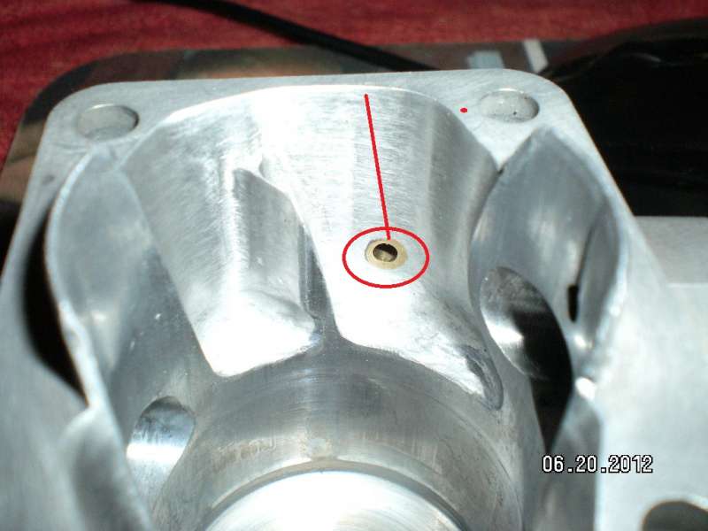

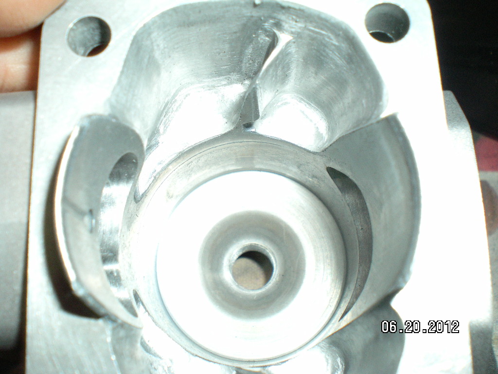

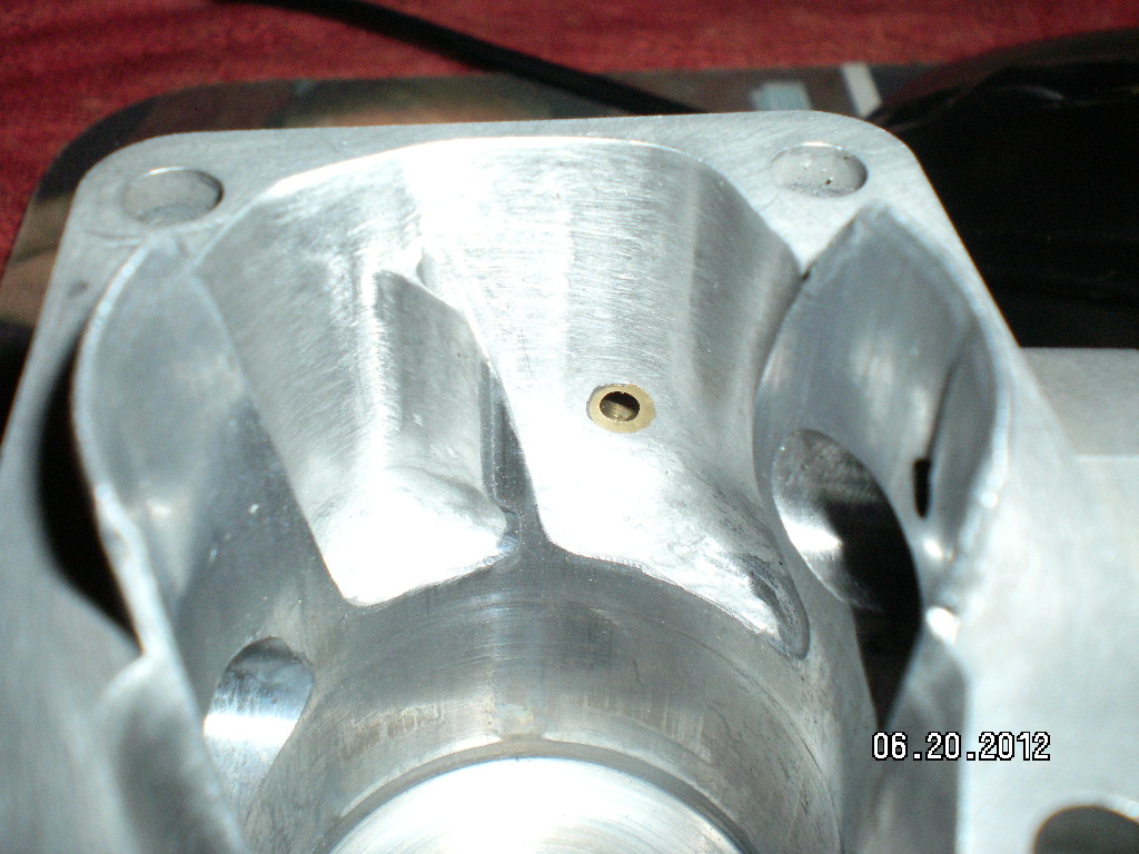

Scott replied the topic: Re: RCMK k30s porting!!!!
NOT MY PICTURES ... But ones I took off JRCBD showing a modified K30 with enclosed transfer port uncovered ;)

mickbuy0 replied the topic: Re: RCMK k30s porting!!!!
Hi,thanks for the pictures,(K30s barrel) what changes would you make to the piston and base gasket thickness with these mods on the pictured barrel?
Piston maybe just some profiling alongs sides of and on pin boss areas.
Gaskets need to be opened up in size for the bigger transfer passages.
If splitting cases ? Trough above bearings need to be further cut back again matching gasket to the cylinders transfer passage shape.
It's called BLUEPRINTING :laugh:

david36pt replied the topic: RCMK k30s porting!!!!
Hi Scott
Hope you are fine
I m going to try to port my K30rz .Do you have more fotos of the head afther porting??And the piston?
Can you advise what is the opening in the transfer that we see in the photo like an inlet??
Regards
#22340
marc replied the topic: RCMK k30s porting!!!!
Looks like a brass fitting... Possibly a pulse tap? Can we see the outside of the jug a that area please?
