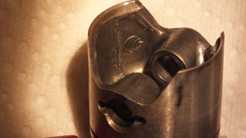

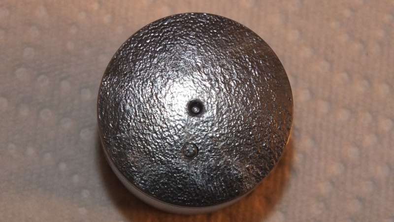

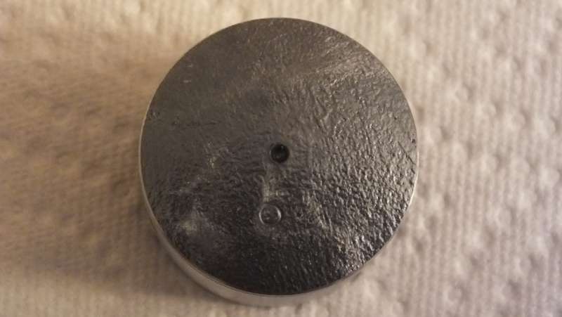

I'm convinced that CY places a stippled surface on the crown of it's pistons. I have no
idea why they do it.
Please see the photos. Two pics of the stipples - one with natural light and one with flash.
The third pic is the internal surface and it it is easy to see how much smoother this raw
cast surface is as compared with the crown.
There are only two observations I can make about the effect of the stipples:
- when I use gasoline, combustion deposits stick to the stipples readily and form a dark,
coated spot on the pistons crown
- when I use camp fuel, there are no deposits which stick to the crown
If anyone has any guesses or conjectures as to why CY thinks these stipples are beneficial,
I am very curious to read your thoughts. TIA

There was no suggestion made in post #22511 that it is or might be a coating. The stipples
displayed in the pics are formed from the cast piston's aluminum. Sorry I did not make that
clear in the original post.
>I believe that it is the surface
>texture that is on the permanent mold which is coated with a spray on releasing agent to
>protect the molds surface.
I agree. It is in the permanent mold. The mold maker is adding that surface texture to the
mold - the question is why do they spend the extra time?
>It can be smoother, just up to the person in the die coating department.
I'm convinced they want it stippled like that. The six CY pistons I have here all have the
same texture (stipples) on the crowns. Also, the third pic in the original post proves how
smooth they can cast a surface (piston interior) when they want to. That is the CY logo
showing in the third pic also – a single dot with double crescents – AFAIK, all CY pistons
have that logo in the casting.
