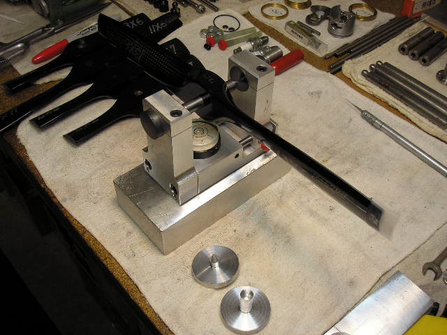

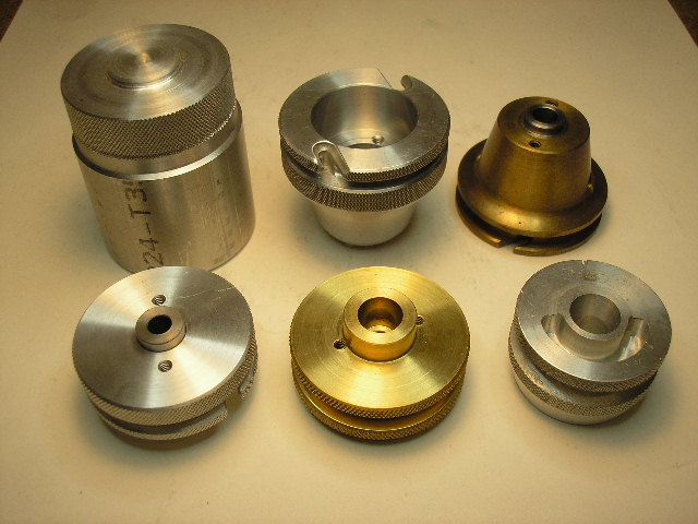

If a magneto type flywheel is to be balanced, a balancer similar to the one shown in the lower right hand corner of the photo should be used. An explanation of how it works can be found on the Bolly site. A matching taper to the flywheel's taper is machined in the top piece & since both pieces are made of aluminum there are no magnetism problems to consider. The balancer can balance in two planes at the same time, which is impossible with magnetic or spin type balancers.
Jim Allen

What your showing is still just a static balance.
#22795
strictlybusiness1 replied the topic: flywheel
If the difference between the front face & the rear face of a propeller spinning at 13,000 to 18,000 RPM is .636" X 1.448" hub diameter, what could happen with a .900" thick piece X 2.358" in diameter spinning at the same RPM, considering the flywheel weighs 7.3 ounces & the propeller weighs 1.4 ounces? Yes, it is a static balancer, but it can balance in two planes at the same time. A magnetic or spin type balancer can balance in only one plane!
