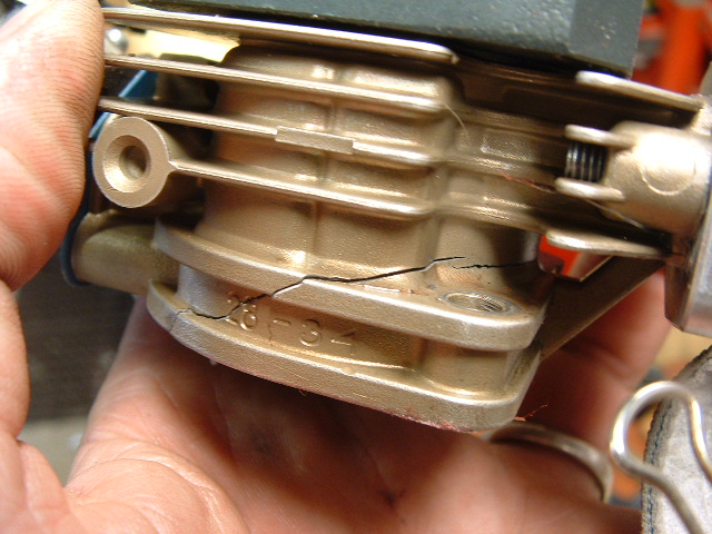

Yes, the CY 26 marine I fooled with for a few years was run maybe 3 gallons of fuel.
In that time the original cylinder had the soft chrome and was trashed, Did a 27cc 35mm jug that ran pretty well and was only a tester and illegal to race with so I sold it off the engine. Did another full mod 25.4 top end next and it failed within a gallon of fuel by splitting the casting at cylinder base. Did another top end with more mild mods and it ran less than a gallon before warping the cylinder base and spitting out gaskets one after another.
Finally put another NEW top end on it and SOLD IT !!
Lets say at this point you would have to PAY ME to own one and would only do so with more than one because they IMO are too unreliable :angry:

The broken one

I just finished some dyno tests on a Chung Yang 27 ported for SAW racing. The engine made over 40 dyno runs at up to 24,000 rpm. It developed good power, especially past the peak. SAWs require very high rpm since propeller pitches are limited. The main problem was the two cylinder bolts wouldn't stay tight. We finally replaced the stock base gasket with an aluminum one and safety wired the cylinder bolts. The next engine will be built without a base gasket.
A tear down showed normal break in wear. I expect the cylinder cracking and gasket failures come from loose cylinder bolts. We were able to see the failure immediately and brake the engine quickly to a stop. At the very least, I would use a copper base gasket and locktite the cylinder bolts. Safety wire, properly done, is even better. The best solution would be a four bolt cylinder.

and ive seen more pics of brocken jugs in the same spot from the sikk then ive ever seen from a zenoah.......
