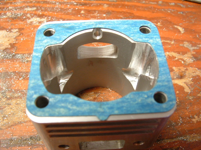

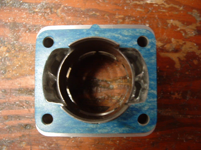

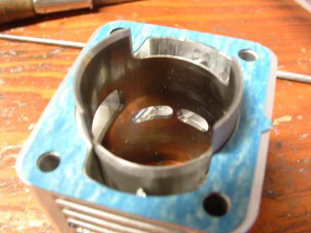

Scott replied the topic: Re:J&G liner questions
More ....
#6881
Zitch replied the topic: Re:J&G liner questions
very, very interesting steps!
quality, good photos,
I story it for future,
it's no so hard to do same,
thanks a lot!!
Skott,
in the one current of modding, please let me know your view point for piston weight. I use a Hanson M-cut pistons and happy. Some our guys are cuts off inside a pistons and gets it less 20-19 gramm...and try to less...
Zitch wrote:
I always do MAJOR lightening of my Zenoah pistons.
The J&G top end pictured was assembled with one of the Newer RCMK S-254 pistons. They are VERY light weight, tapered shape & a nice fit & finish. * Did have too trim the squish contact area on piston @ .010" to get the right clearance tho.
for your information,
after the honing repair, my engine ask me to move a tune pipe little bit back, to longer :? :? :?
#7131
Loss of torque from piston ring not seated in yet would be my guess.
* Did you install a Fresh ring ?
