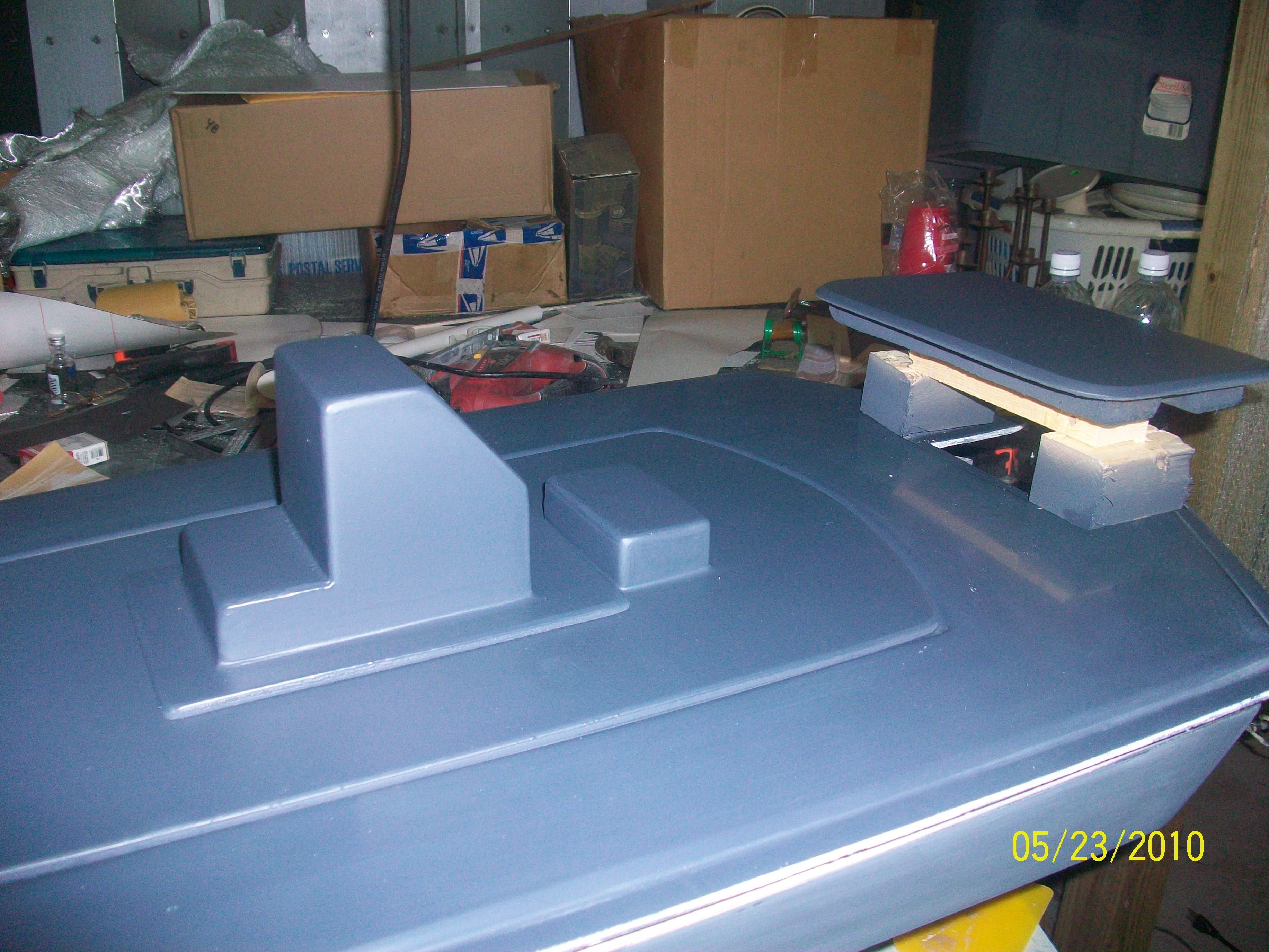

dirtslinger321 replied the topic: Re:My First Build
More pics from this afternoon. swapped out a couple of pics at top.

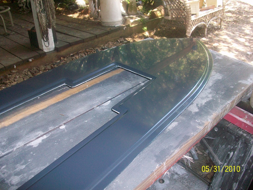

Finally building molds

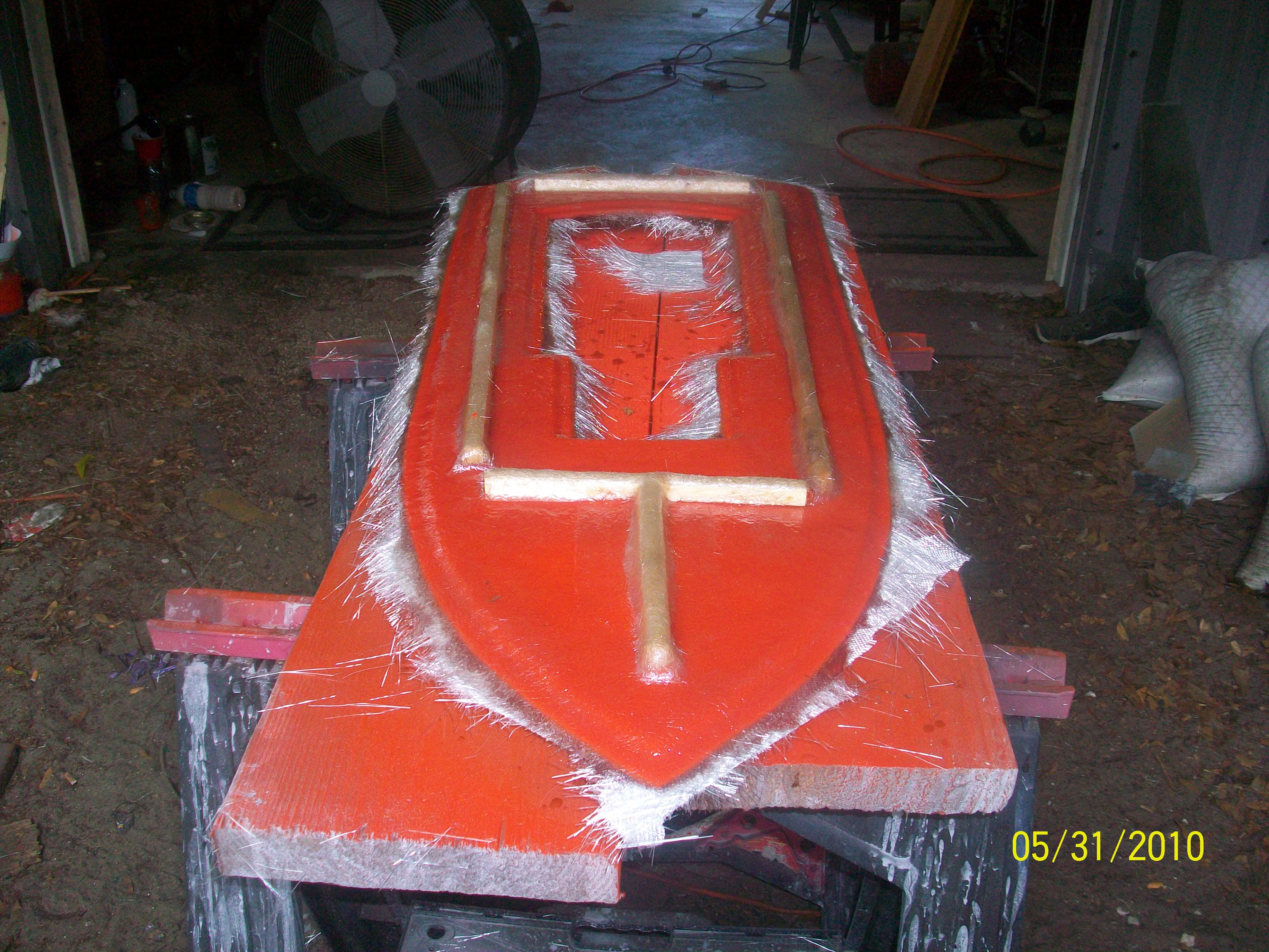

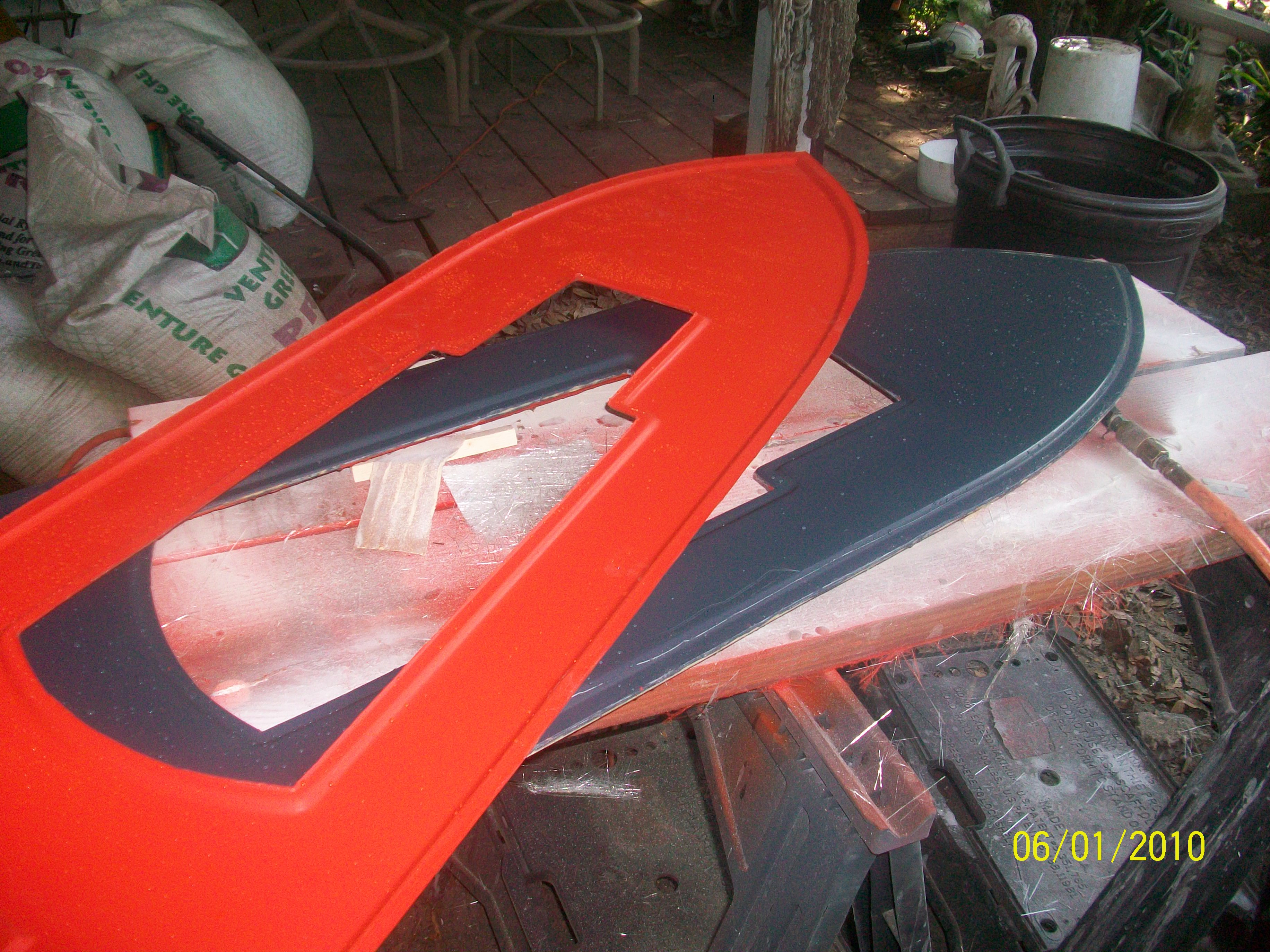

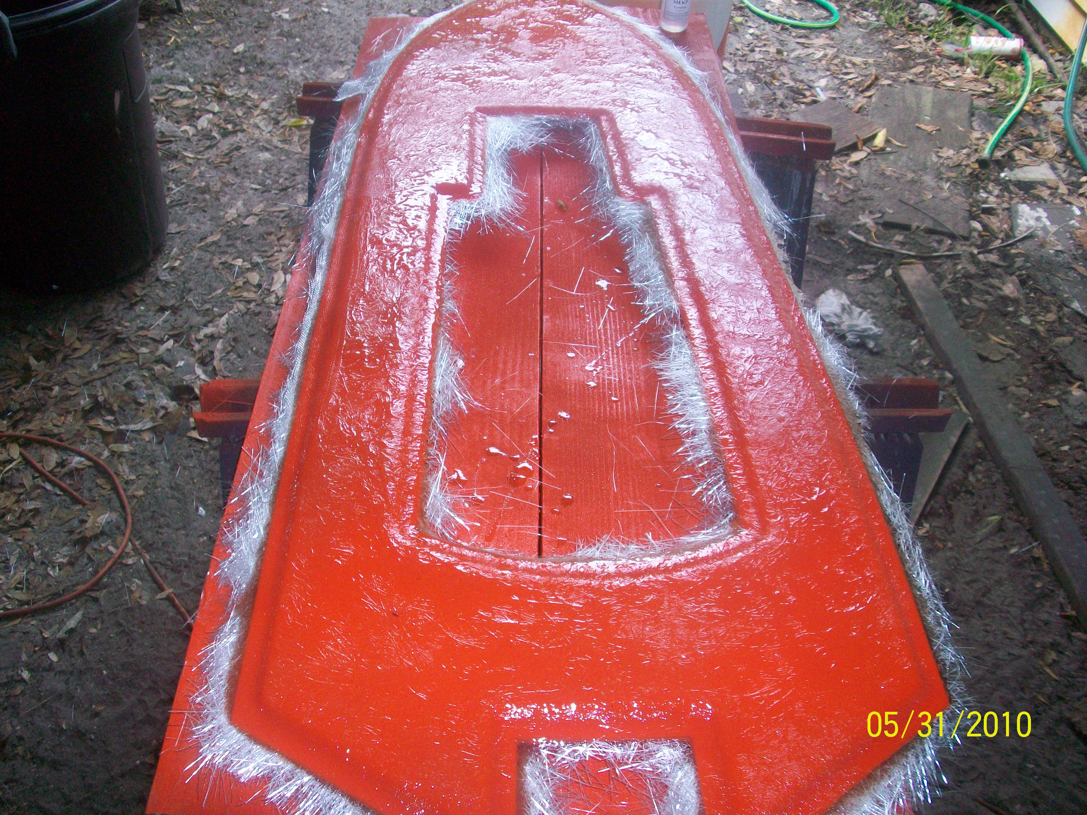

after the plug was waxed red tooling gel was applied, then several layers of 1.5oz matt.
#11893
wood is glassed in to keep the mold rigid. This helps keep warping to a minimum. I have a little more work to do before I separate mold from plug.
