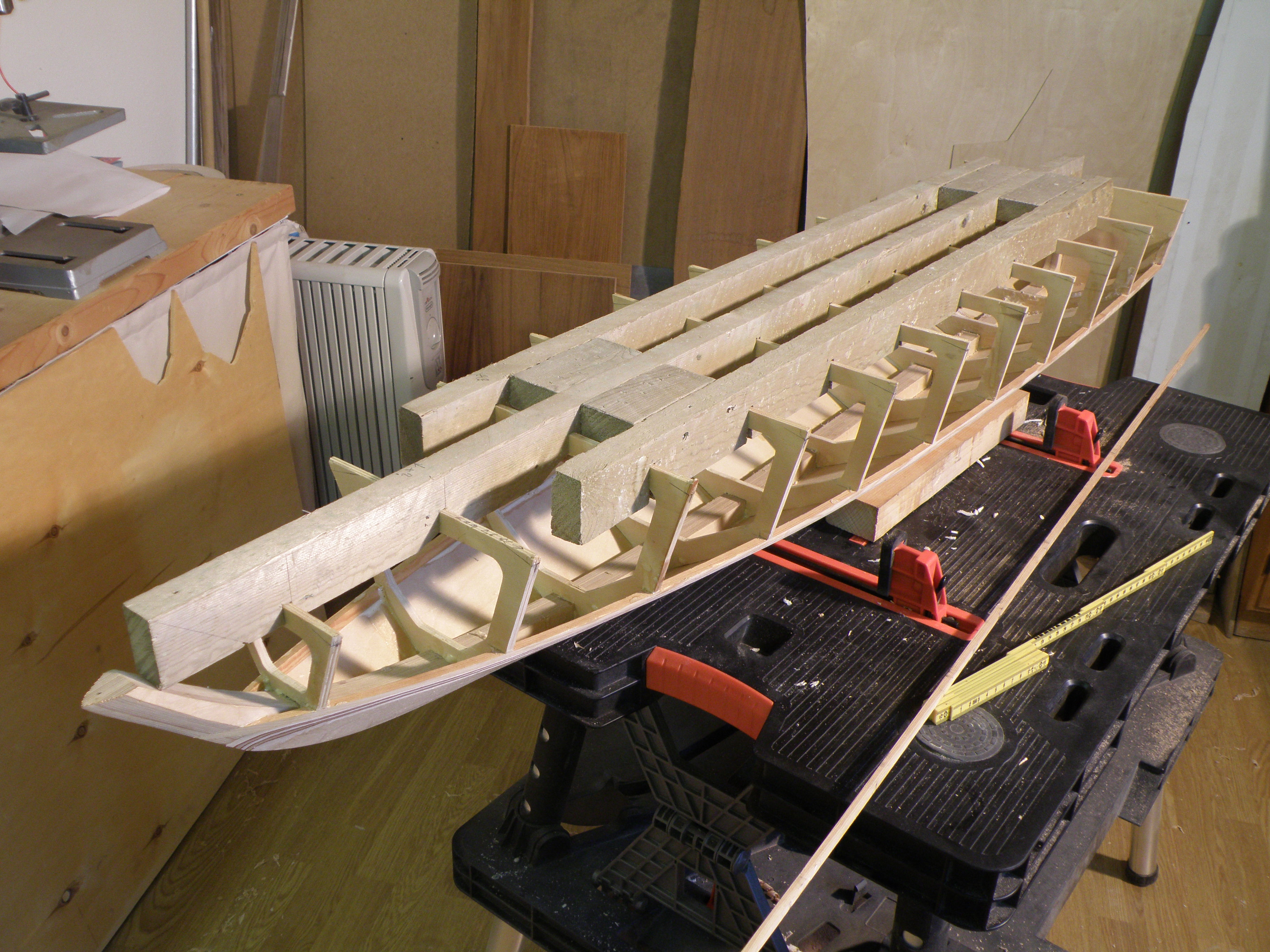

This is really the phase of small steps.
The keel and bottom chine seems to be shaped fine. Now comes the real three dimensional challenge for me: To create a beautiful line along the deck from aft to stern. I have no construction drawings. Only thing that does the job will be a lot of (very) carefull assessments combined with lots of carefull planing and sanding of the profiles untill my eye is satisfied.
This will take some time, because once I get to glueing the sides on the boat, there is no way back. It HAS to look as a million $$.
(And I dont accept much less than perfect results - failure is no option. It just puts extra wood in the stove) :S
I put a few pics in where the boat is turned over and the "stabilizing board" is removed. Some planing and sanding has allready been done.
The weight, as shown on the pics is 4.125 grammes. In respect of that, I expect to be able to keep the total weight of the complete hull well below 5.000 grammes. Maybe even about 4- 4.500 grammes?
Wish me luck, guys. :)
And PLEASE remember: Any advice is welcome anytime. I AM THE BEGINNER!
