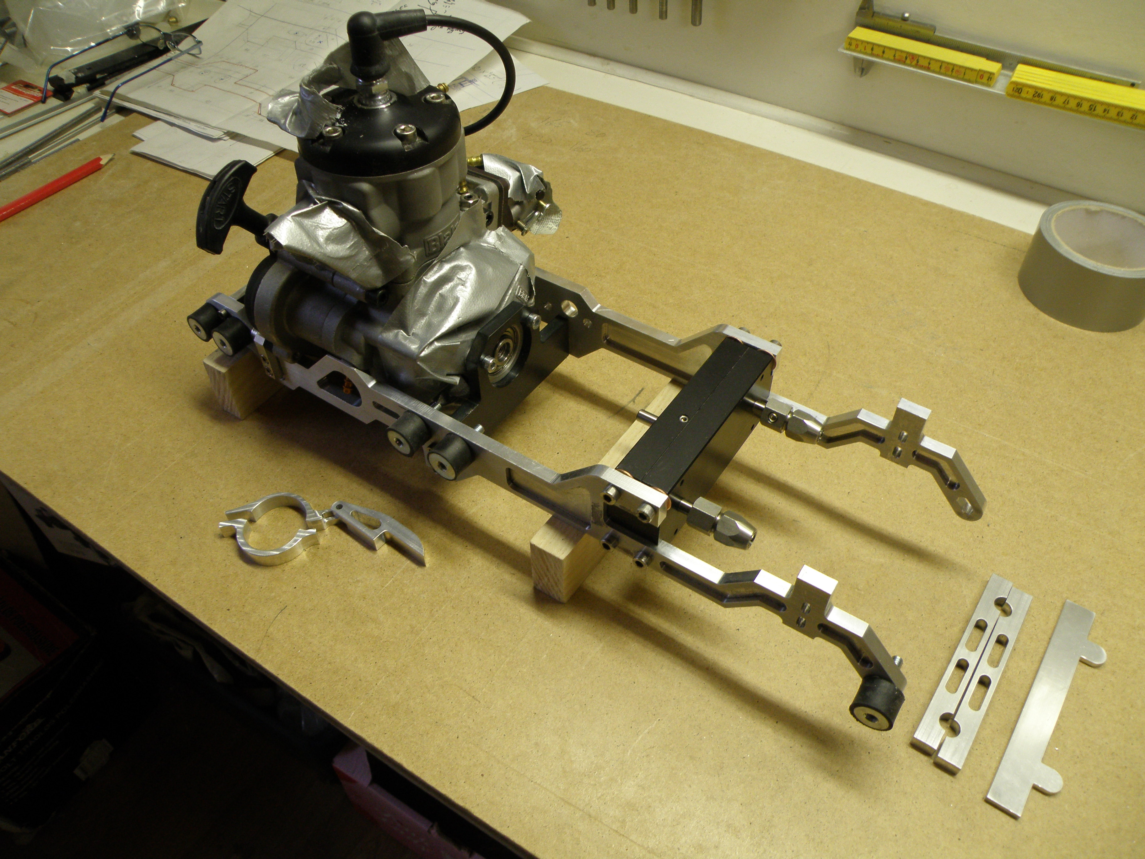

Dang Woody, it looks like that machinist knew what he was doing when he made those engine rails.
#20395
woody replied the topic: Re: My smokin' Cigarette.
Hi Steve.
Thanks. But I think it should be called an "engine frame", as the new (wooden) rails still is "in production". ;)
Designer: Yours truely.
Cad drawing: My son.
Producer: Steve Seebold. (Much recommended).
Thank you Steve and Randy. :blush: (That's me blushing).
I have a picture taken from a different angle. I hope that I can attach it this time.
Note the fittings, that are still not mounted: The "curly" parts to the left of the frame, will be attached on the frame as an adjustable support for the front part of the exhaust. The double bars behind the frame will be set up as adjustable support for the double drives behind the gearbox. The bar with the two bumps is meant to support two oilers above the drives. More drilling and threading is to be done first.
I hope you "get the picture". ;)
Lars
Added later: Forgot to say that the engine frame actually is designed to lower the engine (and the weight) as much as possible between the profiles in the hull. Compared to the original engine frame, the engine is now lowered 18 milimeters and will get to sit no more than 2 milimeters above the inside of the wooden keel.
