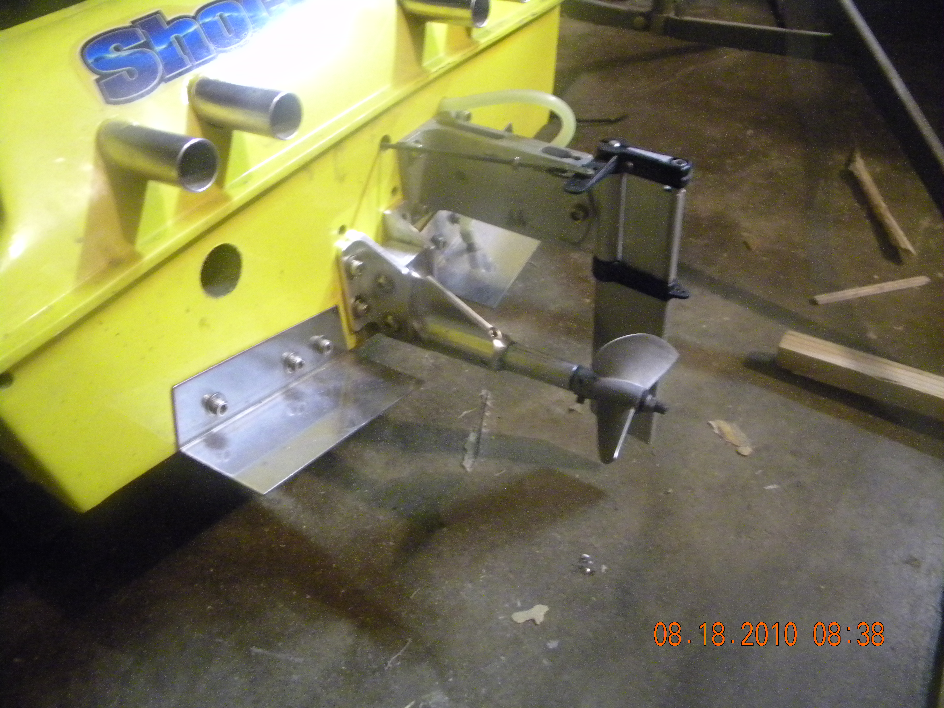

I put together a shockwave and it digs in something fierce on turns :angry: I bump the rudder as I enter the turn, let off, and throw HARD left to pull out of the turns!!! Any ideas :S Here's a vid to show ya what I'm talking about... Thanks Oz for the help loading videos B)
I thought ya see my setup as I walked by in the vid. I'm running a surface drive with an offset rudder. Pretty much the same setup as I've seen on y'alls boat. At slow speeds it doesn't do it... wide open, well you seen the results. :dry:

i had one (well still got it just dont run it any more)did the same thing.if i could see a pic. of the transom hardware i might be able to help ya

Will this do?

the pic. was great,thanks.what im going to tell you is what i did to mine and it did help it a lot.by no means im a pro at this for i am learning to.check your c.g. mine did best at 30% 16.5 from the transom.the rudder should be 2 1/2 from center of hull, i would say just behind the stringers but on that boat you have 6in stringers unless you moved them.the right trim tab has the water pick up in it for mine it caused drag.the leading edge of the rudder should be behind the trailing edge of the prop.the water pick up should be in the rudder(less drag). the prop looks dull, you should ballance it sharpen it and polish it.the 2 props that worked the best for me was a octura x472 and a x 670 both r 2 blades.check the strut it should be about 3/8in high from the center of the keel,also check the angle 0% to 1/2% should be ok.i used a dual rudder set up and it helped a lot but it had no water pick up in them. some will say a single rudder will be ok but i read in a book that a large boat(over 50 in)should use a dual rudder.i think top secert boats has a dual rudder set up with the water pick up in them.i used a spd system and made a water pick up in the rudder,it took some time but it did work. i think that should do it if you have any more questions please let me know and i will try to help ya. good luck steve (boatking)

Exactly 14" to back of transom :dry: The rudder I have on it has a water pickup already, so I'll shave the other one in the trim tab smooth. The rudder is in line with the rail, still at 6". I made my own motor mounts to fit. The only thing that is not set up like you said... the rudder is even with the prop :S not behind it. And I have the pitch kicked up about 1-1 1/2 degree to try and get the nose up. But even on a straight run, the bow doesn't get up out of the water. It's very small changes to get it set like ya said and try it. I'm running an prather 270 prop. Thanks for y'alls help... I see what it does this weekend.
