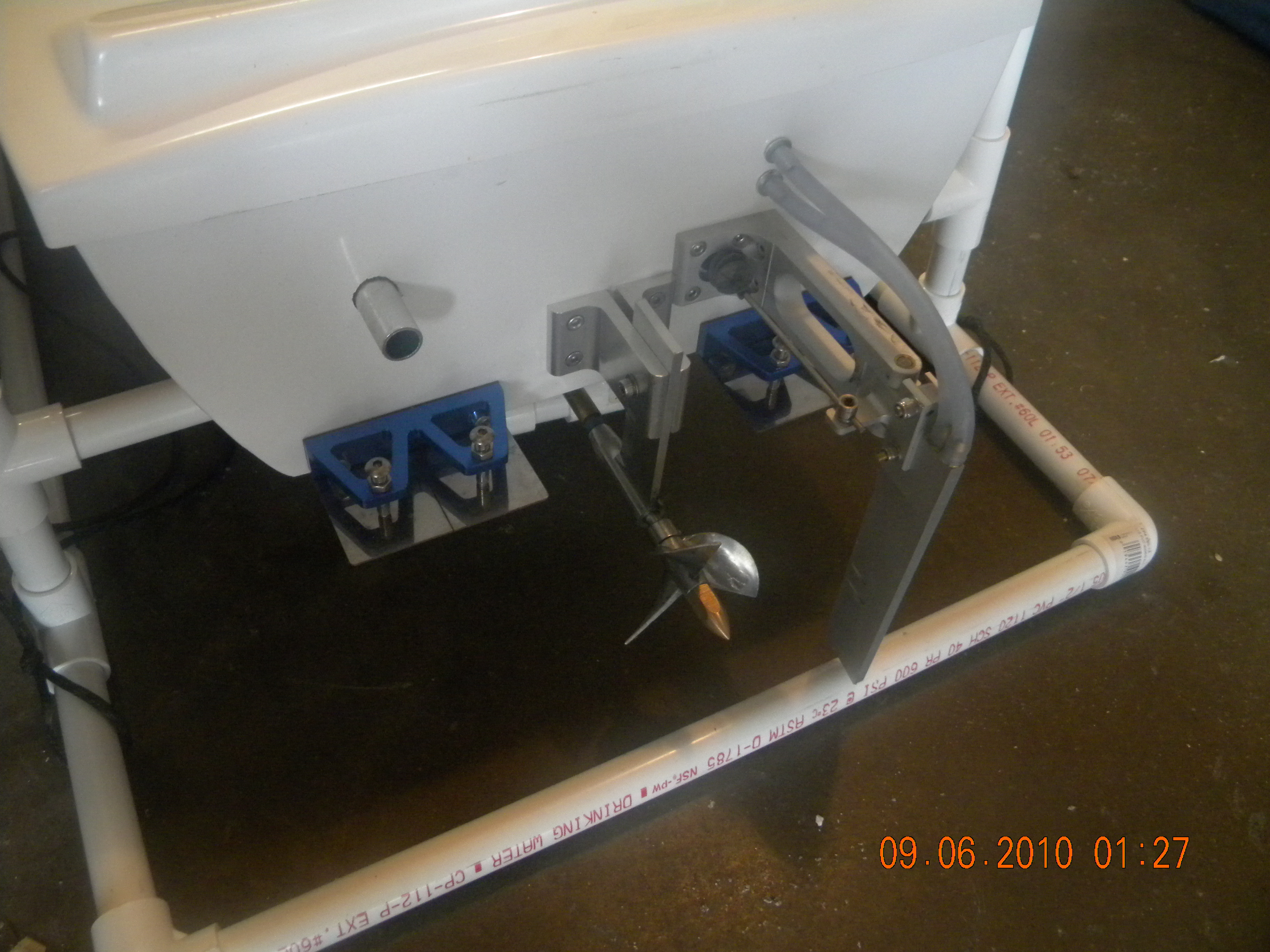

Finally got the Skiff finished... First run out was extremely squirrelly :angry: Angle was wrong on the prop... about 1 degree positive.. wrong answer.. went 1 degree neg and it worked much better :woohoo: I don't think I have enough rudder in the water though. Turns were scarey to say the least, took way too much input to get it to turn. But straight out it would absolutely FLY :woohoo: :woohoo: :woohoo: Nothing but prop and rudder in the water!!!!!!!! Loved It!!!! I took a pic of the back.. if anyone has any opinions on height, I would appreciate it.

Your turning may be getting effected by those trim plates?
From what I have seen in videos the skiffs roll right over on thier sides when turning!
I have never run trim plates on any of my boats, if balance and strut angle is right they shouldnt be needed.
Most experienced boaters will tell you that trim tabs are just an add on to fix bad setups of the hull.
Even my little 41inch mono with a 26cc in it spent more time out of the water than in it during runs but still no trim tabs.
Of course you dont have to take my word for it, as Im only a home builder.
Just trying to help. ;)

Don't worry Chad, it's nothing permanent, just wanted to try it B) I have the tabs set a little neutral right now so I don't think they're doing anything anyway. It heals fine, I just have to slow down quiet a bit before the rudder takes effect :dry: That's what makes me think it not set deep enough. But don't worry about the prefabbed hull stuff... I'm about to start a work of art I know you'll appreciate :woohoo: CAN YOU SAY 85CC TWIN CYLINDER? :woohoo: :woohoo: :woohoo: :woohoo: :woohoo: :woohoo: :woohoo:
