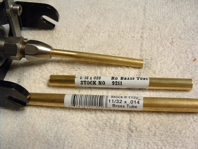

just wondering how much space you have between the collet and the stuffing tube.

You may want to tighten up the I.D. of stuffing tube so cable has VERY minimal space around it ?
For years now have used the .029" wall K&S brass #9211
It has an I.D of @ .252/.254 with most persay 1/4" cables being @ .242/.245 gives give or take @ .010" internal clearance.
Grease or oils stays put really well because it has no where to go :P
Cables don't whip and near impossible to knot up :woohoo:

baumer65 wrote:
Less than an inch.

Thanks Scott. Where can i find the 9211 tubing?

baumer65 replied the topic: Re: S520 twin powered Expresscraft Cat video
wow so it's binding up inside the tube,i haven't had that happen.

Boss 330 wrote:
From K&S dealers who sell there product. Under that part# it is a 36" stick and they come in tubes of 5 as well.
Over on Jims, Chris Hoffman AKA: Dasboata has them for sell as well.
Woodie,
Yes well known a slight S bend within stuffing tube helps lessen cable whip.
Having a tighter fit between cable and tube has the same effect on lesser whip but does a far better job in preventing knot up issues because of keeping cable straight and true down it's entire length ;)
