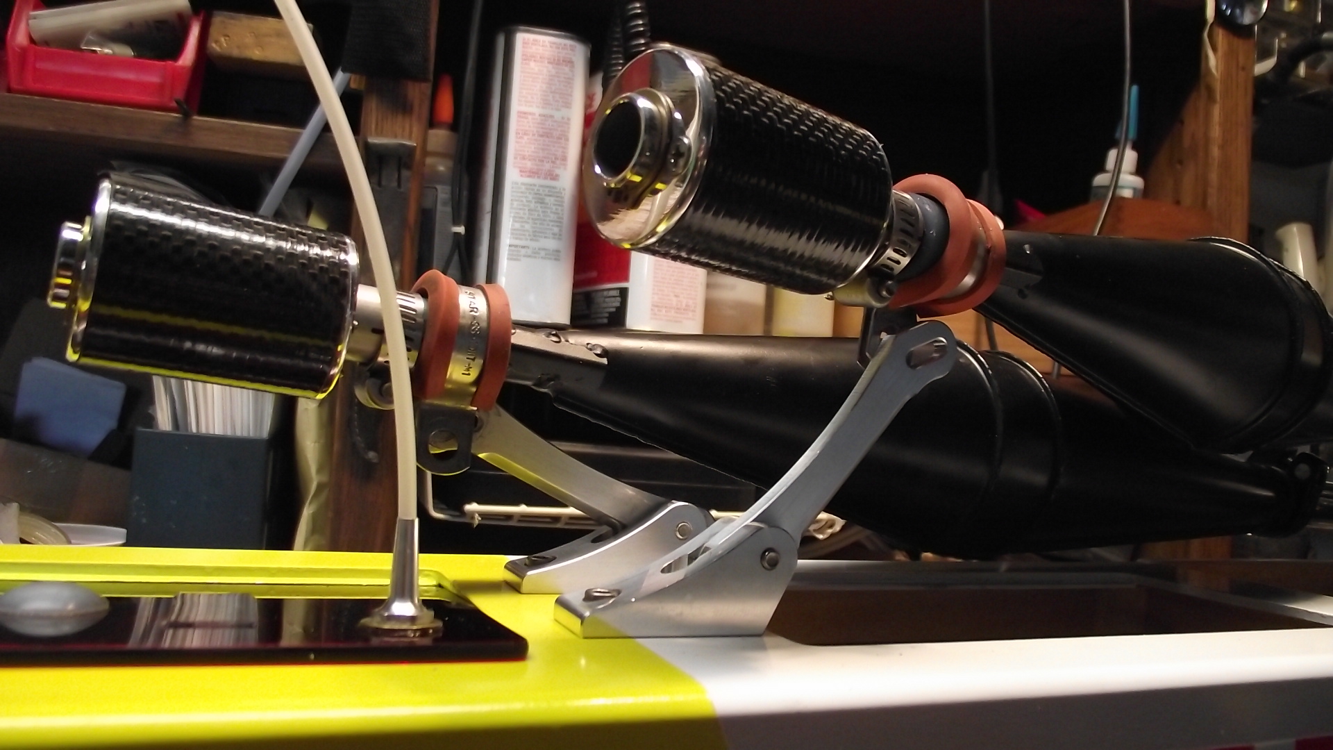

Scott replied the topic: Re: Inline twin rigger .... O' so close
After many pipe mount options explored, settled on 2 RCMK swing arm mounts mounted between box compartments. Due too way they mounted had to straddle the bulkhead having one of the 2 screws on each go against bulkhead on a pair of 3 1/2" support struts. One placed each side of bulkhead too distribute load and hopefully keep mounts intact and durable.

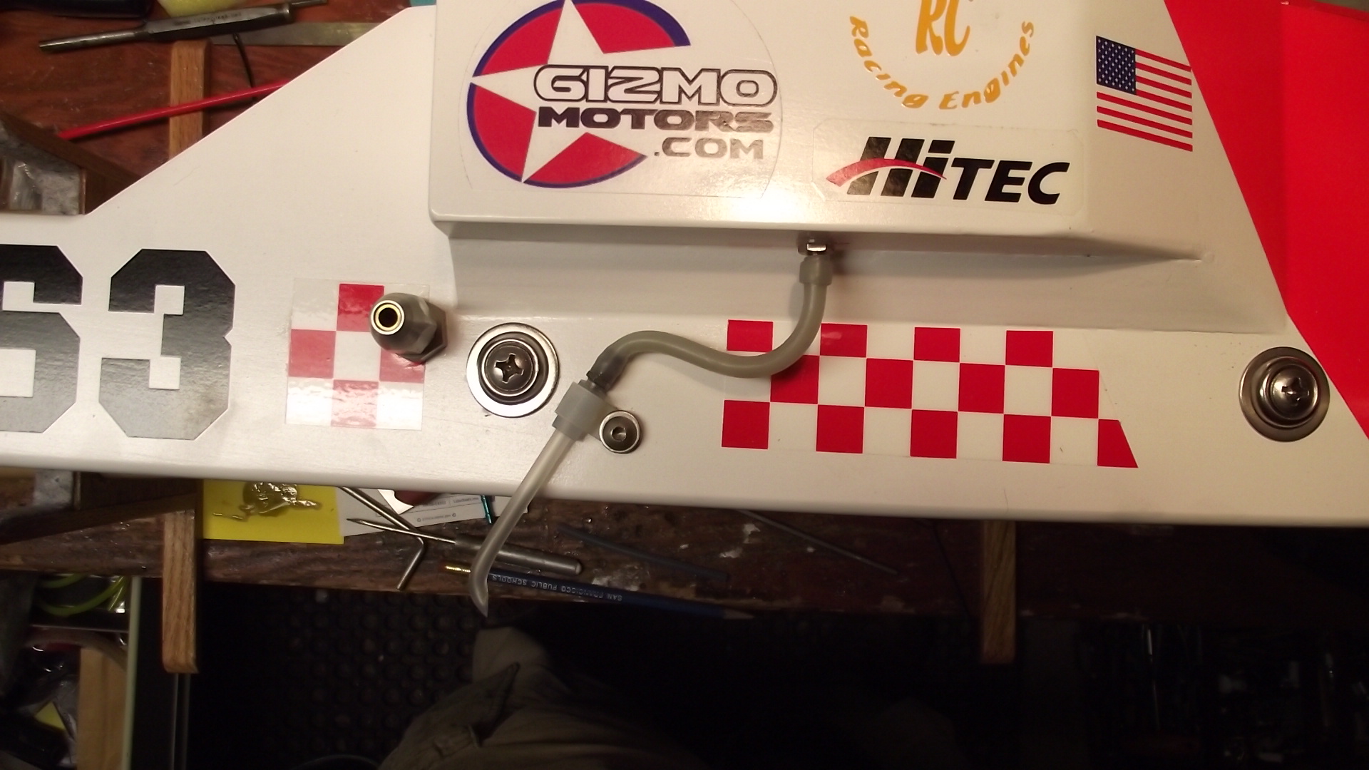

Figured out my crankcase cooling .... forget trying to use water cooling cylinders upsetting flow rate between jugs and find a fresh source :woohoo:
Drag tube off side of tub having only the tips last 1/8" in the water.
If drag on tube is excessive ? no worries tubes semi flexible nylon and will just bend backward under the pressure ending up shallower yet :woohoo:

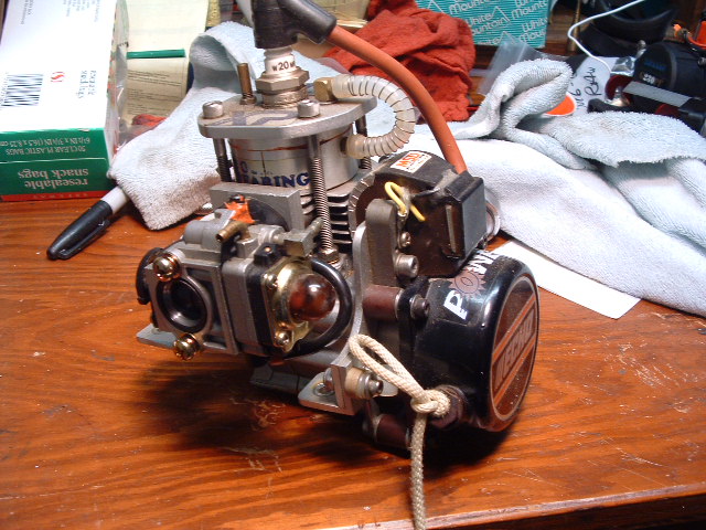

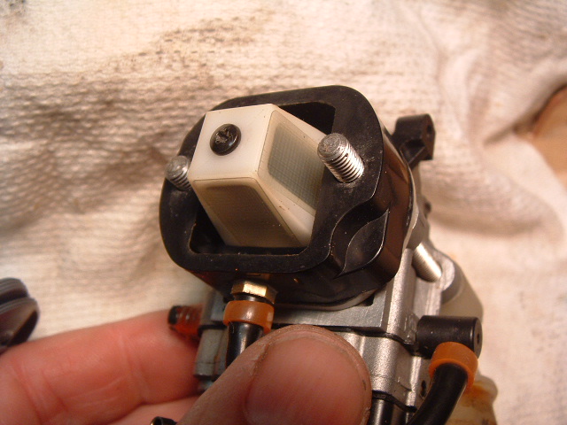

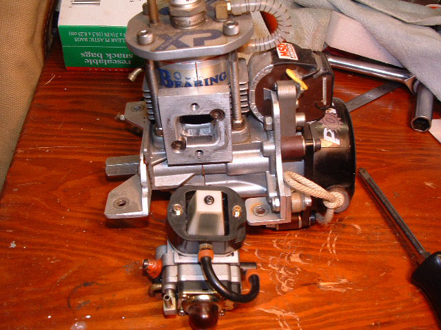

Doug,
If we raced GX class engines here would pursue playing with reeds once again.
I have built some real flame throwers in years past built as a test of my skills that i could ... sure enough, they did and quite well at that.
This one done near 15 years ago !!
This started life as an ECHO SRM2500 .... single coil & flywheel swap off a Mariyama trimmer engine, Pyramid reed block from a Homelite Super XL chainsaw, Special built Boysen fiber reeds, Modified WYK 33 carb, Custom head button.
Case induction was Piston port AND case induction via a passage from floor of intake tract into lower case. 2 eyebrow boost ports adder on roof on intake tract.
Engine ran like stink !! ... but did not last too long because port area was so chopped up offering little ring support chrome went away pretty quickly.
It did however twist up near 17K and had tons of torque .... O'well, it was fun back in the day.
