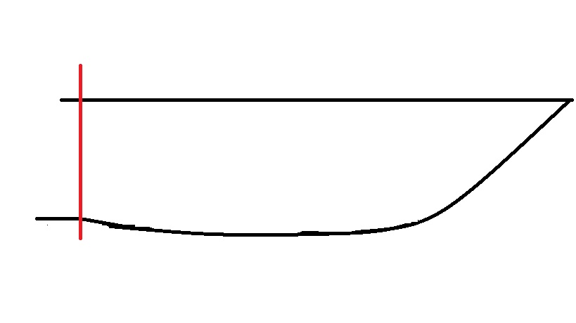

BrandonC replied the topic: Re: brand new hull up and comming
What type of engines are in that boat? No. of Cylinders, Horse power, displacement etc?
As for the handling and so on of MGB's, do the techniques used in full sized ones work on the models...as Woodie mentioned the steps may make a MGB unstable. Some Regal speed boats boats have a "bulge" at the front of the hull. The theory is that when the bulge rises out of the water, the section of hull behind the red line already out of the water. Basically are measures such as steps and bulges etc necessary for MGBs?
A hastily drawn sketch using Paint (not the usual Cadd standard of perfection!!! :laugh: )
All the best,
Brandon.
#16868
Woodie replied the topic: Re: brand new hull up and comming
Hi Brandon.
About what engine to use, there is no best answer. It's up to boaters themselves to get the best of this boat.
Thanks for the drawing. :) I will print it an build a new boat now! :laugh:
No, really. I understand what you're saying.
As for the steps, I really think they have to be reduced on a MGB. We agree on that.
Concerning the "bulge" you are right too. None the less I am building my Cigarette with a slight bulge along the front part of the keel line. This is a compromise that I hope will make it able to run stable in the choppy saltwaters, and still be able to speed very fast on flat water. Hoping to avoid that ugly chine-walking...
It's all about hydrodynamics. My experience as a former boat builder helps me some of the way, but with your ongoing education you will probably get to know better.
Maybe some day you will design the perfect MONO MGB hull?
#16869

gasworx replied the topic: Re: brand new hull up and comming
the cnc work comences on the 8th of aug for the hatch section.
the steps are so large in the full size machiene to prevent suction from chop and when the boat re enters from a jump.
the problem with a bulge in the bow section is that directly behind it suction is created and alot of turbulence for a surface prop. it is best to have all retern edges as sharp as humanly possible to provide s good release from the water, look at the tail section of a surfboard a tail with a C section tail will be slower than one with a [ section. also planing surfaces should be as flat and as perfect as possible, remember the more hull in the water the slower the boat.
