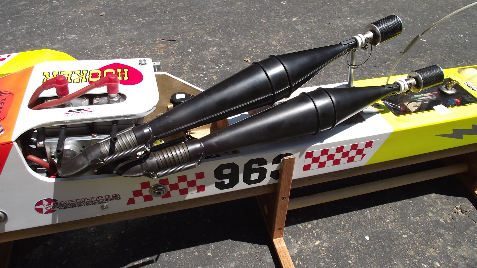

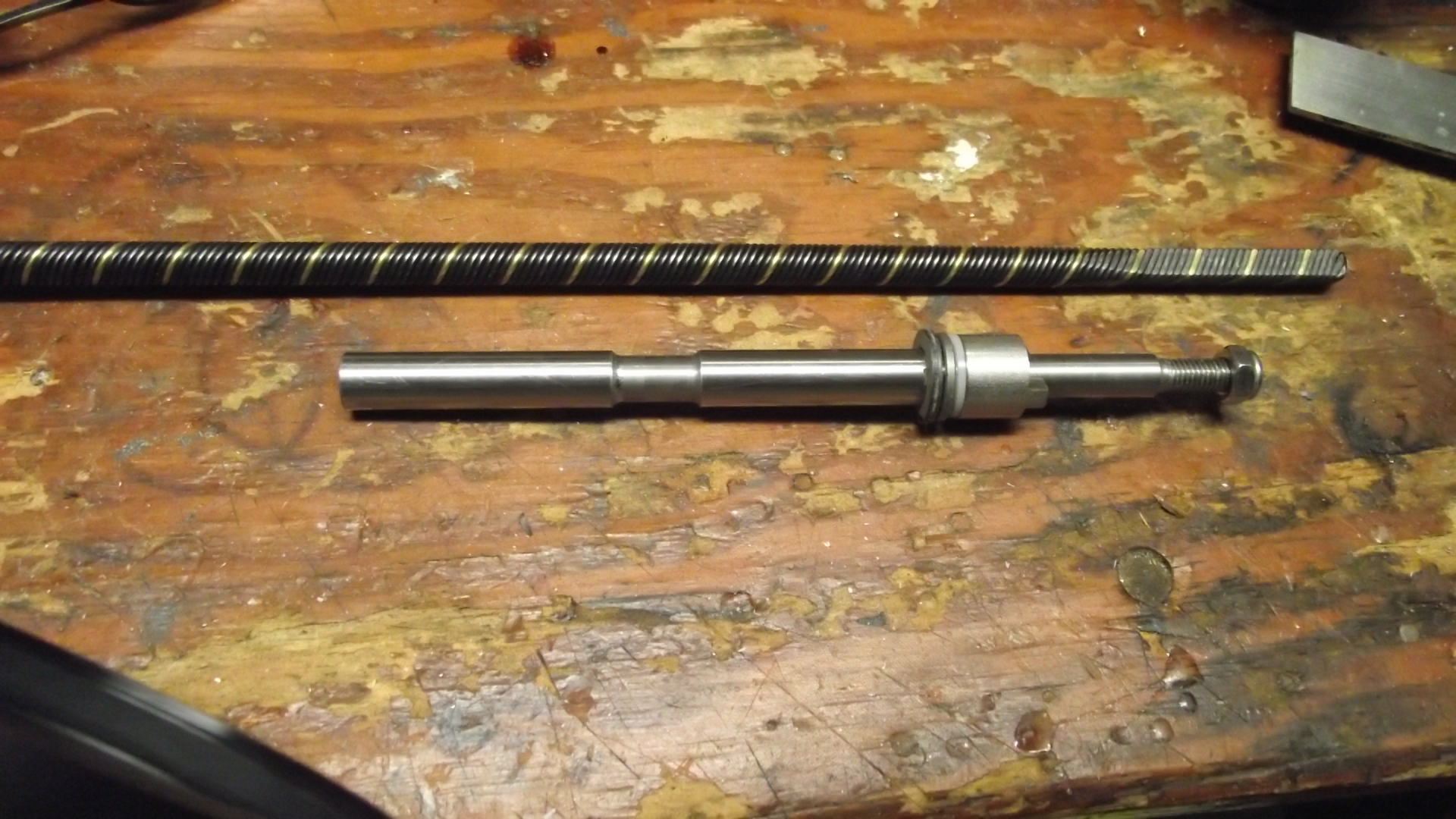

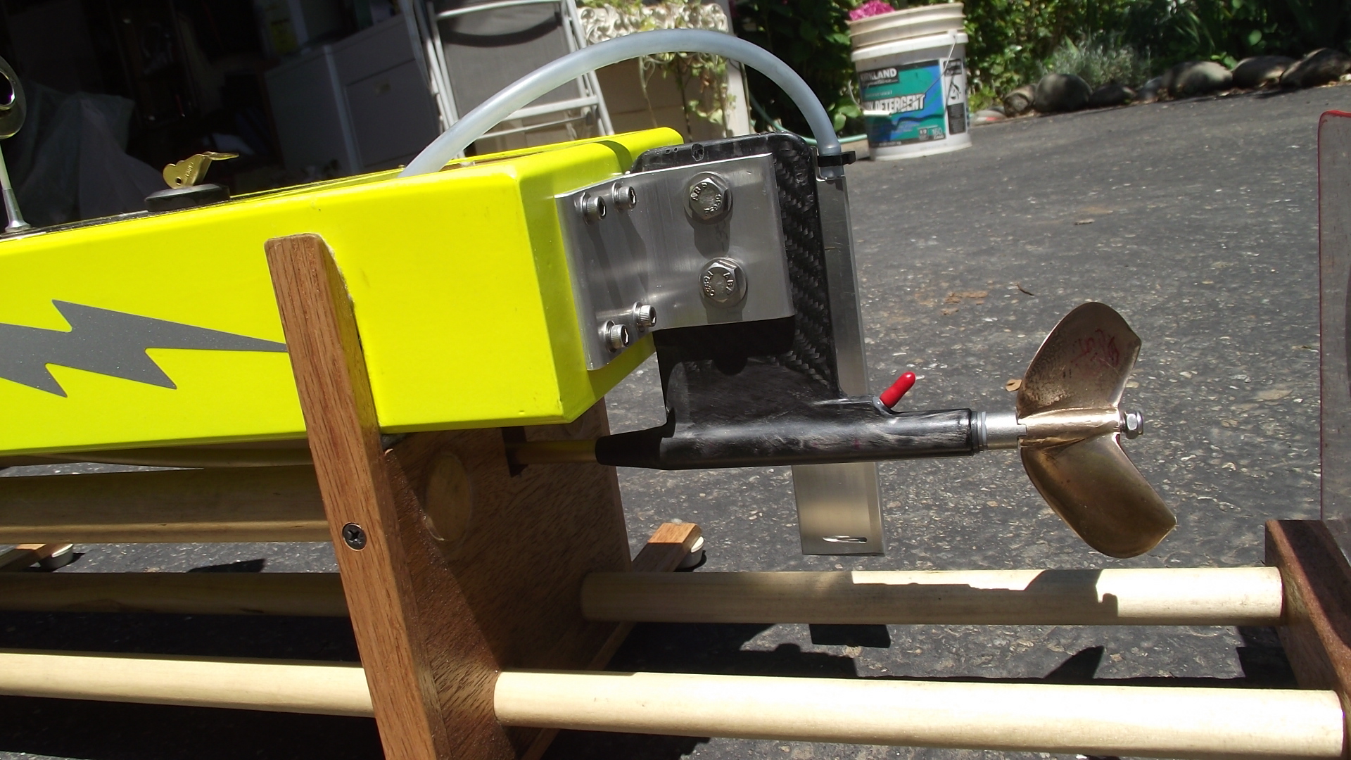

Major updates on entire drive train and more ... :laugh:
* Carbon fiber strut taking 8mm prop shaft and MUCH beefier overall.
* MTC 8mm prop shaft stepped to 1/4"
* H.D. golden strand Suhner square end drive cable.
* Custom Hot pipes & manifolds
* Reworked HMH rpm pipes with hot pipe flanges attached allowing pipe swaps on same manifolds.

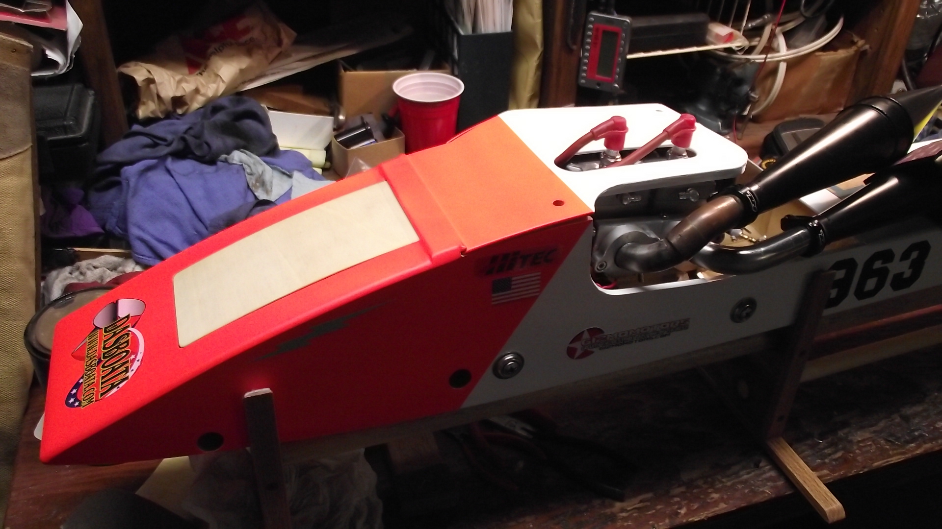

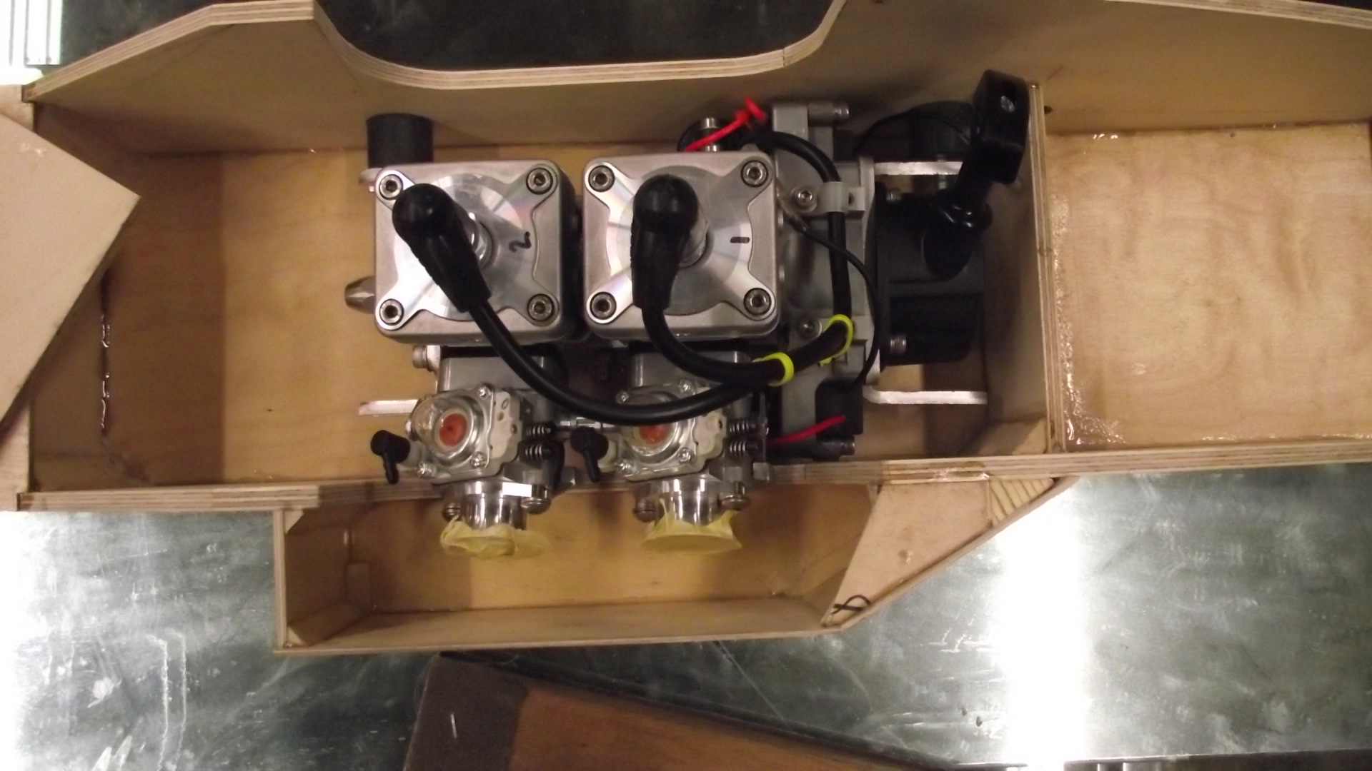

Scott, is the back of your carb cover closed? Are the carbs pulling air from the tub?
#17087
Scott replied the topic: Re: My inline rigger gets run ... O'yea we have ignition !
;) Thank you Marc ...
Yes the boxed in area is covered all sides except that area facing tubs interior.
Airflow feeding carbs comes in along exhaust side and from behind ( For Now )
* Am waiting on a few NACA ducts and will be placing one within the forward tank access cover so I get "Pass threw" air which hopefully may find me even more power / consistency.
