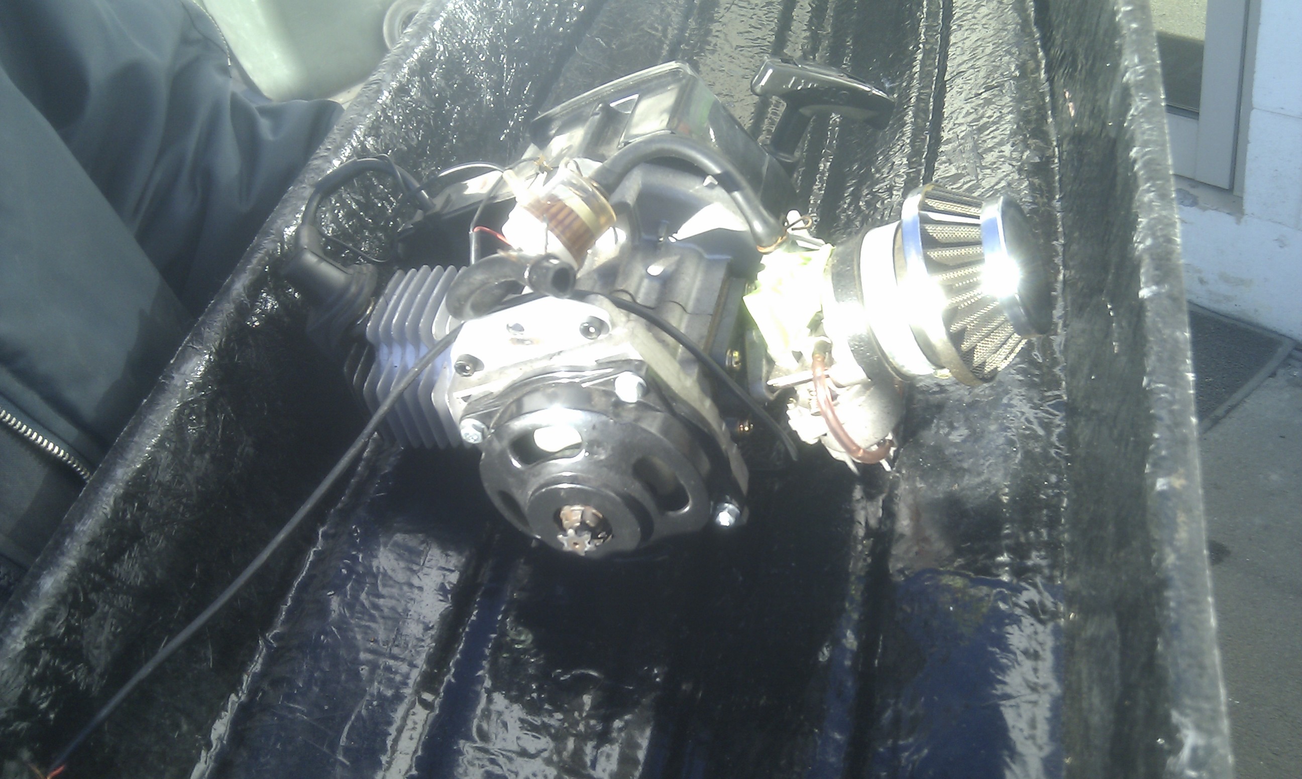

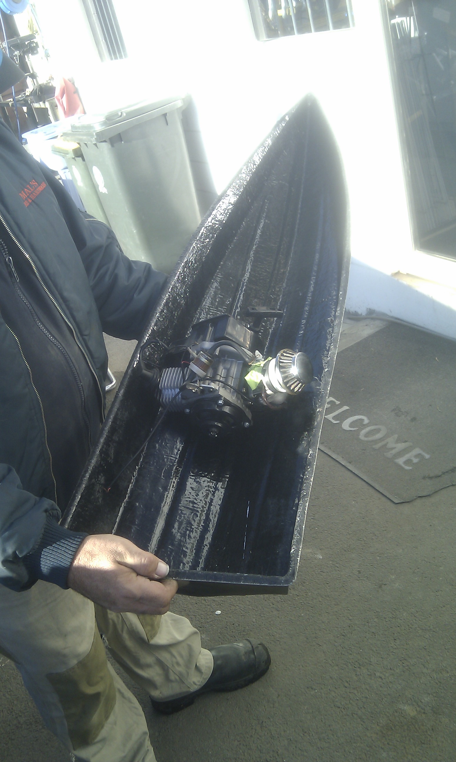

Robdog600 replied the topic: Re: 52"mono 49cc motor? input please
as you can see plenty of room for plenty of power

dazzido replied the topic: Re: 52"mono 49cc motor? input please
Hi have you thought about cooling the engine?by look of it you will need to make it watercooled.I had the same engine but ended up not using it due to loads of issues,will be good to see how you get on and solve the problems you will come across.Keep us posted as the build comes on.Regards Darren

Woodie replied the topic: Re: 52"mono 49cc motor? input please
I tend to agree with Dazzido. Cooling can be a problem.
But if you keep the engine bay open, it might work with the air cooling.
Worse than this, I think, is how the exhaust port is placed. As I see it on the photos it faces directly to the bottom of the hull. This means that you have to angle the motor at least 90 degrees to get space enough for the exhaust tube. This also means that you will have to give up that fancy air-filter. In a MGB it should'nt be needed anyway: No dust on the water.
