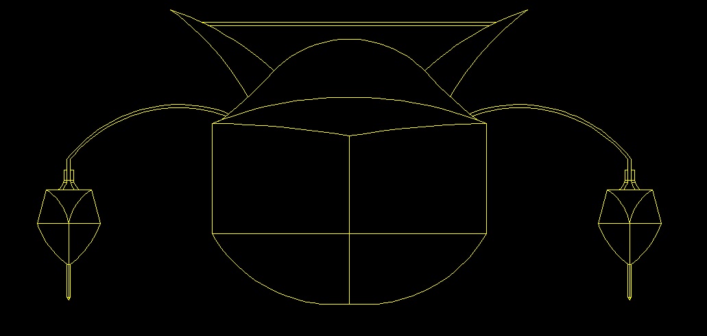

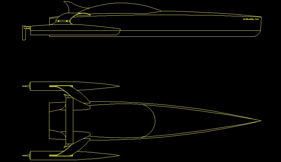

Hi Guys,
Thanks for the kind comments. This will be a challenge but theres no fun if it aint difficult. I did up a drawing of the front on view and revised the side on and top down view. The design of the connection between the main hull and pontons (cant remember what its called) has changed to allow a bit of adjustability. Im going to keep the ears and yes that is a wing between the ears. This will be adjustable aswell to help keep the nose down a little when the chop gets up.

I've got to the drawings of the internal ribs out individually. Hopefully the build will start next week sometime. :) :)
All the best, Comments and suggestions welcome.

Woodie replied the topic: Re: New Build
Hi Brandon.
A rounded bottom? Looks good, but impossible to do with a sheet of plywood.
But I have an idea: Why not fill out the spaces between the profiles (spants) with blocks of foam. Then shape them on the outside to make the right shape of the whole bottom. After that you could glue your own 3-dimensional plywood on by using strips of fx 0.8 mm wood. Use 4 or 5 layers laid diagonally for each layer. Angle about 45 degrees to the chine.
Inner layer: Use a glue that does'nt melt the foam. Other layers: Use epoxy glue.
Afterwards you chop out the foam, and sand the bottom to smoothness. I guarantee you a bottom that will be superstrong.
(It's a lot of work).
#16972
BrandonC replied the topic: Re: New Build
Woodie,
I'm going to use door skins to skin the boat. They are around 3-4mm thick and quite flexible and I'll steam them if needs be to get them to fit nice. Also the ribs inside are going to have the exact profile required..I'm being quite fatidious in their design (it took nearly an hour to do up the transom alone which is the simplest one of them all). As the ribs will be 9mm thick I'll use panel pins (very small nails) to tack the door skin in place before glueing. So it should be alright....we'll see next week!!! :woohoo: :woohoo:
Brandon.
You can bend plywood, and you can twist it.
But you can't bend AND twist, and that is what you intend to do. No matter how thin the plywood is, it's no-go. Just try the same thing with a piece of paper.
But give it a try. Maybe I'm wrong. ;)
Woodie,
I understand what your saying. I didn't state this earlier but the skin will be put on in strips between the ribs. So I'll start at the top and go down bending the wood around the bottom of the ribs rather than lenghtways along the boat...don't know if it makes any difference or even if it is correct but its the only way I could see to skin the boat.
Brandon.
That's a kind of solution. But in my opinion much harder to do than what I have suggested to you.
My solution is'nt easy either. But I promise you that it's less frustrating and gives a much stronger and pretty result.
