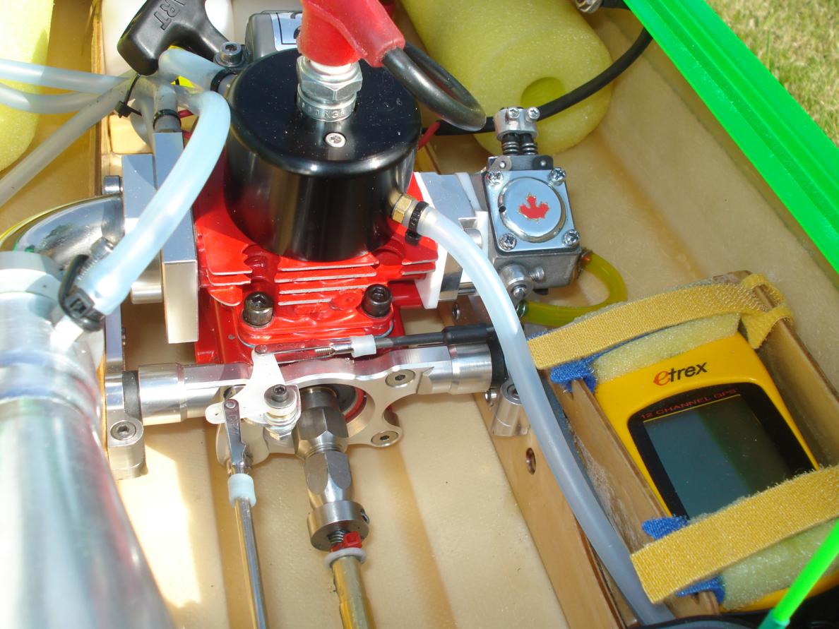

OK as you see i did a lot to my 48" wildthing . I got the primer on and the red paint on top/ bottom/side in back and the front is just gray primer still looking into what color to use in front and the Stripe to put in between the two color .I carbon fiber the back and half the bottom where the red is and fiberglass the rest also add carbon fiber where the engine floor still need to carbon fiber the side on engine rail .Got the CY 26cc motor add the Aluminum engine mount & clutch system .Here some picture of it

Canadian Hot Rod RC Boats replied the topic: Re: started on my 48" wildthing
Nice project
I use those mounts on a few - I mount rear mount other way round (looks upside down to me) might be hard to get your engine low enough in back with them like that
Just thought I would meantion it - I'm sure that way will work just fine
#17615
kennyrach replied the topic: Re: started on my 48" wildthing
yes u are right about the mount it just that way for me to breaking in engine and use the bottom hole to hold the engine onto the engine stand .Yes the engine mount from .HOR racing is nice but i still waiting for the bell from them .Nice set up u have there
