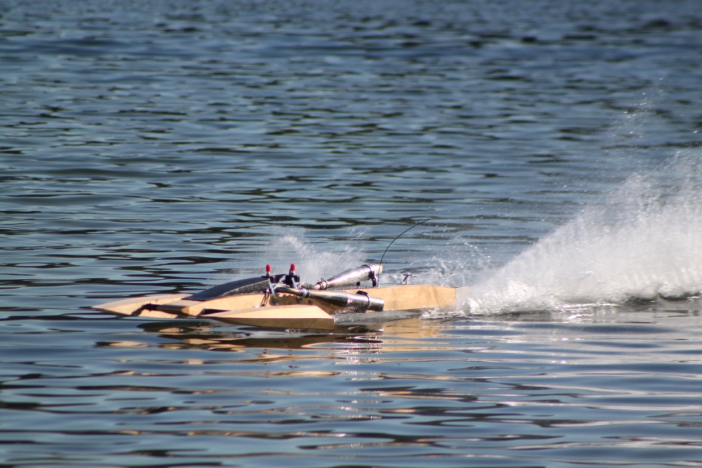

Hi guys,
The first test runs were quite nice. What a feeling!!! After few rounds I had clacking knees. Wow...
Until now I didnt assamble the rear sponsons. I used an ABC 3317-2 with round ears, which are very important for a smooth run. The same prop without round ears always kicks her ass out of the water...- Not so nice.
Now I have to optimize same small building problems during winter time and then we will see, whats possible in spring!
Right now no speed test but this was not important for the first runs.
Over all I'm very satisfied with this FF-rigger!
Greetings
Johannes

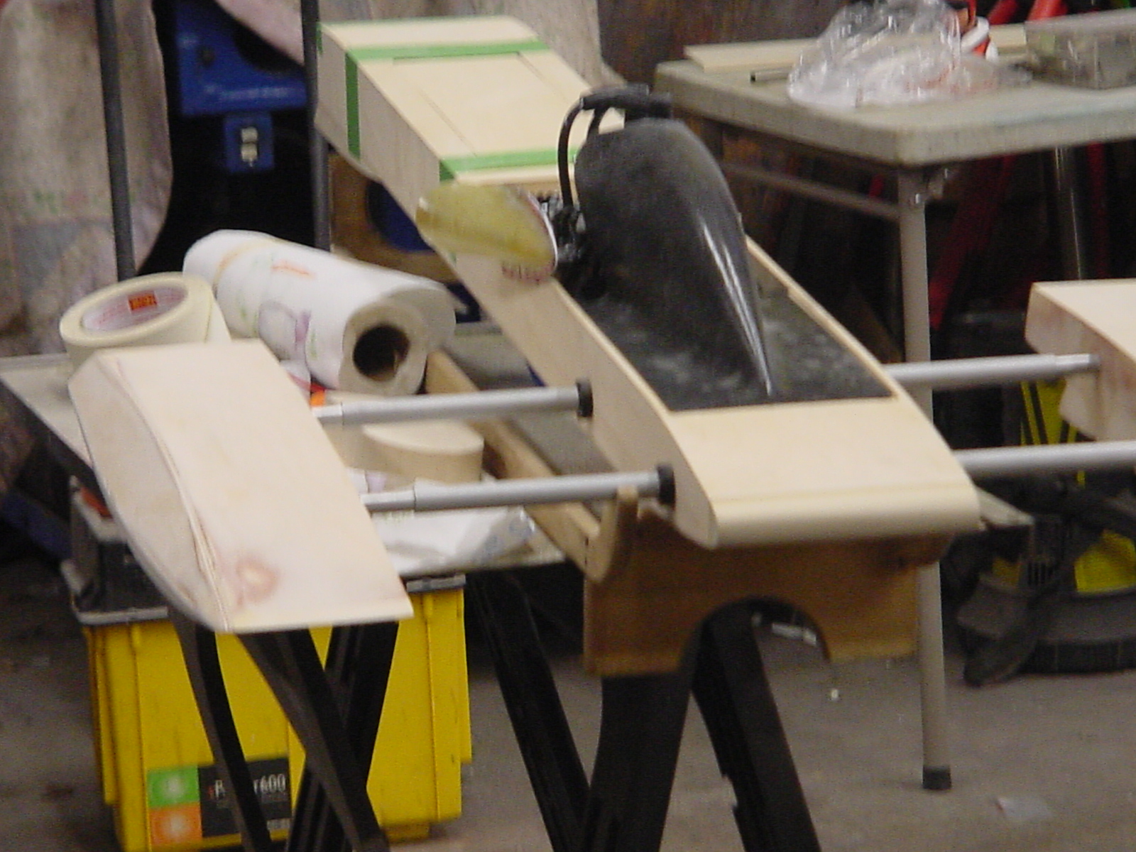

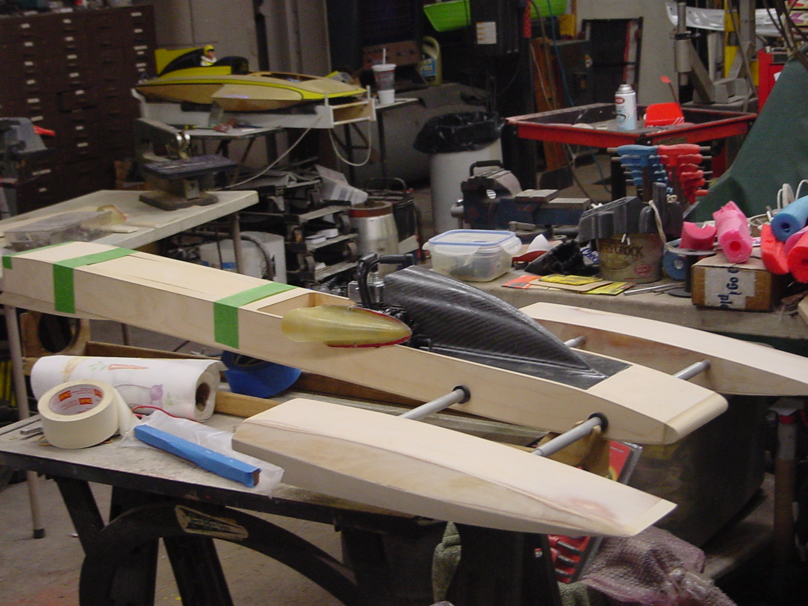

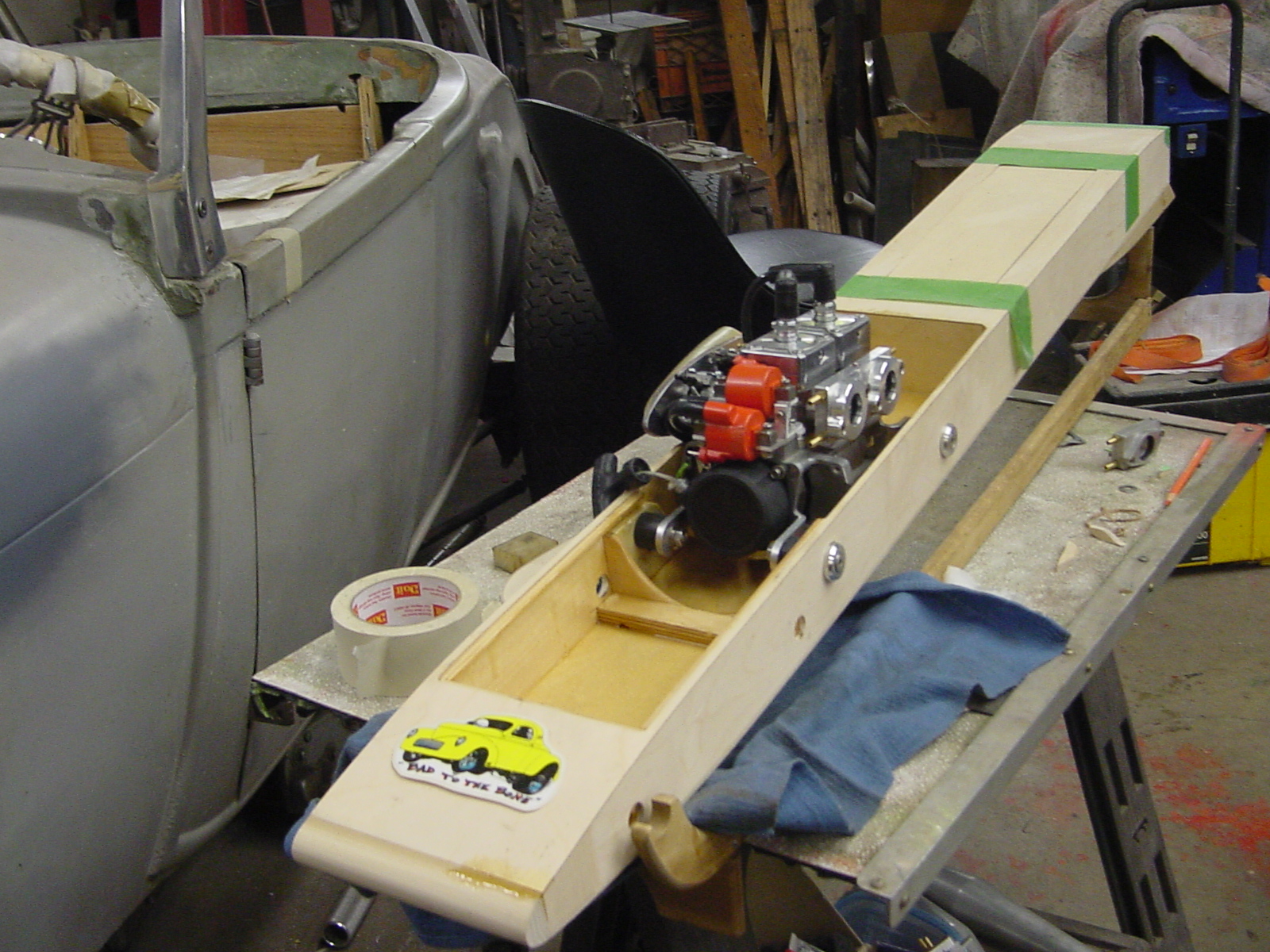

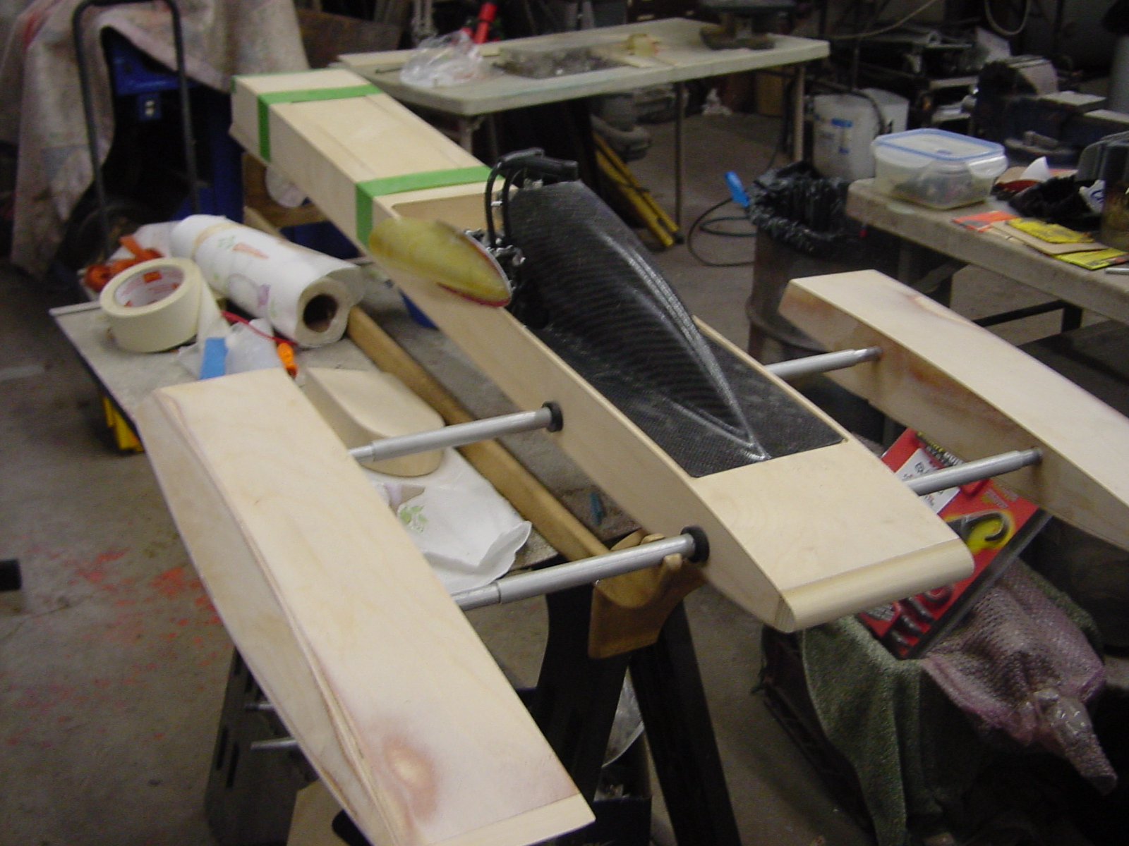

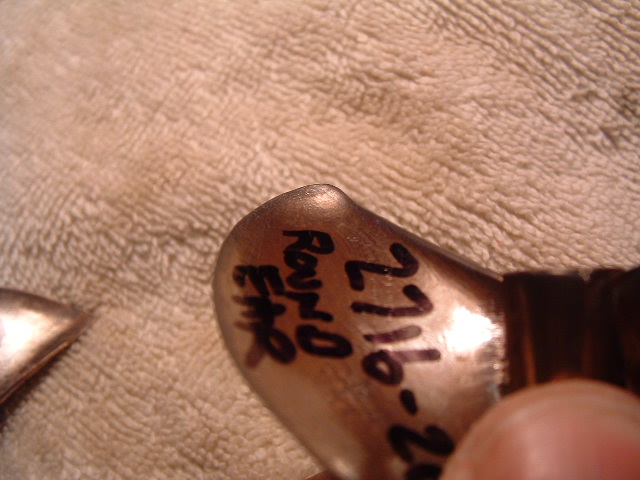

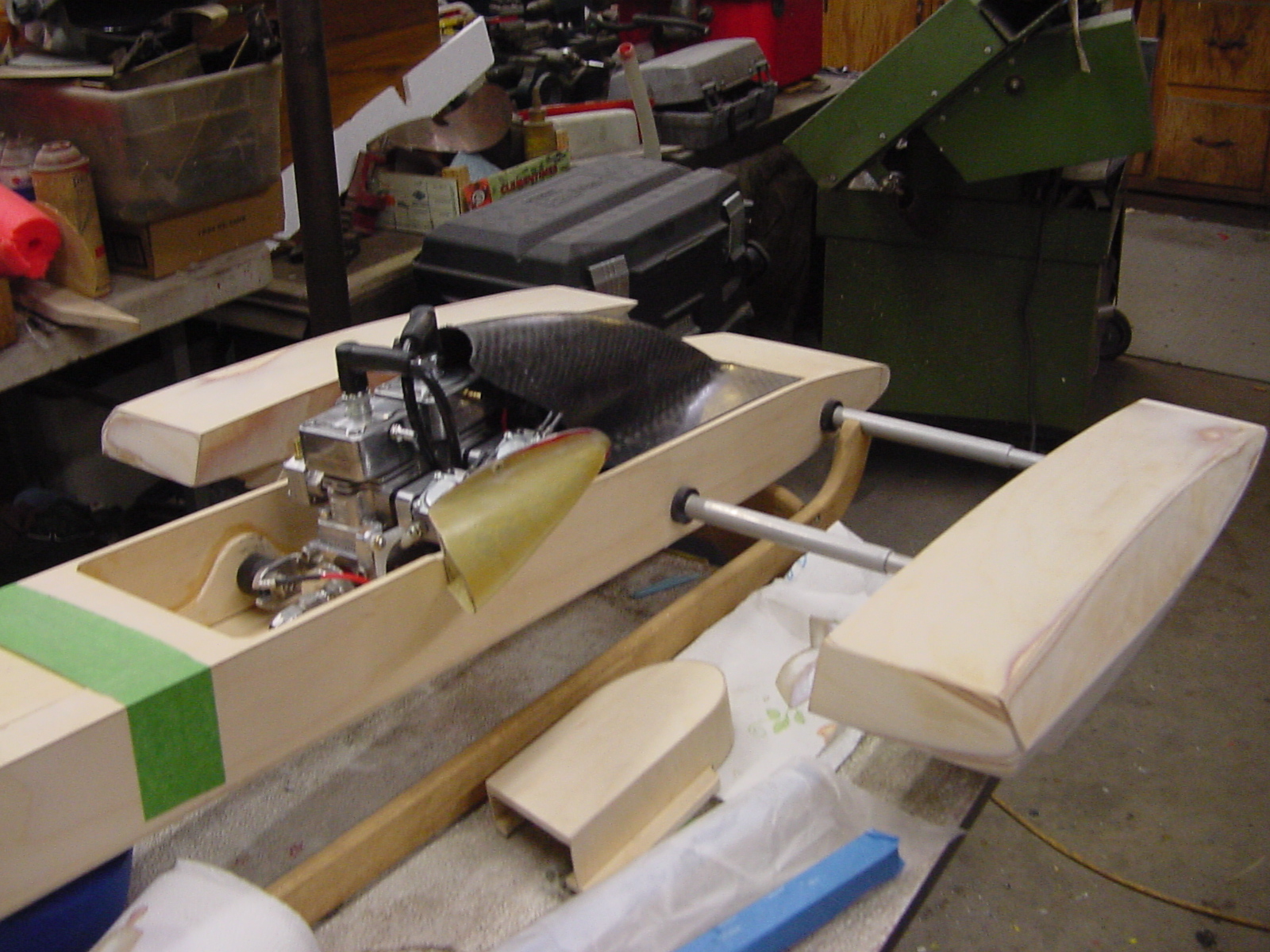

TRICK RC replied the topic: Re: Inline FF-Rigger
[attachment:4]C:\fakepath\DSC00001.JPG[/attachment]
LOOKS GOOD > HERE is pic's of the 1 I am building.
Rick Reisinger

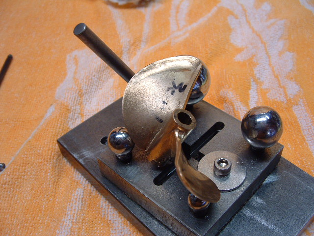

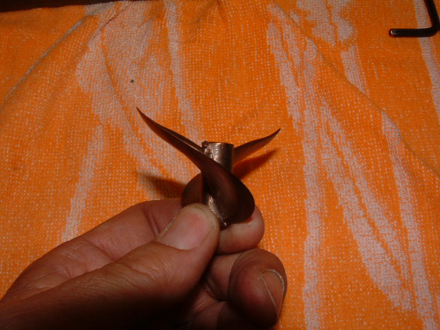

Scott replied the topic: Re: Inline FF-Rigger
Backcutting and rounded tips for starters ....
Then on a cupping block increase the camber angle of blades outer 6-8 mm of working face from tips down @ 1/3 of the way to leading edge.
SEE this article: www.modelgasboats.com/Voodoo_Cupping_Tool/
On my twin had best luck with the ABC 3018/2 heavily cupped with reduced lift mods.
#19603
Hannibal replied the topic: Re: Inline FF-Rigger
Hey Scott,
thanks for your support.
The article is really interesting and very easy to understand. I didn't know anything about a camber angle before...
I'm going to buy the voodoo-tool. I have already experience how to sharpen and weigh heavy a prop so I will try to do the cupping with the tool by myself.
So you had the best luck with a 3018/2. Sounds quite small. So I will do the cupping at my 3216/2 first. At the same time I will prepare a 3018/2 in parallel to see how it works.
