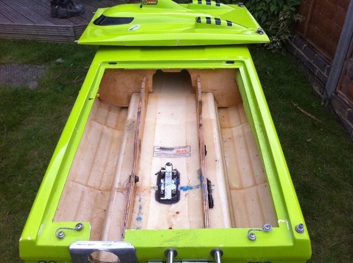

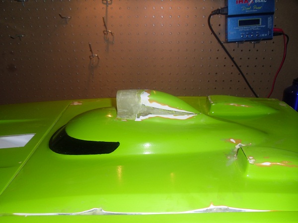

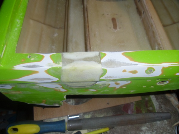

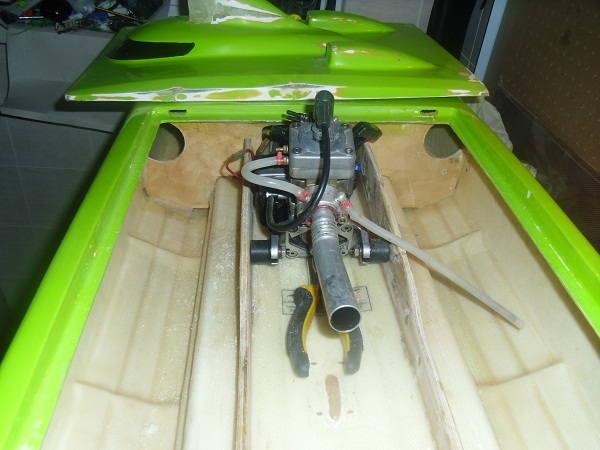

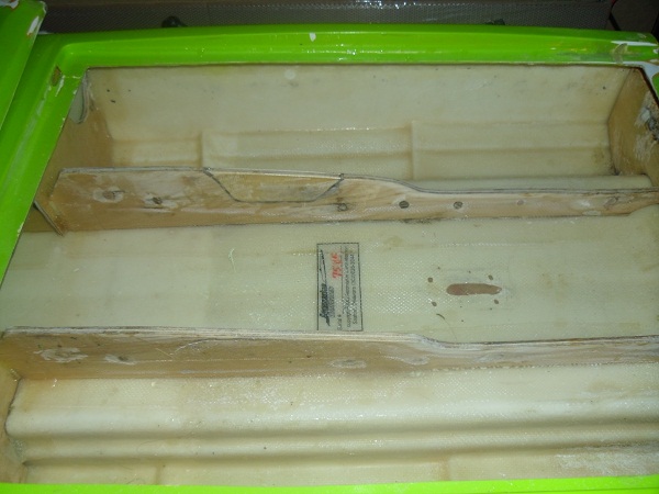

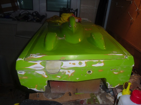

Hi Guys

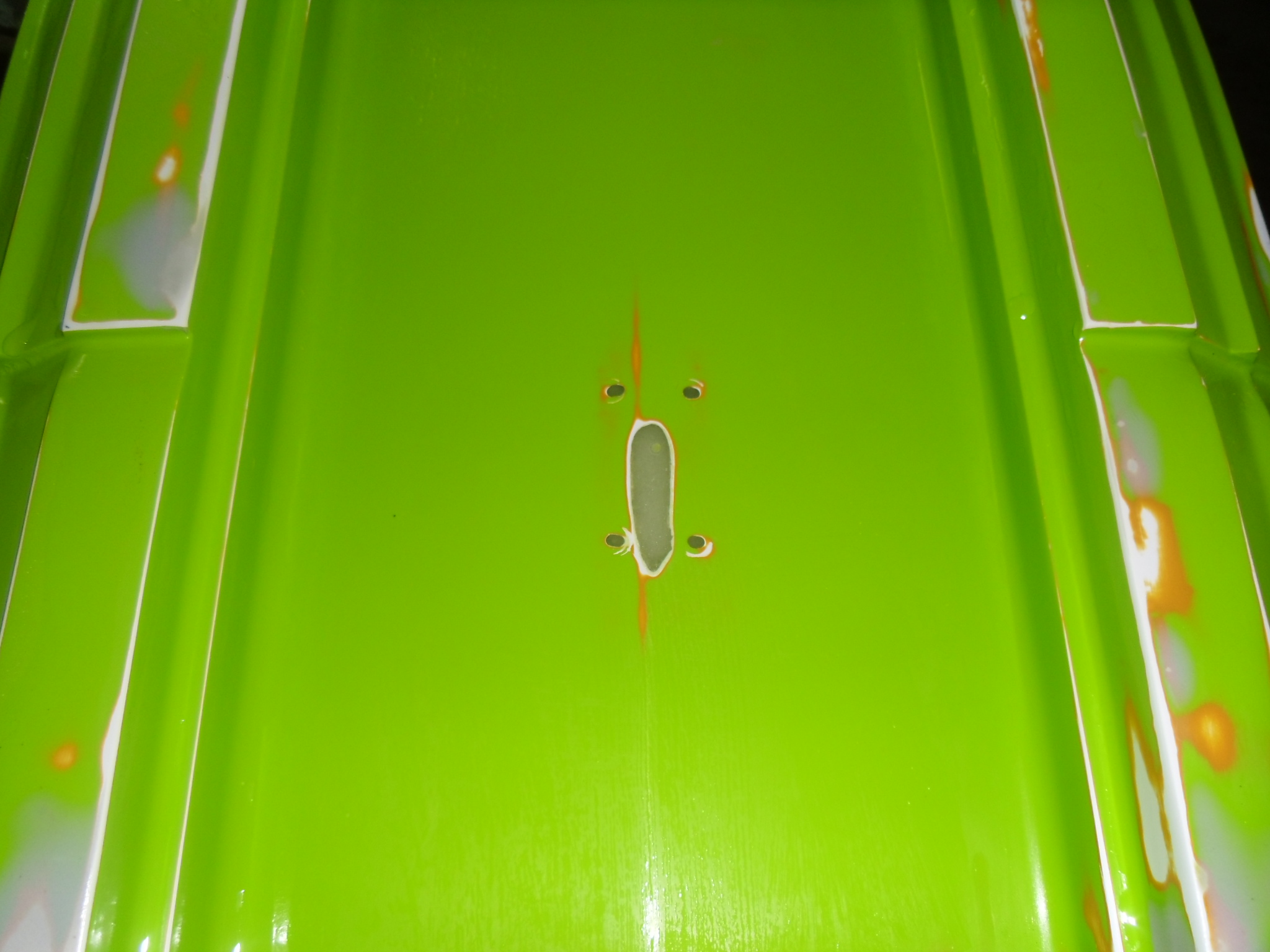

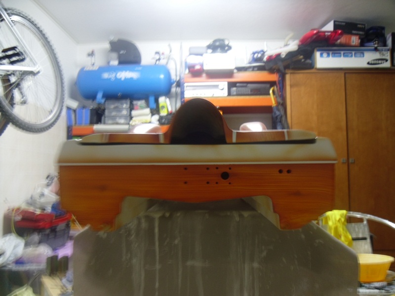

I buy this model from UK , used in bad shape until the autobailers and Drive where secure with silicone!!!!
Getting the work started by plugging all the holes in the wood, including the side opening for the carb side Zenoah (Now is an RZ254 RCMK).
Cover all holes made previously, including new for autobailers .
Openings on the front panel of wood, for floats.
In this model the air intake is short and requires far back the engine because the spark plug and let the correct center of gravity, the fiber was increased approximately 1.5cms in height and in length 3Cms.

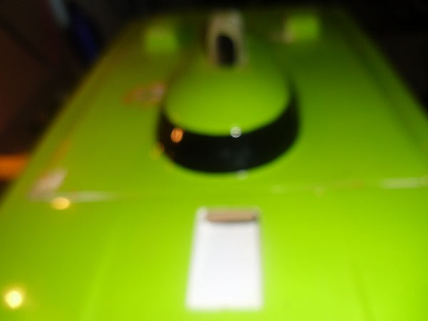

Placement of a Nasca front vents in order to cool the engine.
Regards

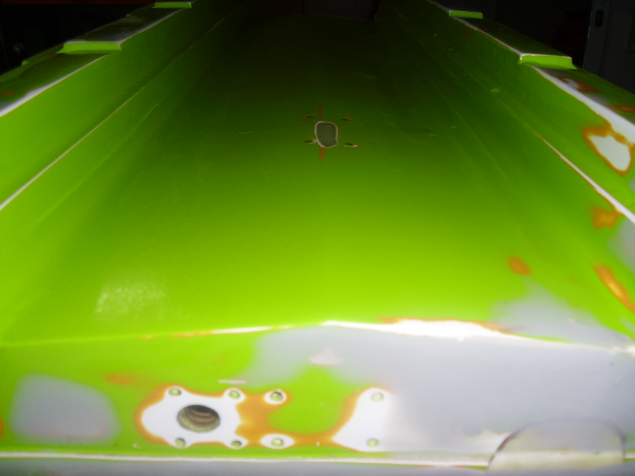

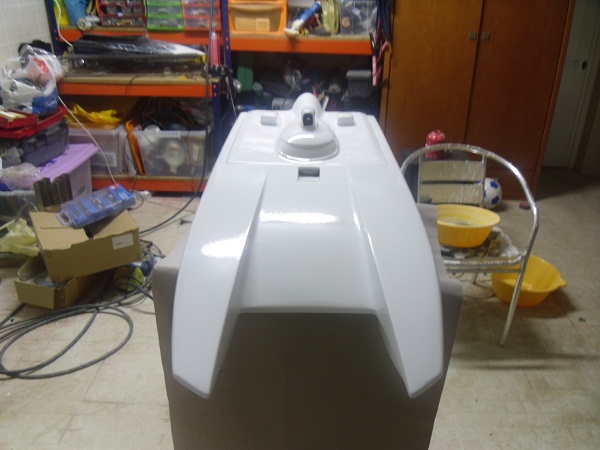

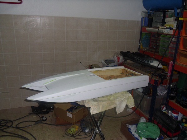

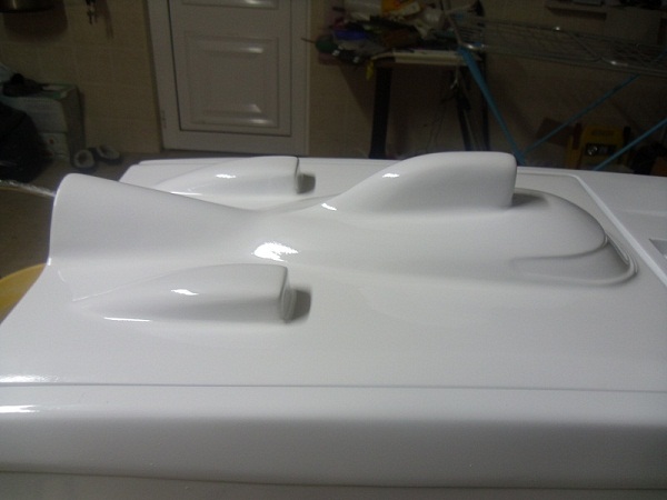

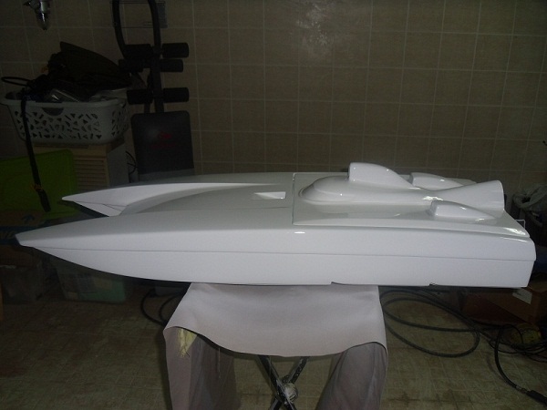

david36pt replied the topic: Re: Rebuilt Aeromarine Avenger pro
finish of the new cover of the pipe , putty and tomorow the first base and , color toprepare paint job.
I don t have the set up of this boat but in the opening of the hull to pass the tube of the driveline i found not in the center of the hull but few mms to the rigth side (hull up side down).
Can someone help me ???(Marc??)
Many thanks

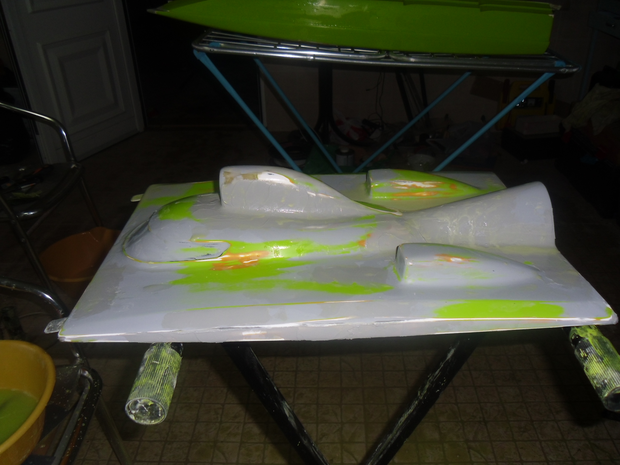

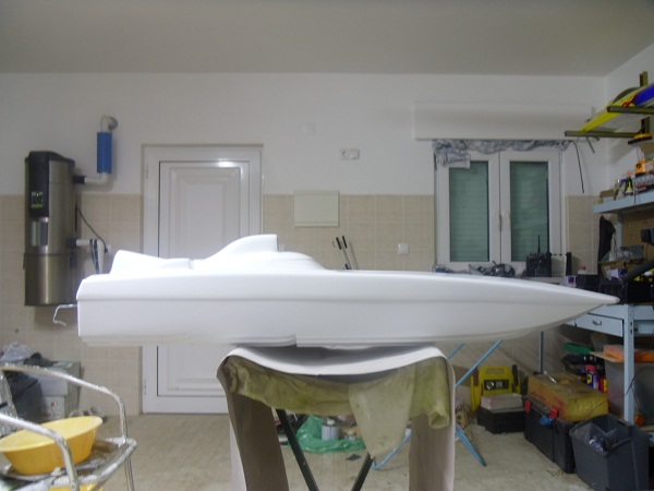

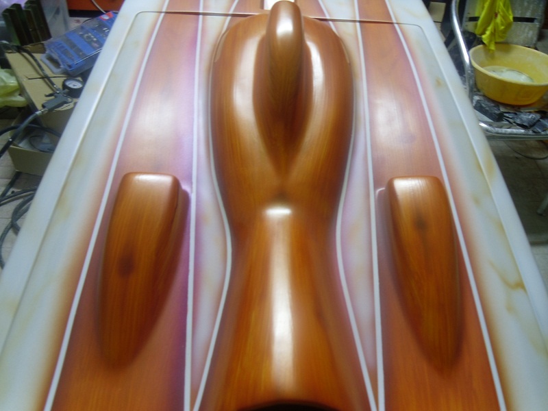

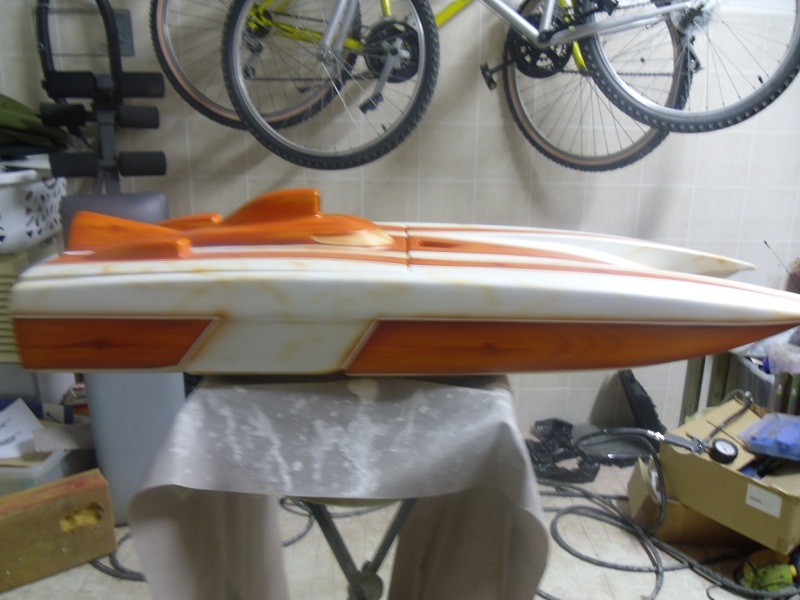

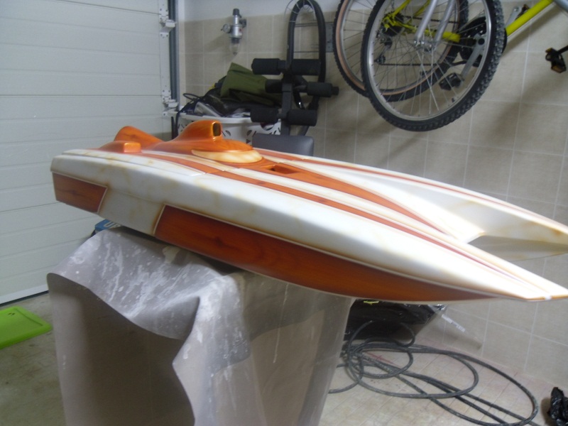

More Days....More hours working...Putty , base , putty...
#18691

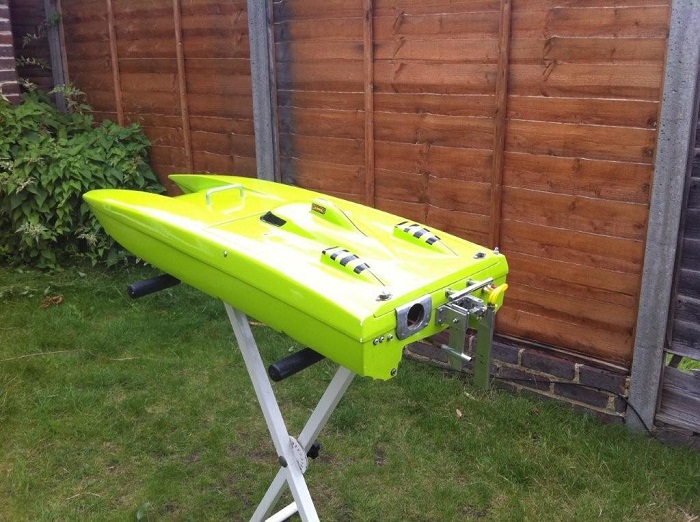

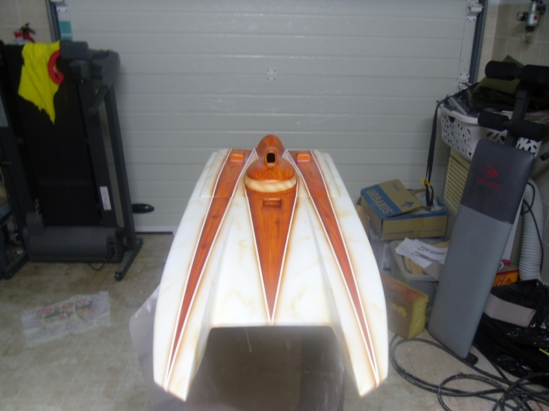

More hours ...more painting ..just need the finish
#18710
Rysquedases replied the topic: Re: Rebuilt Aeromarine Avenger pro
Is that paint made out of the finest wood because it would make venere jealous. Alot of talent with that air brush, wow.
VERY NICE
