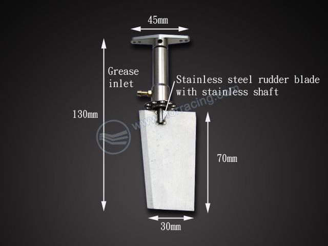

I know old school boat construction has the rudder behind the prop. so if i was going to use a dual prop would i need a dual rudder or just use a single centered rudder?
i posted a pic of the rudder i found below

whitefish replied the topic: Re: 1:3 scale garwood speedster wooden boat build!
On an R/C boat it is always more convenient to allow the flex
shaft(s) to be pulled without having to remove the rudder.
The rudder from HOR is a good choice. Once the rudder stuffing
box and support bracket is installed, it is easy to make any
other actual size of rudder blade your boat might prefer. A short
length of SS rod brazed to a piece of SS sheet is all the
rudder itself really is.
Which ever rudder you select, it's a good idea to keep a
complete spare rudder on hand. It just takes one unsuspecting
turtle or one of those submerged sticks (tree branch) to really
do a number on a hull mounted rudder.
Those brass rudders that come in three sizes with the plastic
stuffing box - forget 'em. They bend too easy to be used on
most gas boats. I tried them on my first R/C and have already
replicated them in SS.

smokeater2005 replied the topic: Re: 1:3 scale garwood speedster wooden boat build!

good point on having an extra fin. check...
Do you think that the rudder i uploaded a pic of would be enough to turn a 19" (at widest point) x 65"L twin prop wood rc boat?
#19966
Smokeater2005 wrote:
> Do you think the rudder I posted a pic of would be enough to turn
> a 19" (at widest point) X 65"L twin prop wood rc boat?
That's why I brought up the fact that you will be able to fit other
sizes of blades. The rudder from HOR is most commonly used in FSR-V
competition boats (usually much shorter than 65 in.). This rudder size
issue is one of the important design aspects that you will be testing
for. Stay with something to scale and I would start out with one of the
larger 1/4 scale servos for steering. Just big enough to do the job
with ease but also conserve battery power.
Yep, thats what i thought they used those rudders for. But, i still cant help seeing it on my scale woody. "pun intended"... Now with a bigger rudder will come more drag so my concern would be if the rudder body and mounting flanges can handle a biggie sized rudder? Even though it would not be optimal, would it be possible to run twin (stock) hor rudders with twin 1/4:servos (rud=servo=servo=rud) mechanicaly and electronicaly ganged... Inline with the twin prop design purposed? of course far enough aft the prop to make possible maintenance without rudder removal... my WAG on the props would be twin 3 blade 47mm-ish and play with pitch until proper speed/engine loading can be found...

Ian Webster replied the topic: Re: 1:3 scale garwood speedster wooden boat build!
The FSR-V rudders are generally well built and tough. There should be no problem with the body handling a larger rudder more the proper mounting of it. You can always bracket the top of the body to give extra support.
Using a rudder of the same size as the one shown my 27cc boat uses a Savox 1258TG.

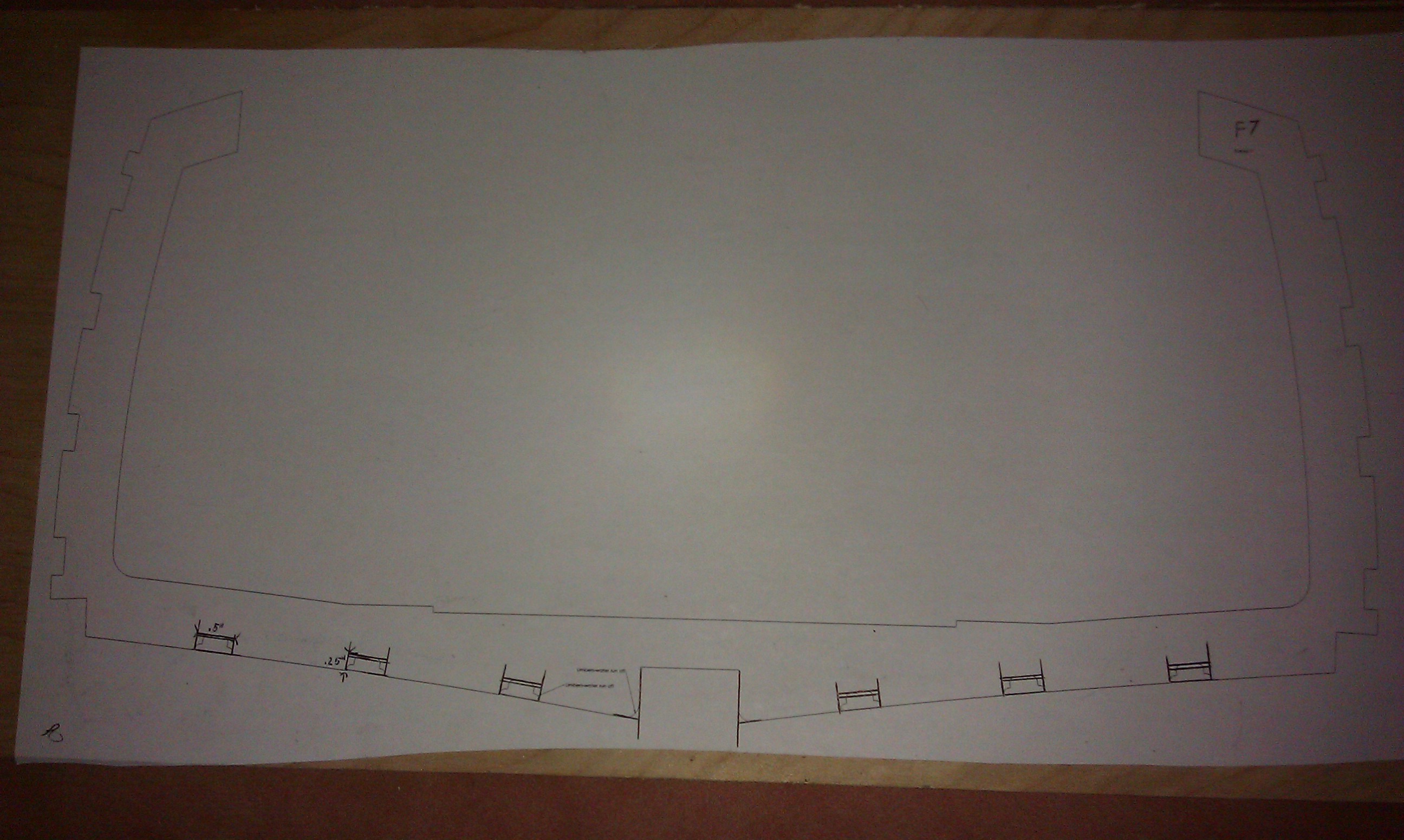

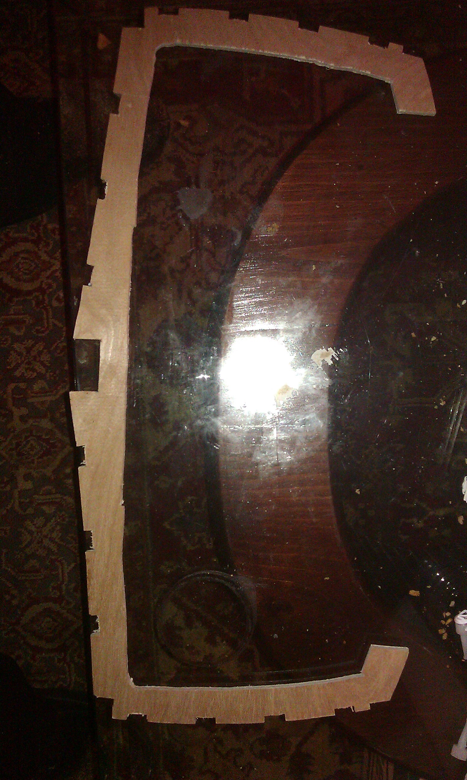

I got froggy today and cut out frame 7 "where the seating is near the back" it looks fairly nice now just to get started on all the other ones...LOL
