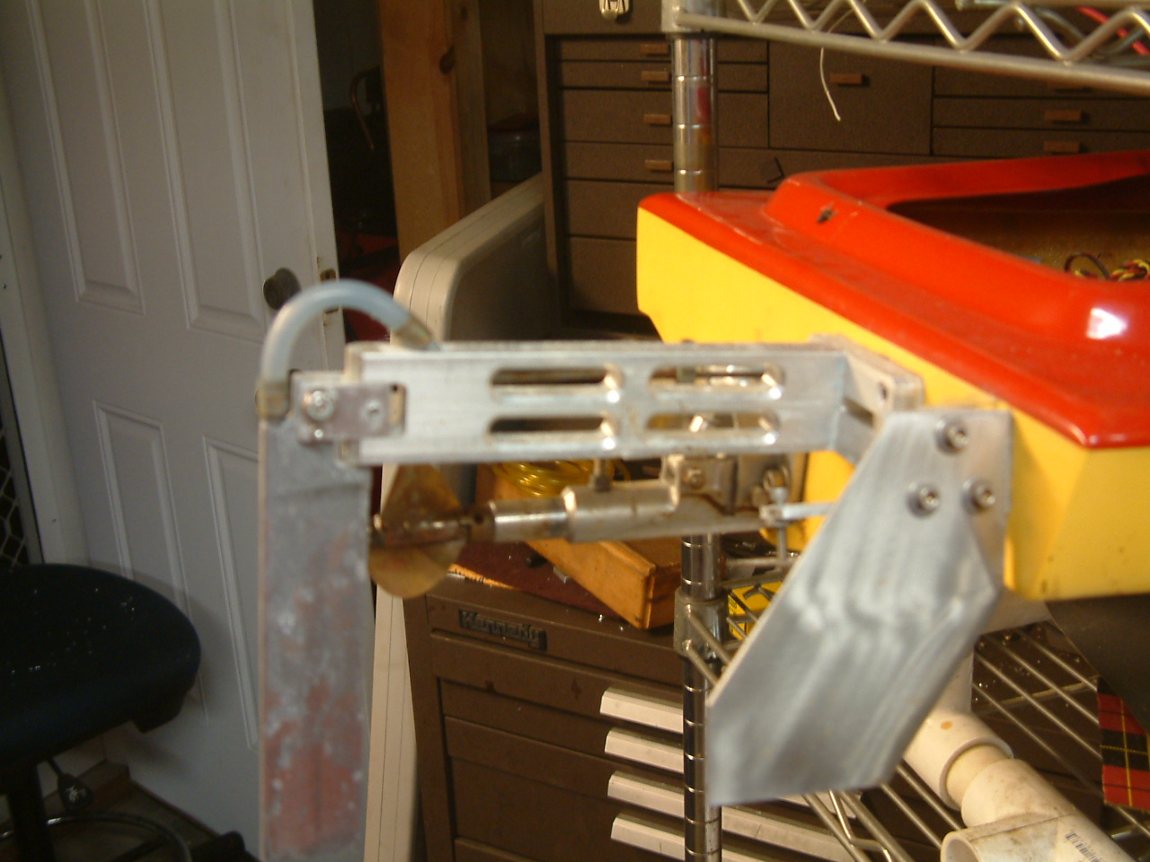

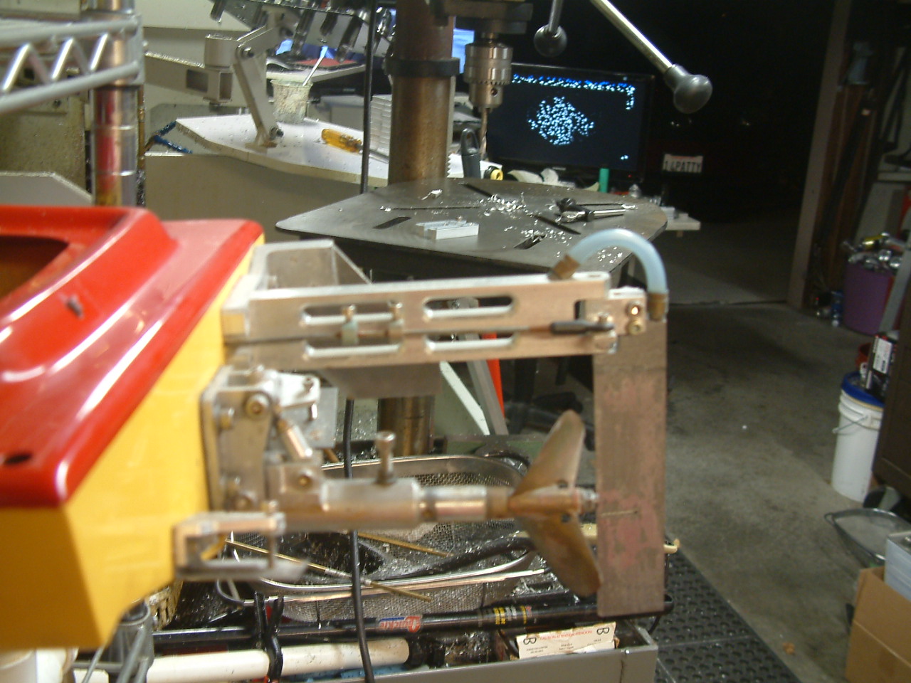

Steve Seebold replied the topic: Re: Rat Fink II Razor
Randy, here's an outdrive for your next build.
I finished a run of 48 units on Monday. 25 of them are already gone.
[attachment:1]C:\fakepath\GENERATION 3 OUTDRIVE.JPG[/attachment]

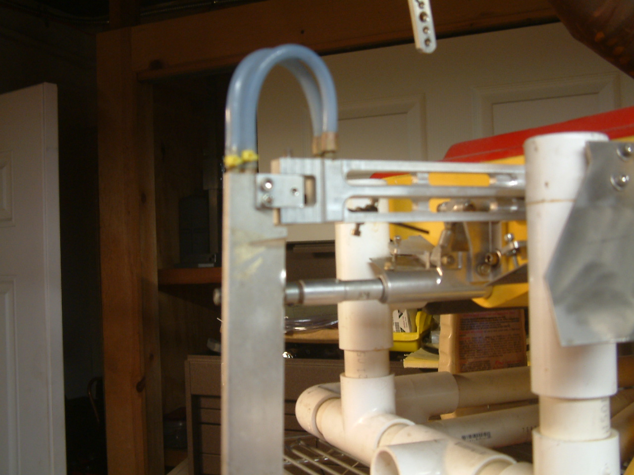

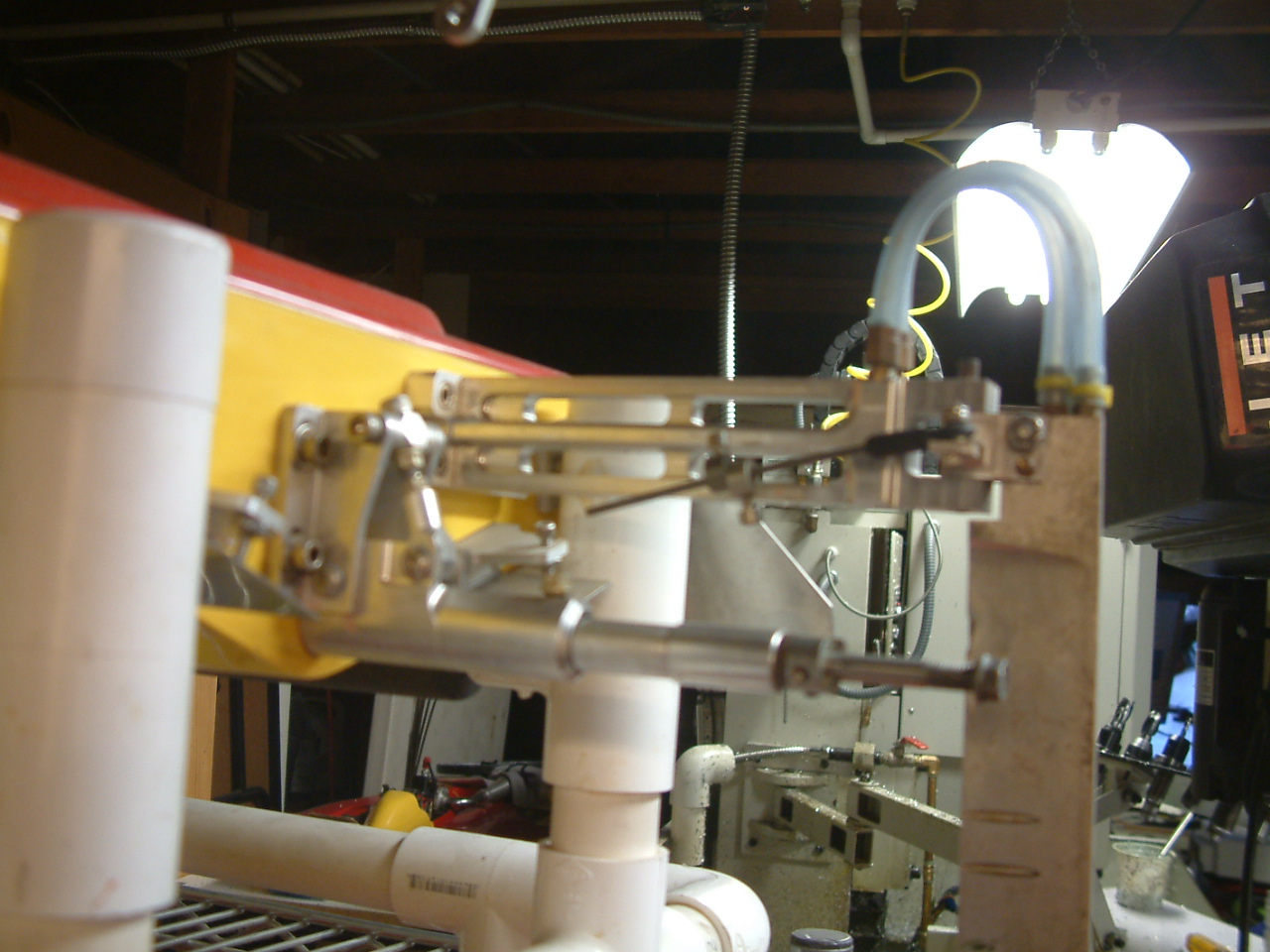

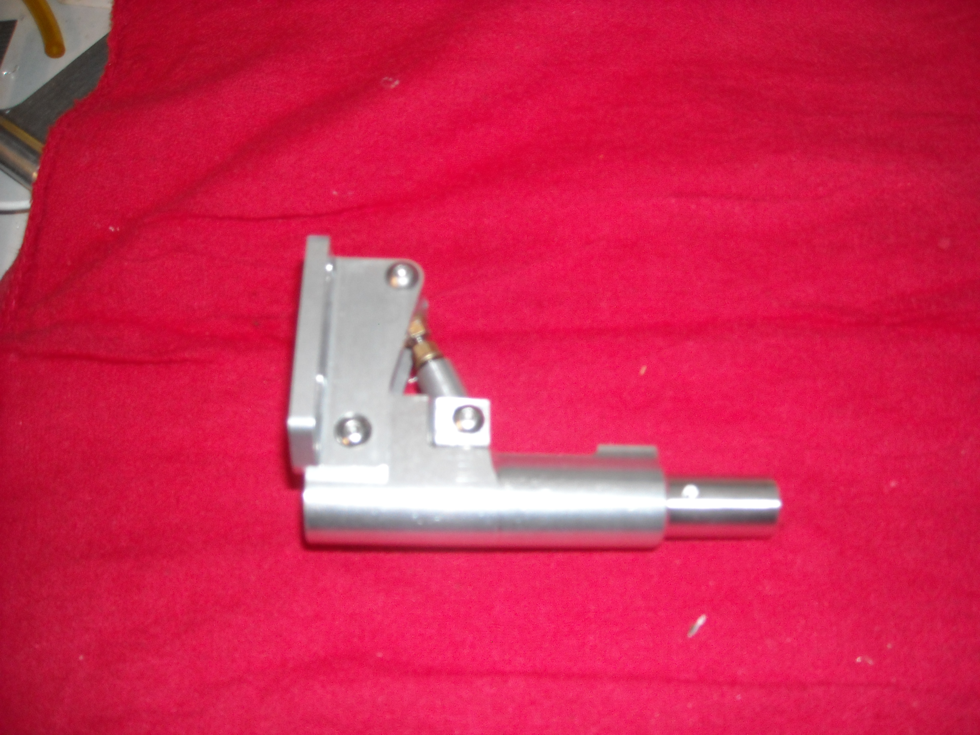

OK Randy, here's the single and the dual pick up brackets. Both with internal plumbing.
Singles will be ready in about a week, dual pick up 3 to 4 weeks out.
