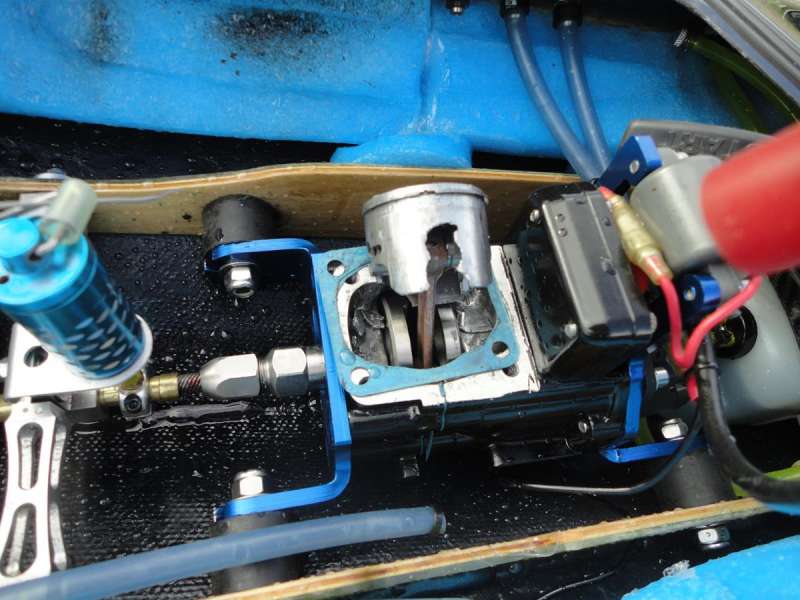

Carbs are a tricky thing on a Lz 40 - no real room to play - for me easier to pull engine to get carb than to try and pull carb
The first GZR in Lz #1 digested a butterfly after second run - a few months back (been off for medical) - so ya carbs and 40's ... :ohmy:

The shaft is a Ron Buck stainless "batwing" - all my carbs have them -- was no fault of shaft that butterfly came off. Was mine for being trustfull of Loctite instead of peening the screw
