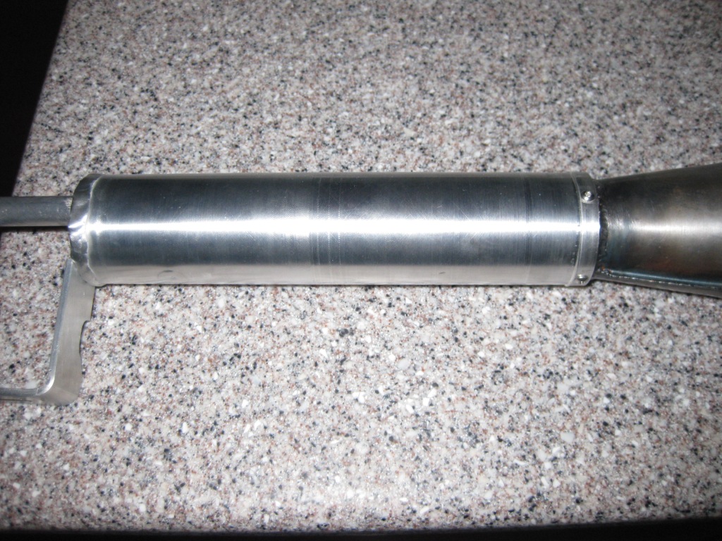

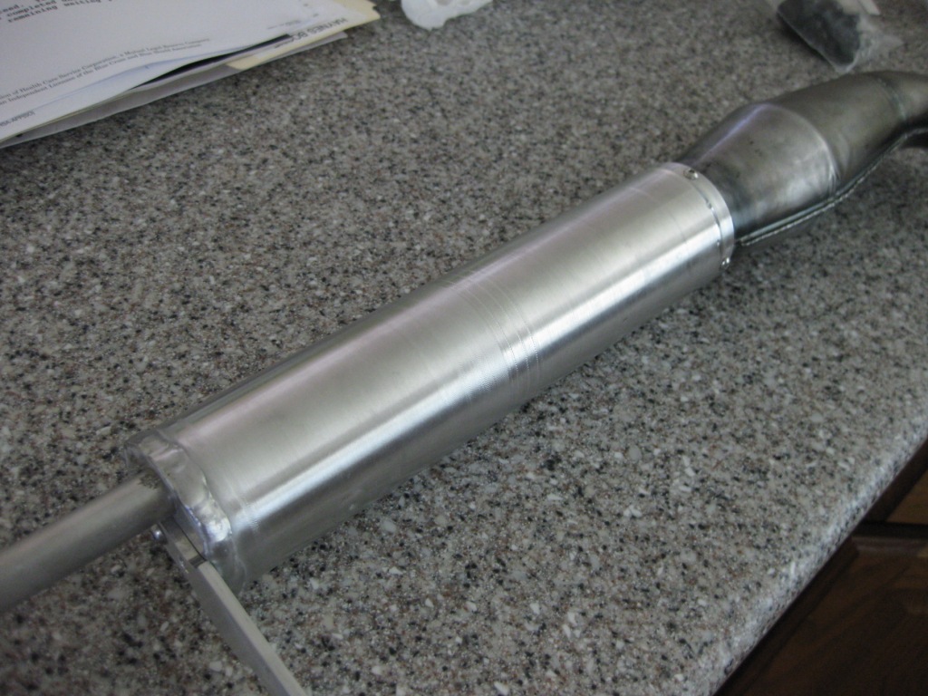

Thanks for the information on the muffler. I sent some pictures of mine by email, but I'm not sure they went through. Did you get them?
Thanks again. Boat should hit the water tomorrow or Wednesday and then a race this weekend.
Brent
#2962
QDRevenger replied the topic: Re:My Avenger
Brent,
I did get them on my work email today. Just had 5 days off. Looks good, I made some similar before, should work ok, might leak at the back plate though, I had an o ring at the front and rear of the main tube. I'll add a pic here tonight. Should be nice and quiet. Let me know how she goes. Did you mod the motor in the end or is she stock. I forgot to send you the info.

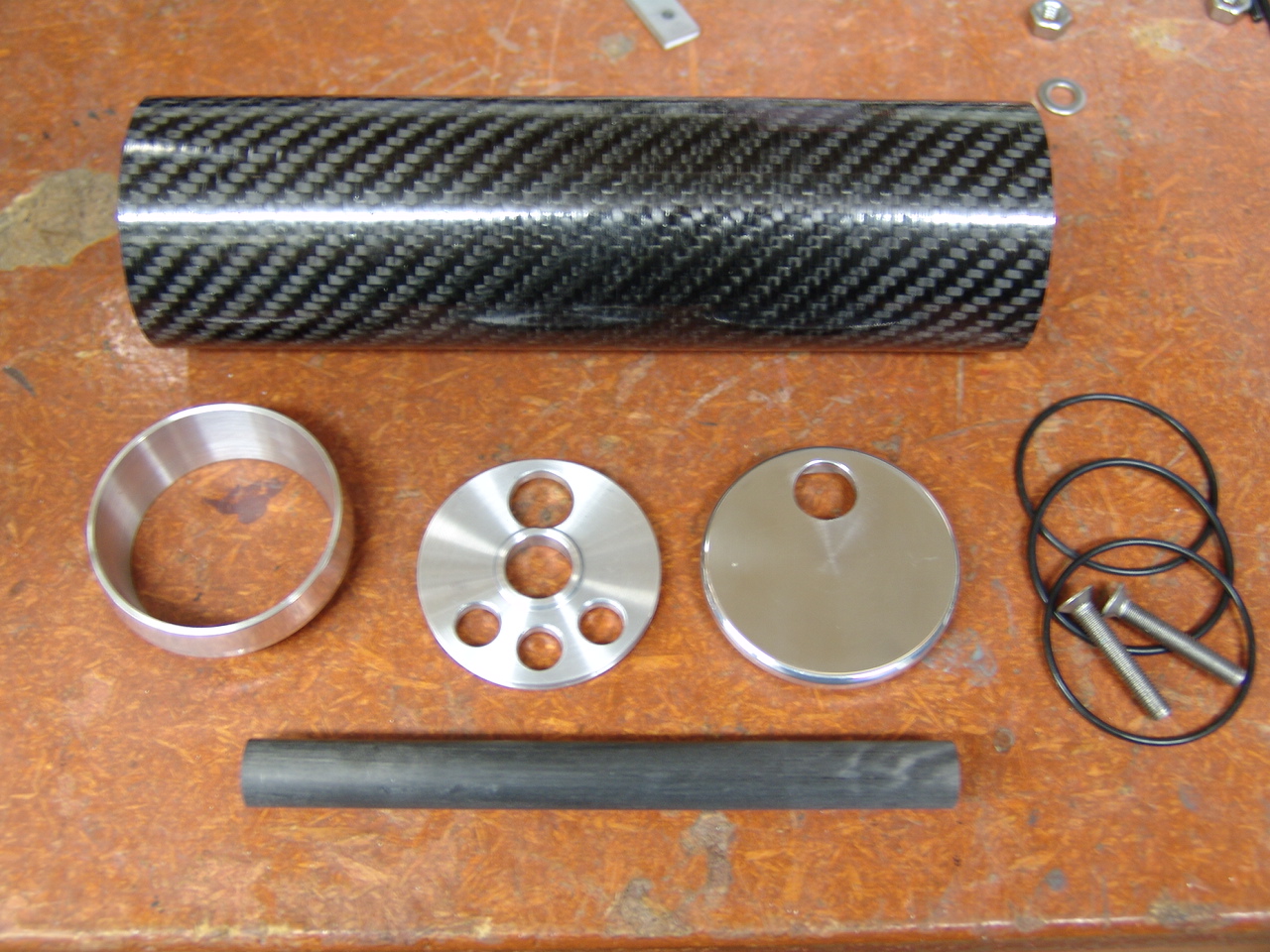

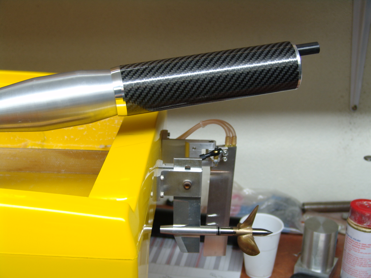

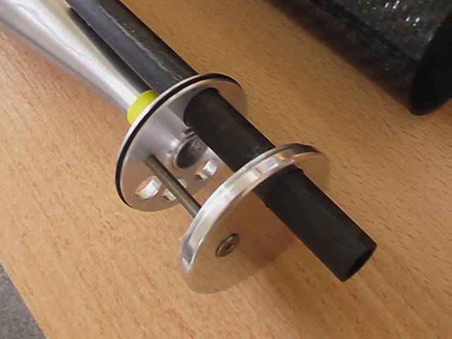

Here are some pics of the same style but with a carbon tube and Ali baffles and end plate.
#2967
marc replied the topic: Re:My Avenger
VERY nice muffler! How does it mount to the pipe and hold together?

Milner replied the topic: Re:My Avenger
QDRevenger wrote:
It would still be great to hear about the engine mods. I haven't buttoned it up yet.
That new pipe looks killer. I did put a smear of high temp RTV inside the front of the muffer where it mates with the steel ring and screws. The plate at the rear is welded to the body and the outlet tube is a pretty tight press fit into the end cap and baffle. I hope it doesn't leak, but it wouldn't surprise me if the outlet loosened up. I think the pipe and header will get ceramic coated after I test run and make sure I don't have any big problems.
Mark, A picture tells a thousand words. The pic of the parts were taken before I had drilled the bolt holes. The front ring is welded to the pipe, the baffle is welded to the stinger and the whole thing is bolted up with 'o' rings sealing everything up.
Brent, The only prob you may have is it loosening with vibration. Only a test will tell. There will be no power loss. Looks good, well done.
