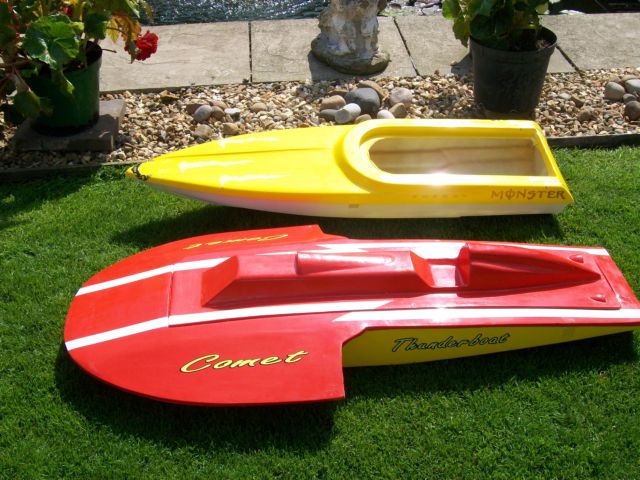

martno1fan replied the topic: Re:My "wildthing"
Nice project,heres a pic of my two these are both shoebox joins.You should glass the joint from inside for extra strength although that said i have used a pu adhesive before without any problems.The glassing of the seam just adds strength i case of a crash.Usually i glue the two halves together with a gelcoat bog mix then i glass the seam from inside.You can use a silcone sealant instead of the bog if you dont plan on painting but if you do then use a gelcoat bog or you can buy adhesives for the job at most glass suppliers.
