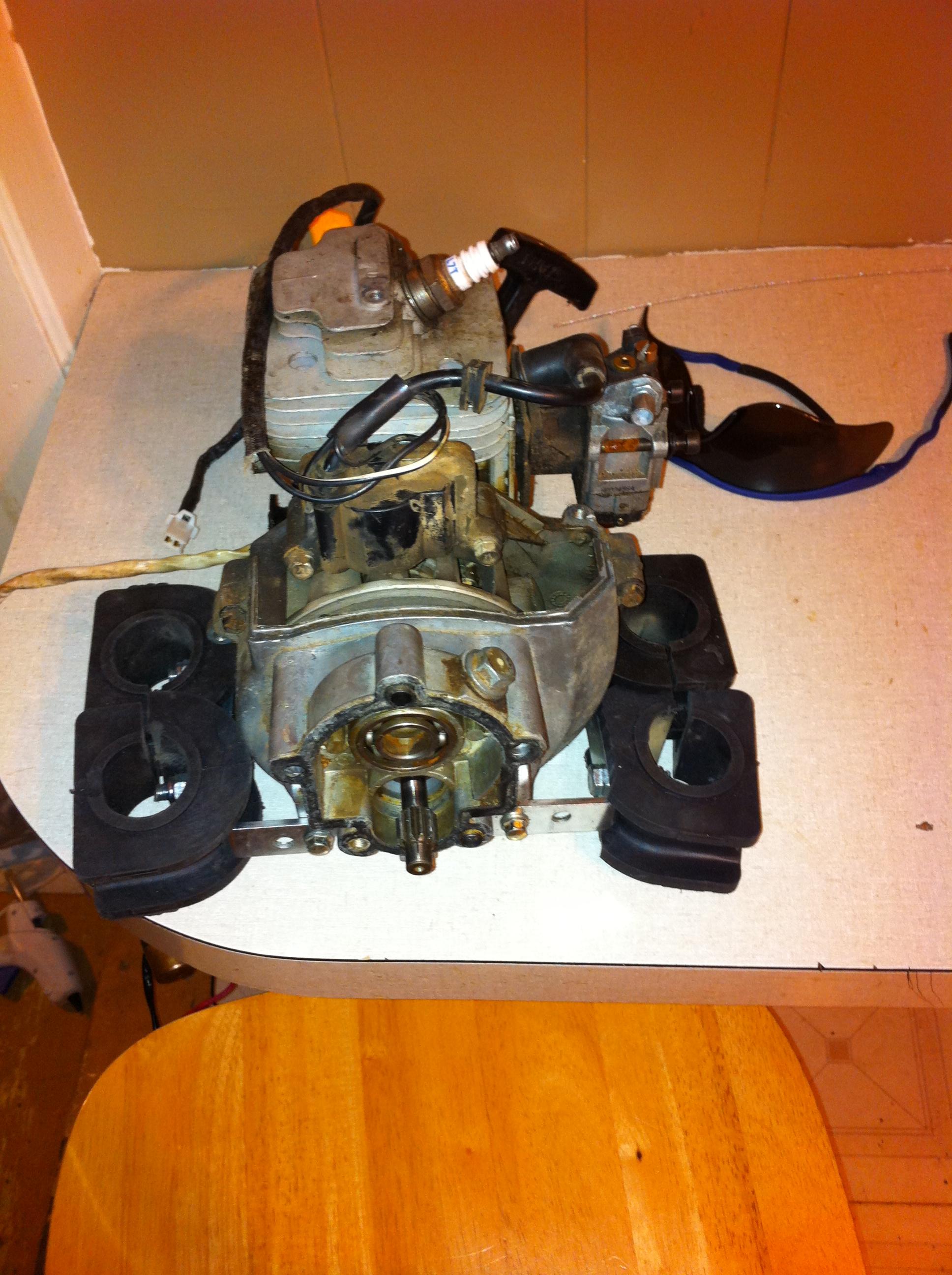

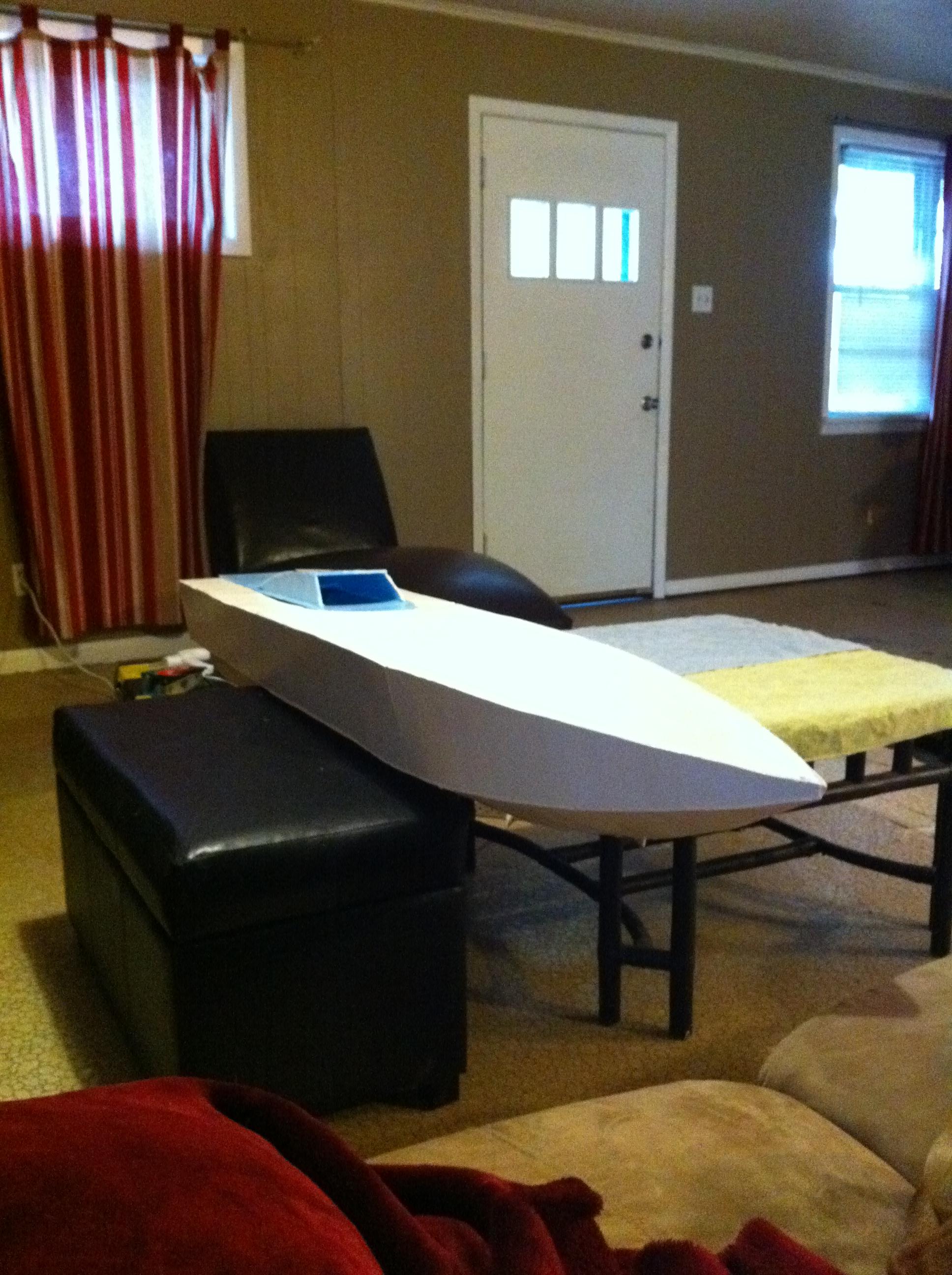

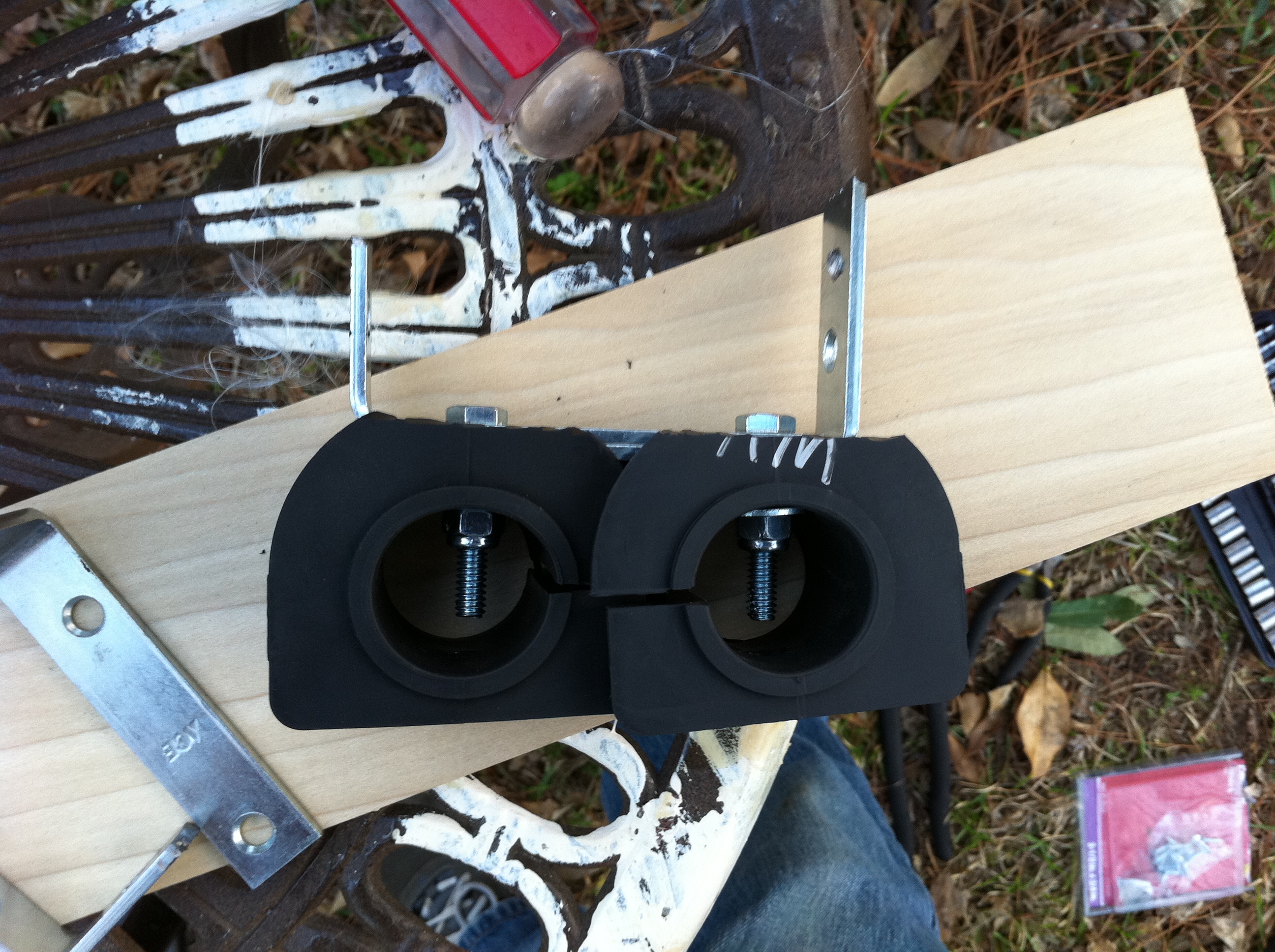

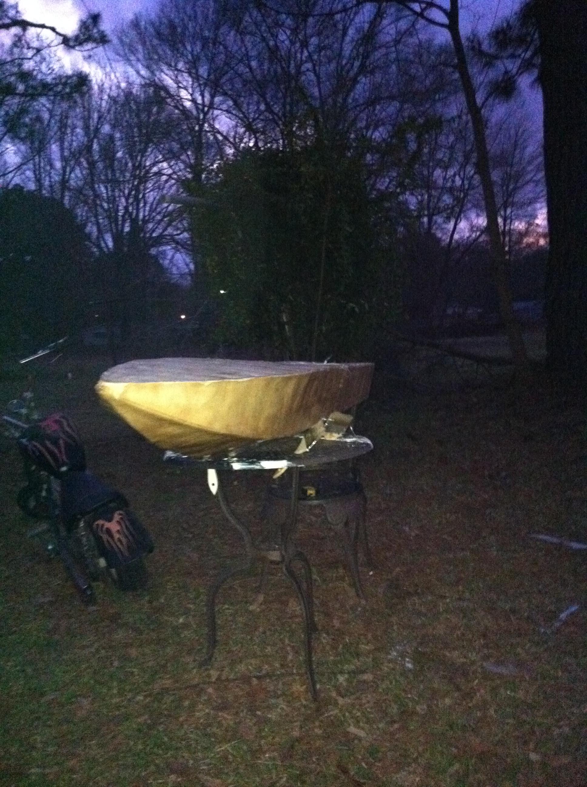

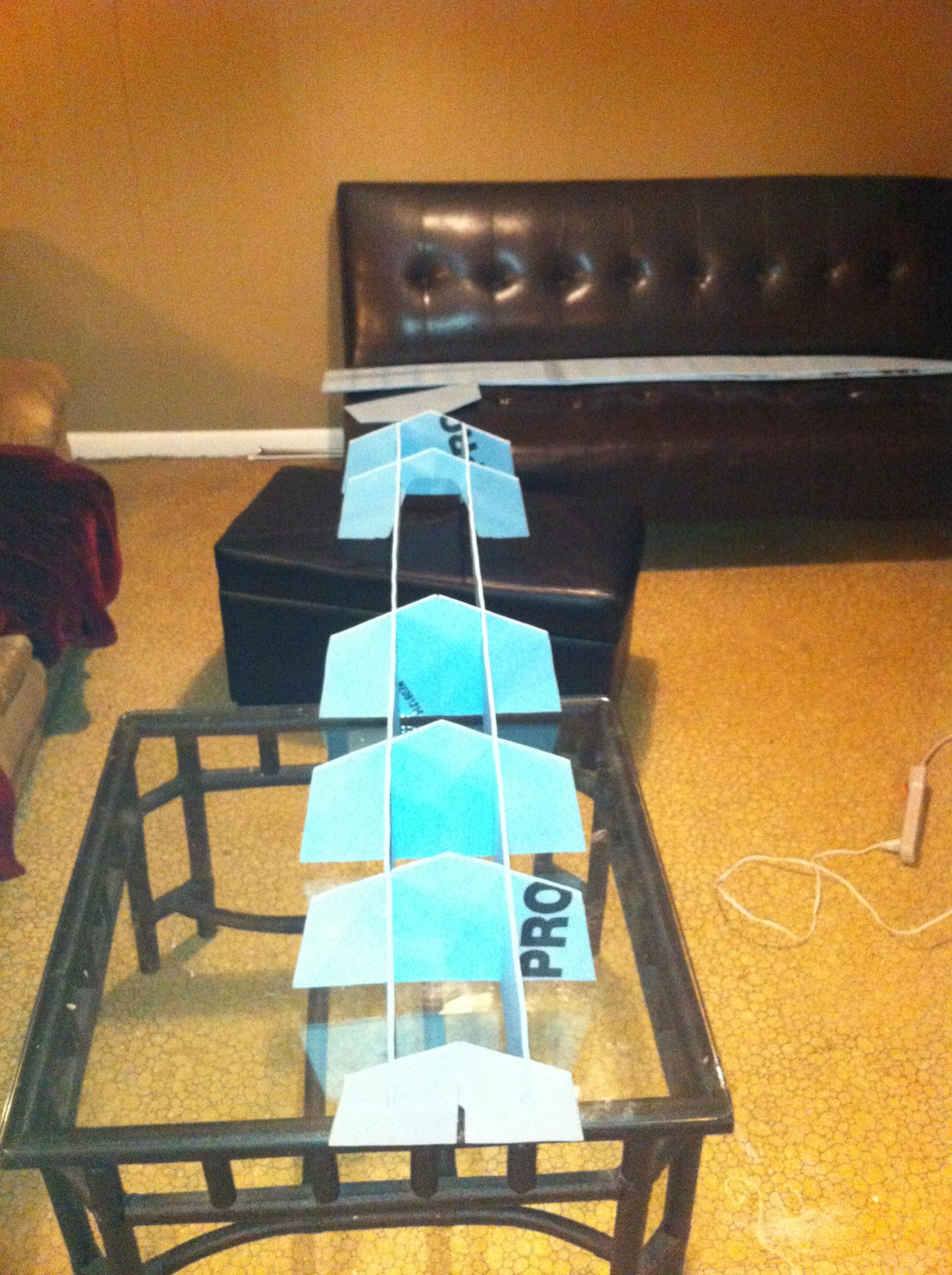

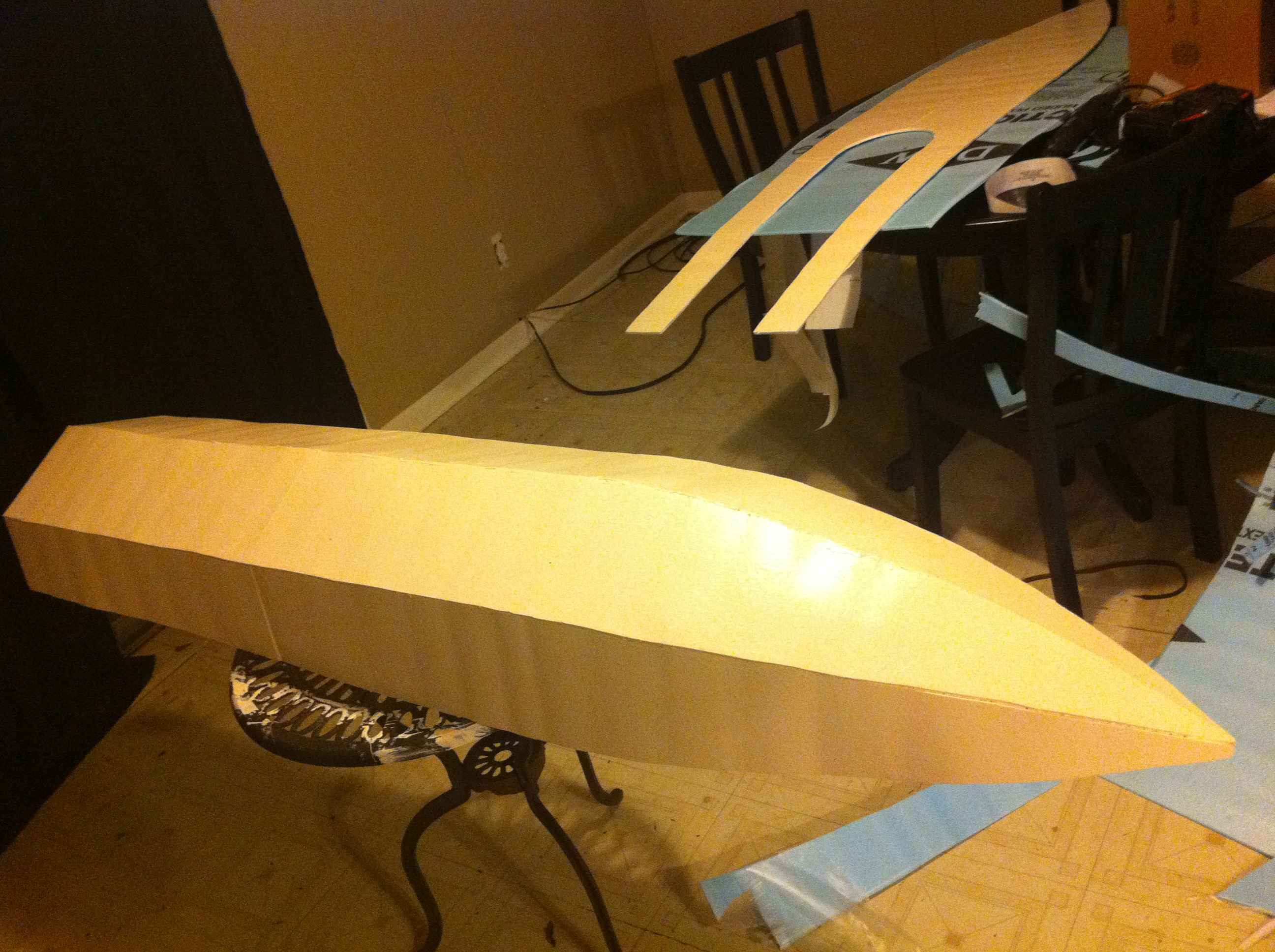

I started building a 72" vee about a week ago and have gotten a good bit finished already. I built the boat from foam first and then painted with latex paint to protect the foam from resin and then fiber glassed the hull. I will be powering it with a 49cc pocket bike engine. I have gotten most of the glassing done but have to sand it and smooth it all out still. Have the motor mounts made up and ready to mount the motor in. It's still really rough in the pictures as I still have a lot of work to do and Im learning as I go. I will post a few pics of progress.

I finished mounting the engine and hooking up all the drive line last night. Now I just have to put the radio stuff in, mount the fuel tank, and finish the exhaust. Hoping to give it a test run this weekend. I need to figure out if there is some kind of epoxy that I can use on the exhaust though because I dont have a welder and im trying to fab something up.
