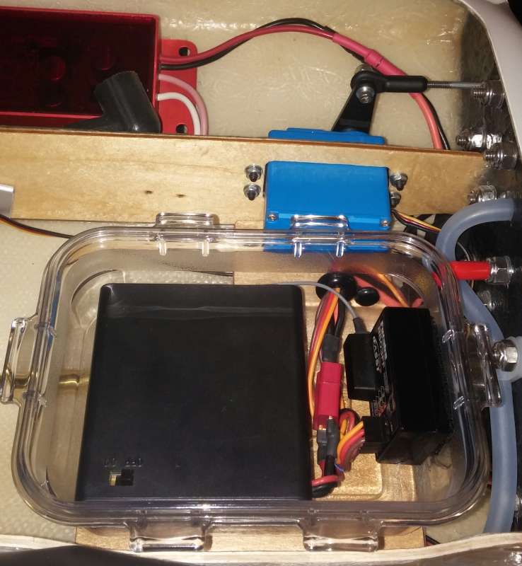

You should be happy, that looks great! I like the rudder servo mounted into the rail like that, and the flat black highlights are a nice touch. What type of battery is that in there, is that a charging jack for it on the lower right hand side?
#23215
SRI Motorsports replied the topic: 45" Mono Revival
I appreciate the kind words. The radio box is now setup differently then the pic shown. That was only a mockup. Give me roughly 30 min and I will get a current picture. The pack comes out of the box and has a slide off backing plate that covers 4 lithium AA batteries. That lead you see is for the RX and the deans connector is for my power spark ign module. Batteries can be changed in 5min or less. The pack has a built in switch to turn it off, the switch also turns off the ign. A custom harness was made for the ign.
