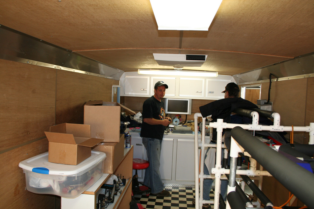

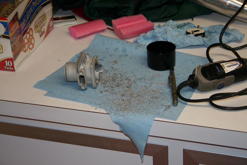

Carlo took the cylinder in his trailer to start working on it and invited me to watch. What I got to witness was nothing short of amazing! I'd heard of some guys getting out the Dremel and modifying motors on the fly, but I had never seen it before, and honestly, I doubt many of them would have turn out this good, especially considering the tools he had to work with. I kid not, Carlo did the entire porting with only one cutter, since that is all that was available at the time being and it wasn't even the right one! It was a coarse cutter that really removes a lot of material in a hurry, so a VERY steady hand is a must to get any kind of decent port work done.
Anyway, after about 30 minutes in the trailer and a whole lot of aluminum shavings later, the cylinder was ready. I wish I had taken pictures of the inside of this cylinder to show here, but I can honestly tell you that it was almost an insult to a guy like myself who likes to do a lot of motor work himself! In less than 1/4 of the time that I would take to prepare a cylinder Carlo had done a much cleaner job AND with a cutter that most people wouldn't even consider using for this kind of work. I was amazed!
