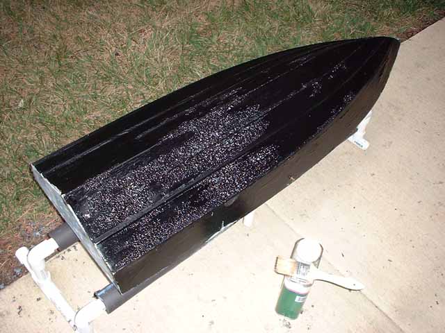

I initially tried to sand off the old paint but after 30 minutes of elbow grease and sweat to barely sand any paint off I decided to pursue better living through chemistry. After and exhaustive Internet search I found a few products that supposedly stripped paint from fiberglass without harming the gel coat. One was an automotive product but you had to invest $40 for 1 gallon of product (remember this is on a budget). I was able to find Interlux: Interstrip 299E at a local Boater's World for $14.99 per quart. After removing the grab rails I was ready TO STRIP
I used a brush to spread the Interstrip liberally on the hull and waited 10-15 minutes later the top layer of paint bubbled up nicely and I took a scraper to it. It took a 2-3 applications to get through all the paint and primer.

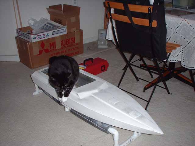

I took this opportunity to repair the section removed from the transom and all the previous mounting holes.
The quality control cat gave it the once over and a stamp of approval. I ordered a radar bar from Dumas at a cost of $20.
